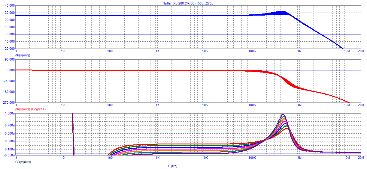

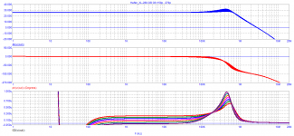

some of this discussion brings about a potentially interesting question.
does anybody have an XL-280 and 220C to perform the SWDT and compare results?
With all due respect to David Hafler, I agree with a number of Mr. Nelson's remarks.
The fact is that speed distortions are more dependent on Group Delay and its behavior far beyond the audio band, up to 1 MHz and beyond. It is not enough to reduce the time Propagation Delay to almost zero in the audio range, it is important to keep this level further. But with this in the XL-280 amplifier there are big problems. See Attached Files.
For those who do not understand basic things in electronics, please ignore my posts and do not flood like

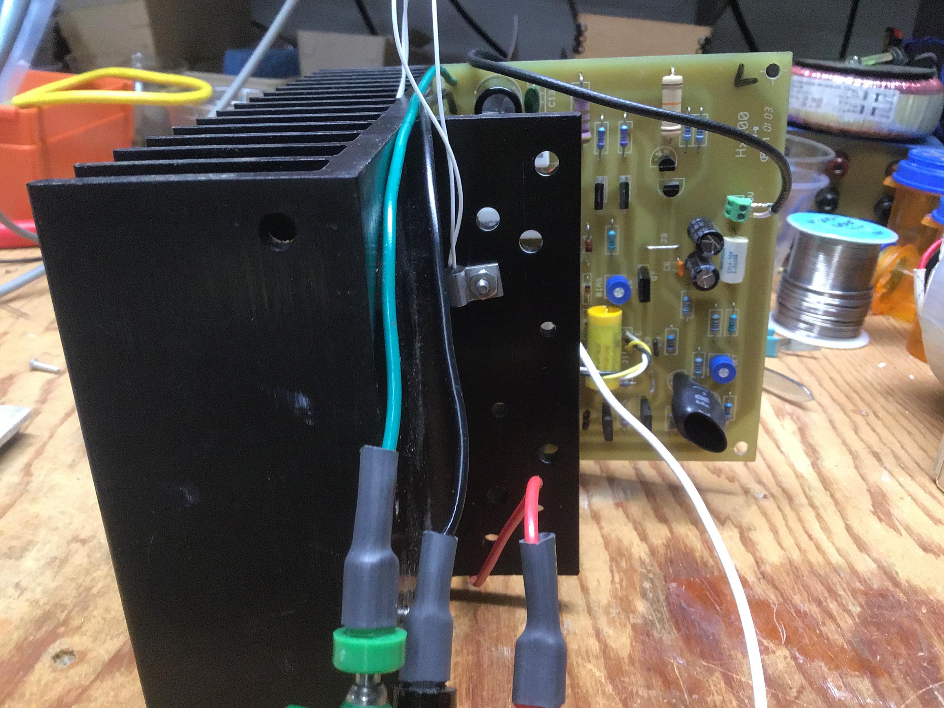

After reading woody, HaflerDH500Fan, and Bob Cordell’s comments on the thermal resistance of the DH-200 heatsink, I thought I would add some empirical data.
I have mounted a MOSFET amplifier to the heatsinks from a scrapped Hafler DH-200 amplifier. The output stage of these amplifiers consist of a pair of IRFP240 and IRFP9240 FETs with 0.22 ohm source resistors. The FETs were biased at about 100 mA each. The rail voltage was ±68 volts. The amplifier was operated with shorted input, and a 4-ohm load. I mounted an Omega surface mount thermistor feeding an Omega meter to measure heatsink temperature.
The heatsink temperature was 17.2ºC prior to power-up. The heatsink temperature equilibrated out at 34.0ºC after about 60 minutes. I re-measured the bias for each FET, they varied between 97.7 and 107.7mA. The dissipation for the four FETs varied between 6.55 – 7.22W. The dissipation summed to 27.43W. if I did the math right, this will calculate out to a thermal resistance of 0.61ºC/W.
I suspect it may make a difference as to were on the heatsink the measurement is taken, but I am unaware of a standard, so I just used one of the available holes, see attached photo.

Interesting measurements. The 0.61 °C/W thermal resistance would be about the minimum required to support the Hafler DH220 listed power output of 115 watts into 8 ohm based on the assumptions listed in my previous note: (60°C-25°C)/(0.5*115 watts) = 0.61 °C/W.
I really love it when two different approaches to solving a problem come up with the same answer. Kind of renews one’s faith in science.

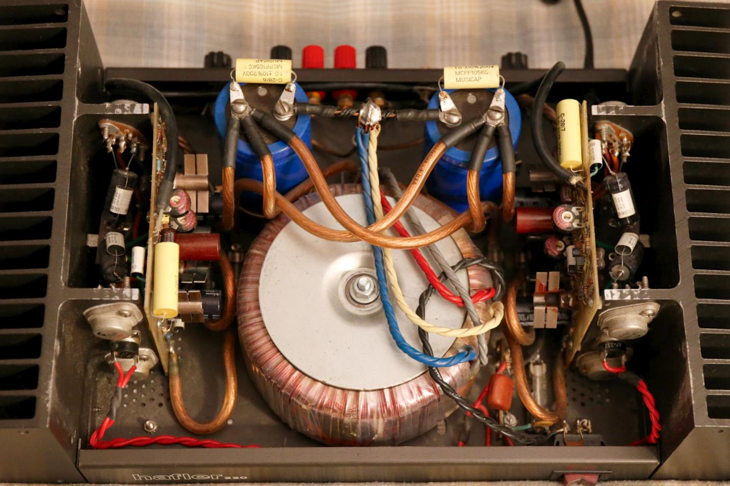

I've always matched these transistors in these amps. Makes a massive difference. I designed a BJT matching jig that does a pair at a time. It is the only way to match pairs as they must be kept at the exact same temperature.
Your replacement caps on the PCB are too large. The wire is ridiculous.

**I built this amp as shown, 35-40 years ago. IT ..WAS RIDICULOUS.., FOR THE TIME (compared to) sitting next to my buddies mighty Levinson ML-3 driving my Maggies... I also used it on my Quad ESL-63, sitting next to Futterman OTL3 amps... RIDICULOUSLY GOOD SOUNDING!!!
This amp (as shown) was my daily driver, even next to numerous VENERABLE vacuum tube amps... of the day.

I had to live through the silly wire phase as well. Monster was king. I saw all kinds of destroyed gear where folks ripped out factory wire and caps, installing replacements too large to fit.
Honestly, smaller gage wire would perform exactly as good - and it fit the terminals! Your losses were not great with factory skinny wire, and slightly larger would eliminate all slight problems. But no, massive wire was the rule and the fad.
Many designers used their heads and used wire and capacitors that were the correct size. They were largely ignored because the magazine articles focused on the extreme. This was before the internet and before bulletin boards.
Upgrade artists were about the worst of the lot, being 100% fad driven without any logic to guide them. We have the same issues today of course.
Do I have an issue with this? Yup, I sure do. But I have no personal issues with you at all. What I do have issues with is destroyed equipment or stuff that performs at a substandard level after the great expensive work is done.

While it is intuitive to many, fat power supply wires are neither necessary nor highly effective in improving performance. In fact, in the right setting, they may not be as good.
I do believe in larger reservoir capacitors to the extant that they can fit. These days, you can get capacitors with 3X the capacitance of the old computerlytics used in the Hafler in the same space. 30,000 uf per rail is a good number. This is often realized on a small board that will fit in the space occupied by the old capacitors. Often it will consist of 3 X 10,000 uF on each rail. Net ESR and ESL tend to be quite a bit lower with such an arrangement. Some such power supply boards, including nice rectifiers, can be found on eBay for on the order of $50.
I believe just as importantly that one should have 1000 uF or so rail caps on the output board right at the power transistors. This is the approach taken in the DH-220C.
Finally, with the above approach, smaller AWG power supply wire can actually make things better, since its modestly small resistance allows the reservoir and board capacitors to act as a bit of a pi network.

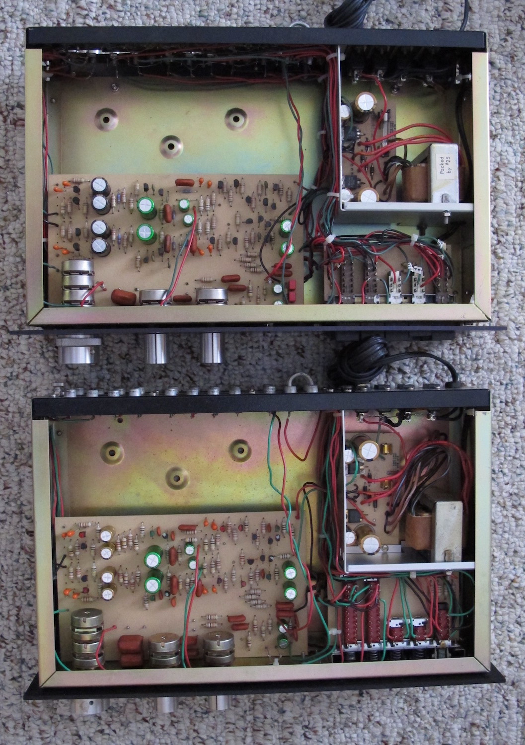

If it makes y'all feel better... A picture
(of a starting point, PS build)
of a stock'ish rebuild for a buddy,
which I made 2 years ago.

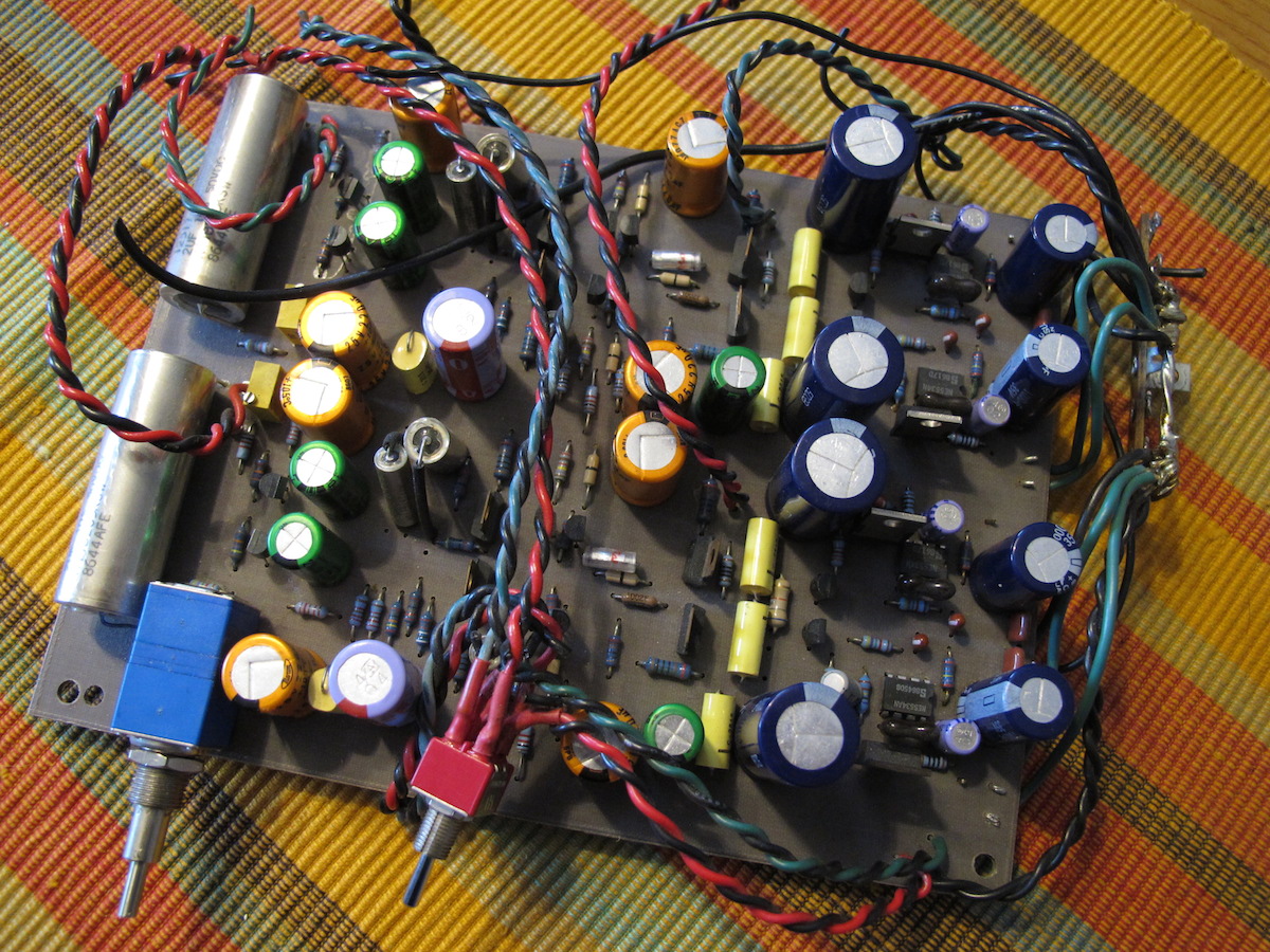

I rebuilt a Hafler DH101 with Teflon PCBs
Hi Chris,
Why teflon? At the time I was designing pcb's at HP, Cyanate Ester Resin (HT-2) was the premium dielectric. HP had two pcb fabs, PRCO in Loveland, CO and Boeblingen, DE. HT-2 was co-developed with Nelco. That was in the mid 90's. We never needed to use HT-2 in our designs but they were not RF or high power designs. I have used FR-4 into the GHz ranges on 10Gbit/s SerDes links. Like I said makes no sense to me 🙂 iirc teflon had it's inherent problems with de-lam ??

Hi Guys,
I wasn't clear I guess.
The DH-101 I worked on was modified by John in this case, and he used a Teflon PCB. It was a mess and the output buffers had been removed, the other transistors run at very high bias current. All I could do was change the transistor package and add heat sinks to dissipate the heat while reducing the standing current somewhat. I added better regulation for the power supplies. The performance did improve considerably. Best of all, the preamp now didn't blow up anymore.
The Teflon PCB looked like it was designed for something different. The two external power supplies could have powered a small stereo amplifier each. It was a real PITA for the customer, so he was very happy to have but one external supply. Stereo separation was actually improved going to one supply, improving the regulators and taking care with grounds.
Factory DH-101 preamps performed better than this unit as received. So the money the customer spent upgrading this product was a total loss and resulted in something without any resale value.
This is exactly the kind of thing I have a massive problem with. When you accept money from another person to improve the performance of a piece of equipment, you should darn well do as you claim to. I feel it is irresponsible to charge a lot of money without any real proof of an improvement in performance. A bunch of people sitting around patting each other on the back doesn't count.
