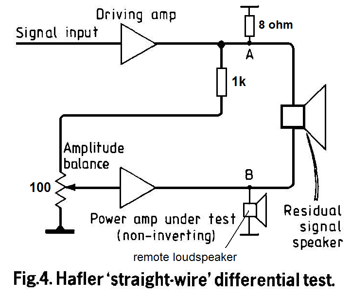

Hi petr,
Are all of these graphs from simulation, or have you build and measured the DH-220C?
What is your criteria for an amplifier failing the Hafler SWDT (straight wire with gain)?
What is "speed distortion" and how did you measure it?
Bob

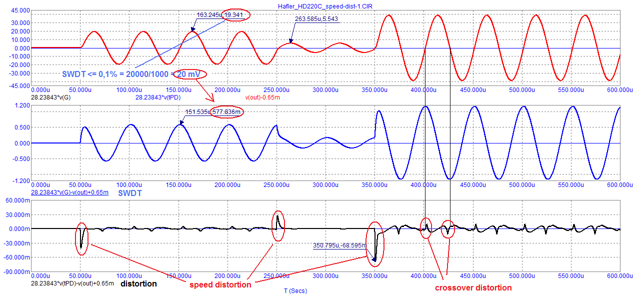

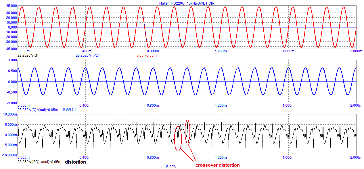

Hi, Bob!
Graphs obtained by simulation using your transistor models Hafler's SWDT test measures vector errors (for more details, see the book I got "Operational Amplifiers by Jiri Dostal"
According to David Hafler's ideas, for the absence of noticeable distortions, the difference signal between the scaled input signal and the output signal should be no more than -70 dB (0.01%).
To fulfill this condition, the signal propagation delay must be negligible. The amplitude of the difference signal (vector errors) is calculated using the formula I got it:
a = 2πA * tPD / T
where
a - the amplitude of the differential signal (vector error)
T - is the signal period, μs;
A - signal amplitude at the outputs of the amplifiers, V
tPD – time Propagation Delay (Group Delay), μs
From this formula, you can calculate the required propagation delay tPD for the SWDT test condition. For higher frequencies of the audio range, the delay is several ns, but not hundreds.

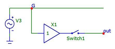

Speed distortions occur at any deviation of the signal from the sinusoidal one. On a purely sinusoidal signal in the steady state, speed distortion does not appear. And although Hafler introduced the signal propagation delay adjustment to the XL-280 amplifier and it can be set to almost zero or even negative value for a specific frequency, nevertheless, his amplifier actually has high speed distortions that are easily detected using a triangular signal (using any signal other than a sinusoid: rectangular, 1/3 octave noise).
Speed distortion is detected by subtracting the output from the scaled input time delayed tPD.
Hi Petr,
IIRC, Haflers test was basically a subtraction of scaled output from input; basically the scaling was adjusted for a null. A headphone was used to listen to the resulting difference signal, with one wire connected to the input and the other wire connected to the scaled output. The idea was to literally listen to the distortion, not measure the difference with an instrument. The key is that phase differences caused by signal propagation through the amplifier only impair the subtraction at very low and very high inaudible frequencies. A phase difference causes a non-zero difference, but a phase difference is not nonlinear distortion. Any amplifier with a finite bandwidth will show a difference with this test.
It also appears that the speed test is a test that normally yields a waveform distortion only due to phase differences, even if there is no nonlinear distortion. Mere propagation delay through the amplifier is of no consequence and cannot be heard.
Bob

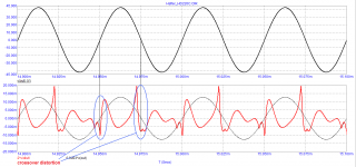

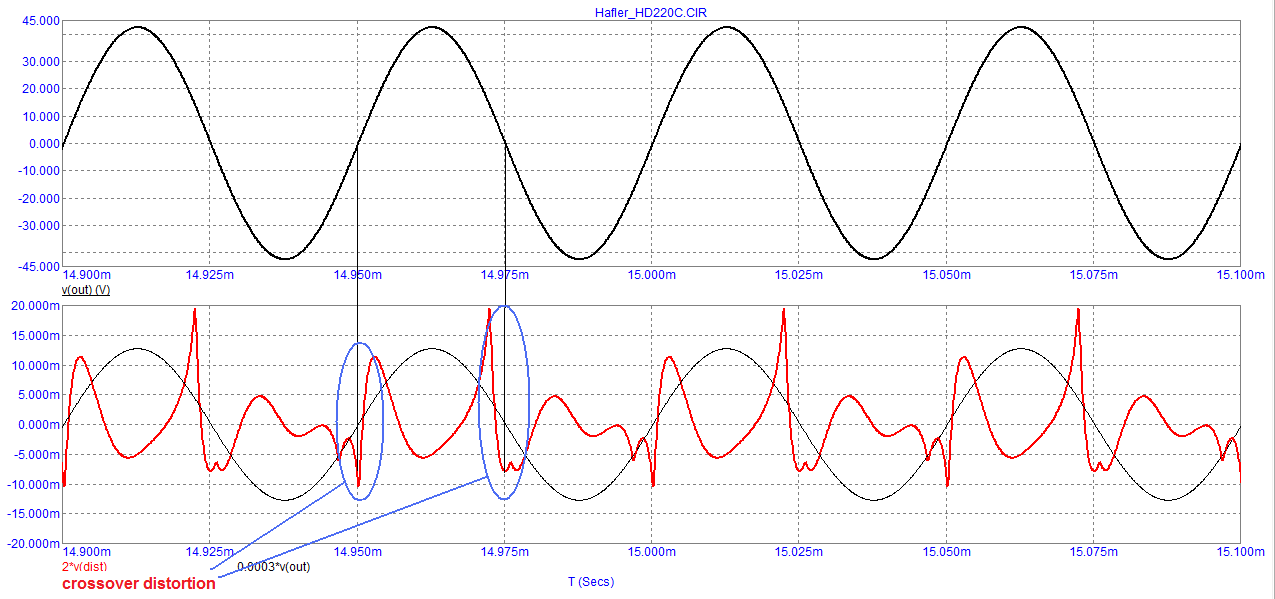

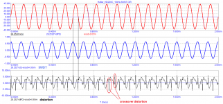

Bob, you're wrong about the effect of the delay!
The SWDT test is the only correct test, you just need to apply it correctly, with the correct signals. All tests used today (THD, IMD, etc.) are at the lowest level of correlation with sound quality. This was known back in the early 50s of the last century, and to this day we are looking for lost car keys under the lantern at night, because it is brighter there. Here are the results of additional tests:
Crossover distortion is 2 ... 3 times higher than nonlinear distortion.
Measured the distortion of a signal with a frequency of 10 kHz.

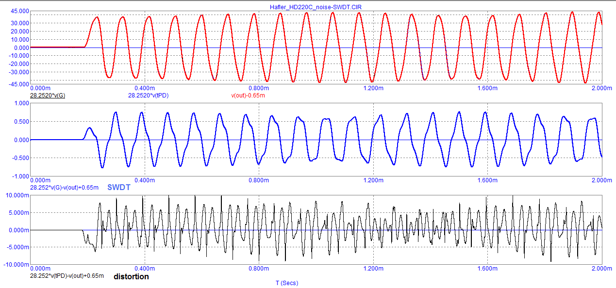

Without changing anything, switched the signal to pseudo-noise of 10 kHz 1/3 octave (from a compact disc for checking the frequency response).
The SWDT amplitude remains the same, and the distortion level has doubled! (due to high-speed distortion).
According to the SWDT theory, the error level at a frequency of 20 kHz with an output voltage of 20 V should be no more than 20 mV, but in fact we have almost 600 mV! (30 dB more).

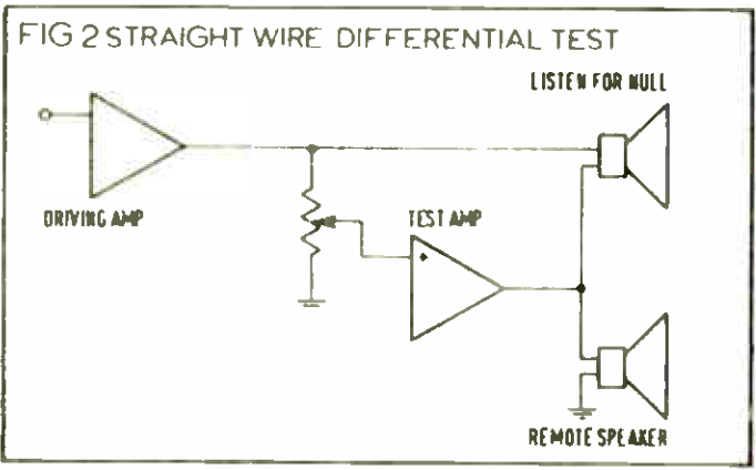

Here is a drawing from Hafler's original article Hi-Fi-News-1986-11_pp25-29
"The SWDT is elegantly simple, requiring no instruments. Its merits are obvious, but it is extremely difficult to apply because of its great sensitivity. A few minutes of phase shift, or some millibels of amplitude variation will show up as significant sound. This test shows most amplifiers to be audibly inaccurate. When a similar approach to amplifier testing was discussed in the past*,
the experimenters found relatively high levels of sound due to phase and amplitude variations. They did not consider these to be important, and they compensated the straight wire to minimize such variations. They made the assumption that phase variations were inaudible. This is disputable and controversial. We prefer to correct the amplifier to eliminate these aberrations rather than to eliminate them from the signal source. "

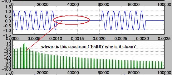

In the third of those images you have a switched 20kHz signal that's not band-limited, so the peaks you label as "speed distortion" are simply the result of the amplifier not having as much gain in the ultrasonic region as the audio band. This isn't non-linear distortion, its a frequency-response thing.According to the SWDT theory, the error level at a frequency of 20 kHz with an output voltage of 20 V should be no more than 20 mV, but in fact we have almost 600 mV! (30 dB more).
Discontinuities like this in a waveform carry a broad spectrum of high frequency energy, and don't represent standard audio signals which tail off rapidly above 20kHz.
If you use the input-output comparison method you have to ensure the test signal bandwidth is within the range for which the amp has flat phase and frequency response or you won't be measuring just distortion.
Note that these are discontinuities in the derivative of the signal, and are much less severe than steps in the signal itself (which will slew-rate limit), but they are still discontinuities with significant components upto MHz or so.
There is an issue that's seldom talked about, which is that many (mainly analog) synthesizers put out very wideband signals (square waves etc), and can be a hard for a live amp to handle gracefully without a 20kHz shelving LPF in the path.

Crossover distortion IS nonlinear distortion.

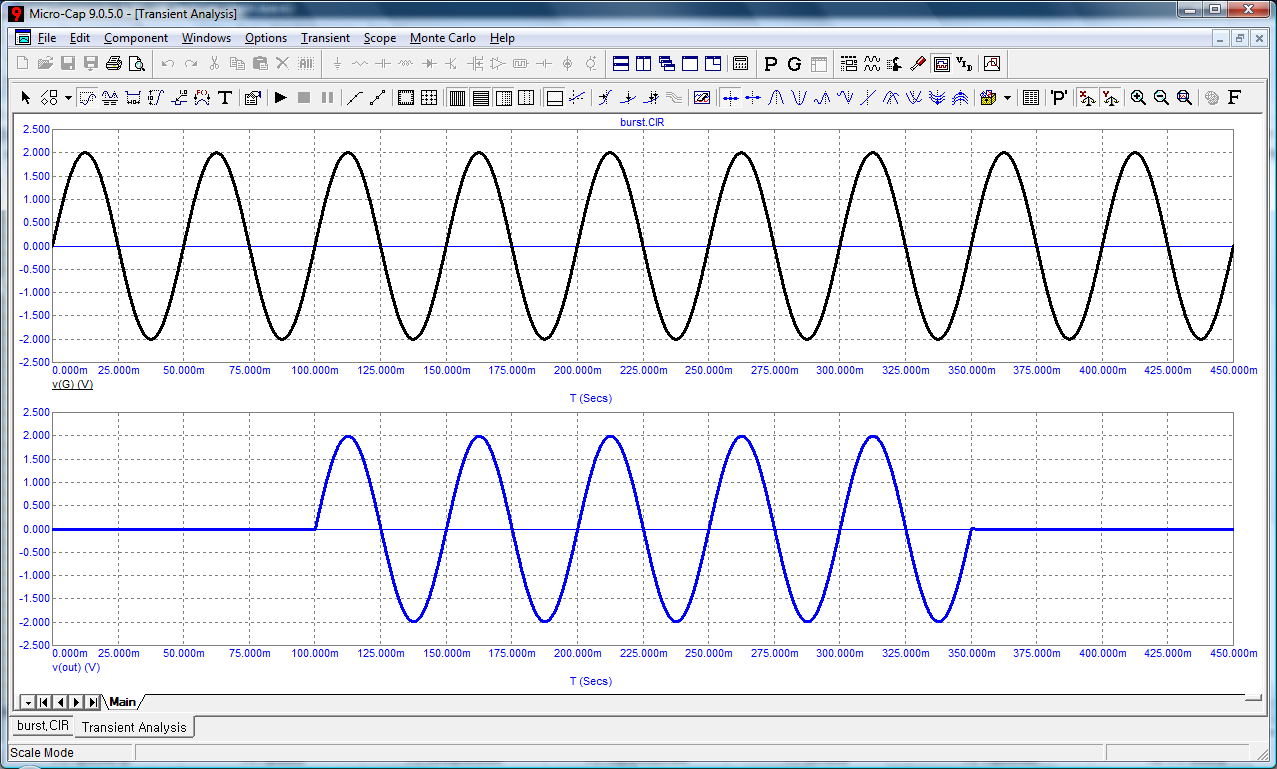

You might want to consider the spectra of various chopped up waveforms, and how removing discontinities can drastically drop the amount of ultrasonic artifacts:
The last one has a raised cosine window applies to it (aka Hann window), removing the end discontinuities. There's far less spectral splatter (as its called in RF circles).

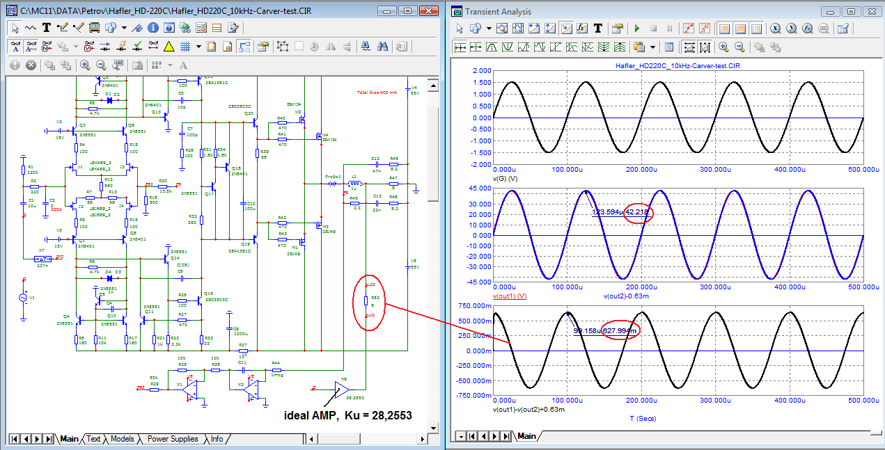

If someone does not understand my application of the Hafler SWDT test, then I hope they will understand the application of the Carver test.
Carver's test consists in adjusting the parameters of the amplifier to the parameters of the reference. In this case, I used an ideal amplifier as a reference.
Amplifiers are "identical" by ear if the difference does not exceed -70 dB (3000 times).
With an output voltage of 42 V (peak), the voltage difference must not exceed 42000/3000 = 13 mV. In this case, the difference is 630 mV! that is, 630/13 = 48 times more.
So there is no need to talk about any reference amplification of this amplifier.
note. In previous tests, all test signals were passed through a low-pass filter with a cutoff frequency of 100 kHz, and the noise signal from the CD was processed by a 4th order Bessel filter with a cutoff frequency of 30 kHz.
