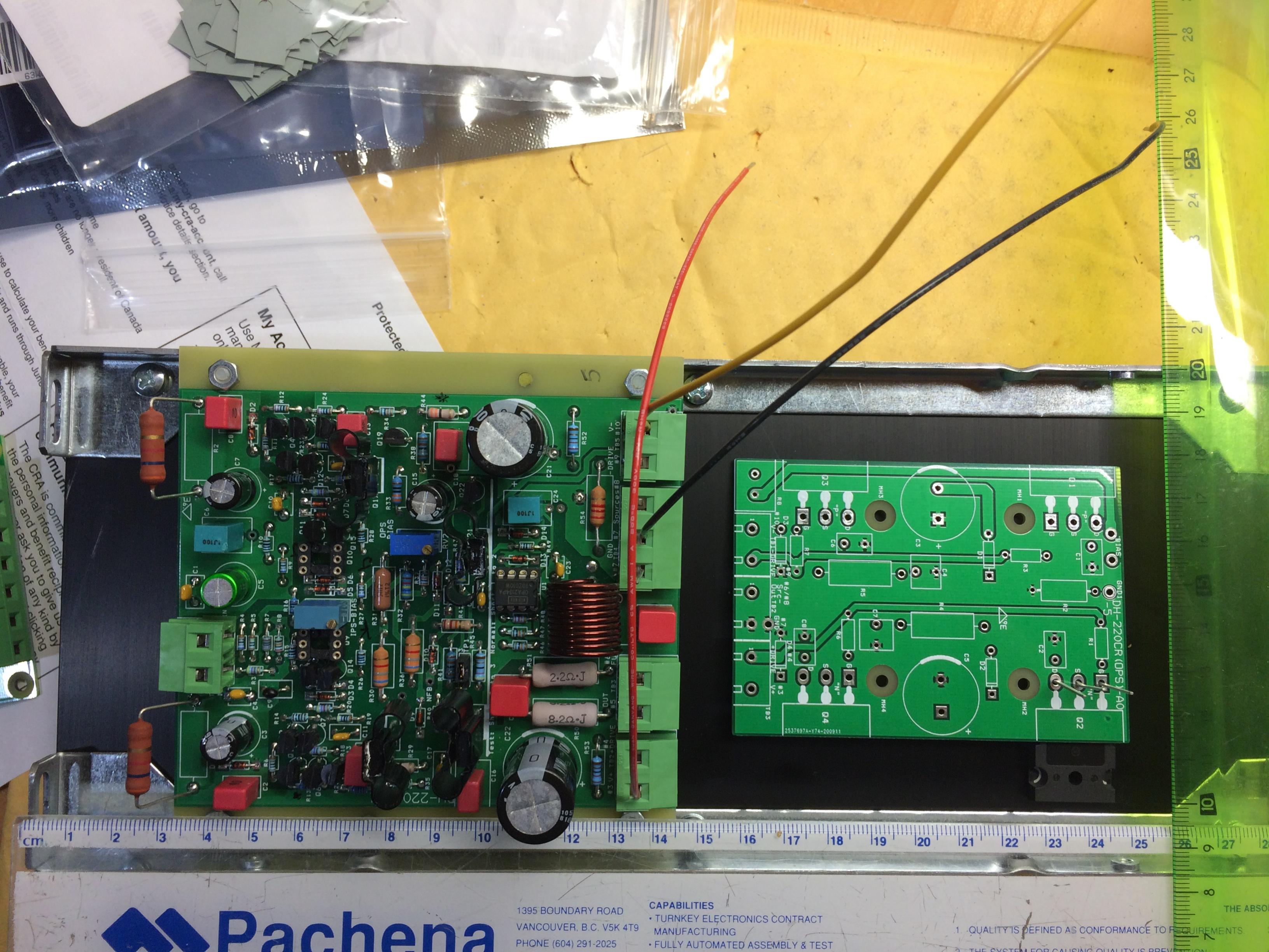

Bob has his amp running and tested it out, as mounted on one heatsink side. Mine is in final assembly.
We evaluated a few transformer options, so I bought a transformer last week. I found a very reasonably priced Triad 500VA/50-0-50V at Arrow which will suit my purposes. Watch out for shipping costs. Arrow shipped mine for free.
Imo we have the basic mechanics of the chassis and pcb figured out. Need to figure out AC supply means. There are a few options available. Was thinking of doing another pcb for that. So moving along but slowly. I am happy that we have the chassis mechanics figured out in that 3Ux300mm chassis. I found the chassis could use a few minor mods to make assembly so much easier, in our case.
We were lucky to get a first rev's of pcb's out without a chassis fit issue. I should have gotten the chassis first before designing the pcbs.
If there is a lot of interest we can start a BC-1 thread.

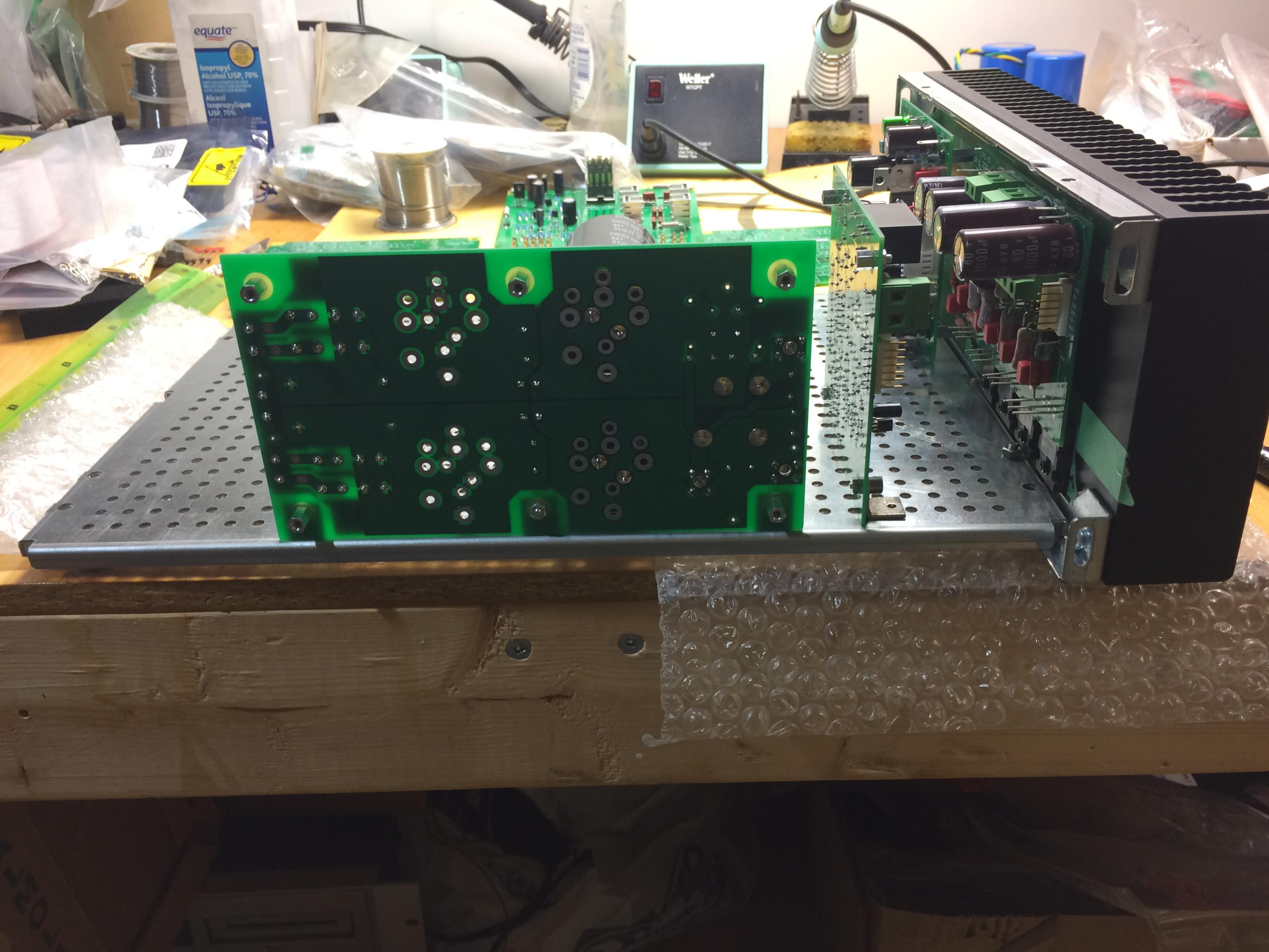

Hi Von,
The second round of PCBs for the BC-1 is up and running and undergoing evaluation. Results so far are very encouraging. The second round primarily involved a physical design change to make the boards compatible with a suitable available enclosure. The first round was implemented on two boards. The current second round is implemented on 3 boards (not counting a power supply board). Those are the analog front end (AFE - IPS/VAS), output board (OPS - including drivers and output transistors) and the protection board (PROT).
These are 3 smaller boards whose dimensions are suitable for a 3U enclosure/heatsink arrangement, and provide some physical design flexibility. In a 300 mm deep enclosure, the AFE and OPS will be mounted on the heat sink, with the PROT mounted elsewhere. A third round of PCBs will include minor layout touch-up (likely very minor) and a mirror-image set of boards (at least AFE and OPS) to implement the "other" channel.
Physical design to integrate the board set into the chosen enclosure is ongoing and in an advanced stage. Rick can make better comment on PCB and physical design status. Toroidal power transformer recommendations are also being worked on as part of the physical design process.
Depending primarily on transformer details, the amplifier will deliver at least 150 wpc into 8 ohms. The amplifier has been tested into 8, 4 and 2 ohms.
Time frame? Not yet sure.
Bob
