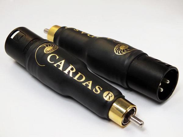

I am aware of these options, it is a simple and elegant solution (several versions are made) and while pricey, it is built to a level of quality which supports the cost.
I have spoken to both Ralph Karsten of Atma-Sphere and Josh Meredith at Cardas about these options... Ralph recommended a resister across the unused pin, and Josh asked to confirm which pin that was. I asked Ralph about my concern if it would asymmetrically load the cascode follower output stage... he said that it would in a minor way, but that it would not be a problem.
XLR to RCA male (allows for a variety of cable use, across different amps)
Cardas Connector MXLR to MRCA Adaptor

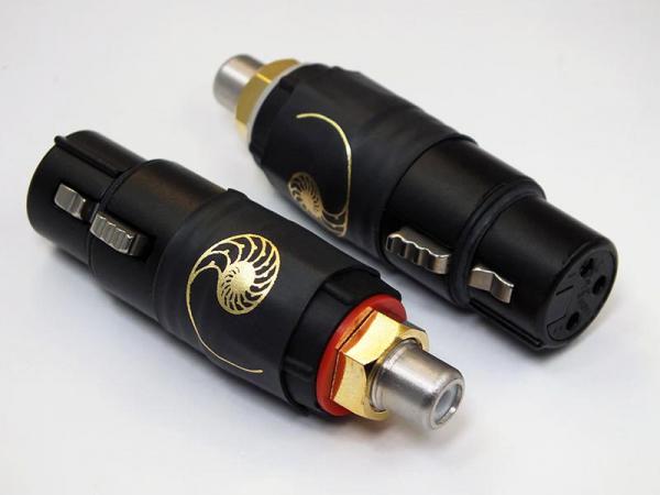

XLR to RCA Female (solves the preamp feeding SE amps only)
Cardas Connector FXLR to FRCA Adaptor

Some of you may want to know that using an XLR to RCA adapter provides no advantages of a balanced cable. In order to reap the benefits of a balanced interconnect, you must have a true balanced driver and receiver circuit.
These is one trick that does provide some benefit. That is connecting an unbalanced source to a balanced input. Instead of tying the shield to ground at the balanced destination, you connect the shield to the minus input and NOT tie the shield to ground at the receiving end. This does help reduce noise pickup from the cable. This was done extensively with analog broadcast video equipment because video cables are unbalanced. The video input stages were true differential amplifiers with the BNC connector shell connected to the diff amp minus side and not grounded. The main benefit was due to the USA 60hz AC line and the 59.94hz vertical rate modified for color TV in the 1950s and AC line ground loops causing rolling hum bars in the picture.
There are also some caveats mixing balanced and unbalanced depending if either device has a transformer or electronic balanced circuit. This relates to what you do with the minus side. Do you tie it to ground or let it float? Those here with electronics backgrounds will see the issue. You can't have an open transformer winding. And you really don't want to short out the minus side driver on a balanced electronic interface circuit.
Then there is the level problem. Consumer gear signal levels are loosely defined. Anywhere from -10db to 0db. Modern pro gear is now standardized at +4db. Vintage gear may even be +8db. You can see the problem here.
In a small home HiFi setup there is really no benefit to balanced I/O. The cable lengths are not significant. And for the purists, a balanced I/O circuit has more parts. And good transformers are expensive - starting at $100. And they too are not 100% transparent at any price.
Now I do run all balanced audio in my HT system. But I have four racks of AV gear including many computers. So I have a lot bigger risk of noise pickup. I also use pro DACs which are balanced so it made sense to put balanced inputs on my amps. But again for most people balanced I/O is unnecessary and not desirable.
