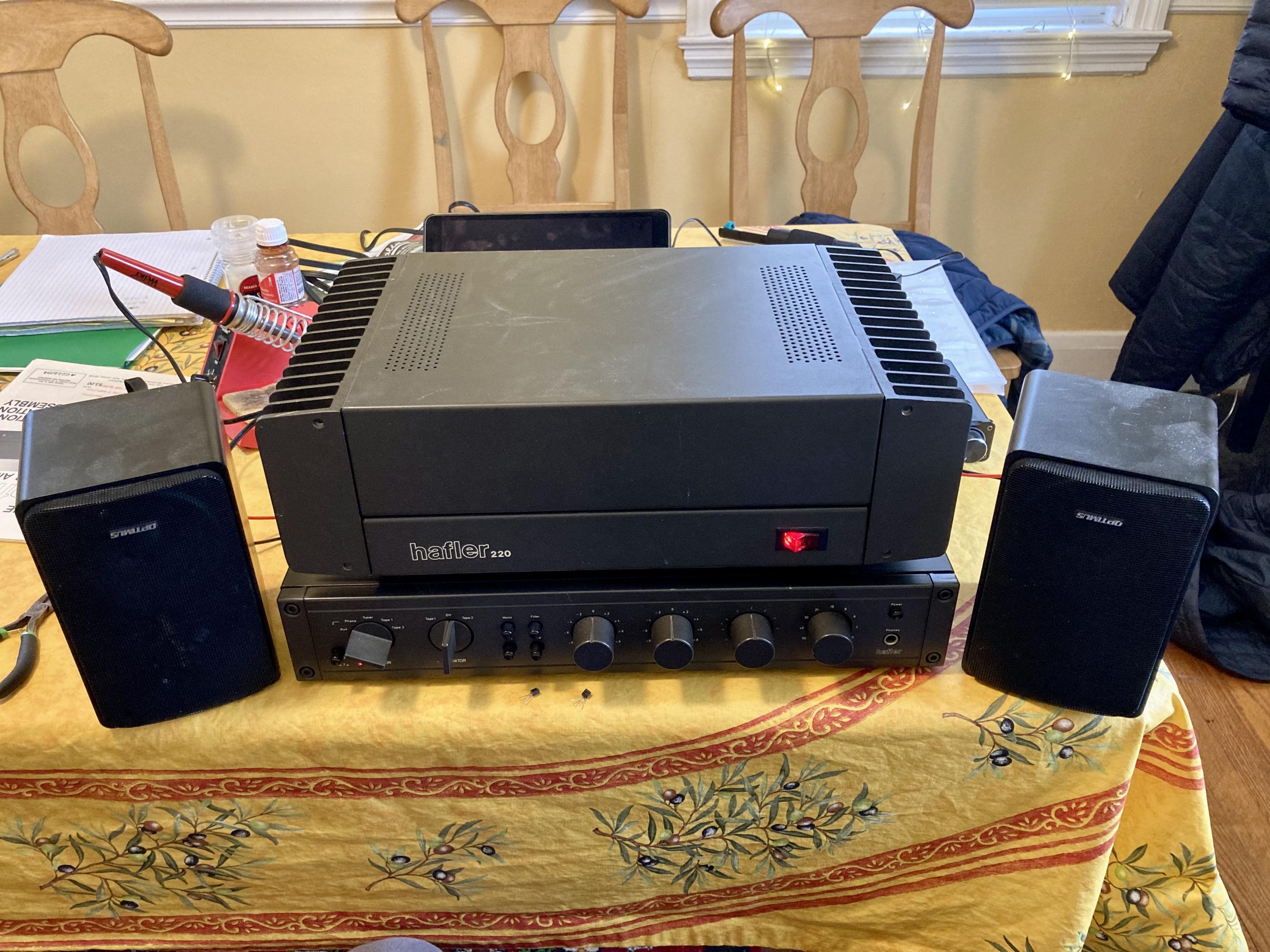

Alas I have removed the cover, inspected closely and see nothing wrong. Looks like the day I assembled it in 1980. Off to the experienced electronics guy it goes. I have enough stuff to fix in the new house as it is.
If you can, please let us know what the problem was.

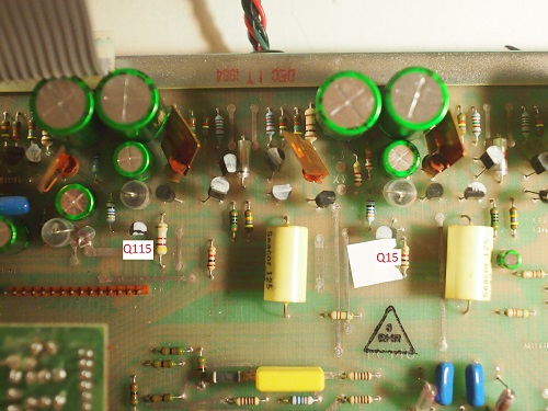

I also have a channel out on my dh110. so, I'll be trying out some of the recommendations in this thread. caps and jfets need replacing. it's a first dh-110 generation version; certainly it needs it. so far, only a j-fet is testing weak.
R- channel was low volume/out of balance with L-channel. took out R-channel j-fet. it tested like a new one last night. today it tests like an npn transistor. did not install j-fet back. R-channel is now balanced with L-channel. don't understand why the j-fet would go out after replacing it new and just a few months of use. had volume way high with amp volume low. don't recall if j-fet purchased on the bay or digikey.
check those resistors in the muting circuit if having issues related to the j112 jfet... have replaced about 6 out of spec resistors on two dh 110's after experiencing the low volume issue and on the muting circuit.

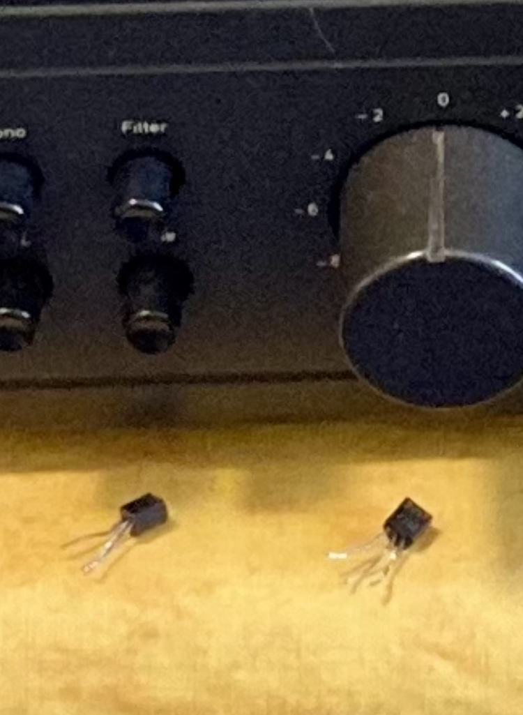

Another reason to be grateful for this site: this thread popped up today and I repaired my DH-110 with the simple removal of two JFETs! Amazing!
I had tried deoxit first a while ago on its own and decided I didn’t want to go through a whole recap and parts replacement… Low and behold I could just remove two fets and voi la! 😀
The preamp is a bit noisy compared to others I have, but it now works fine!

Hi von Ah,
Those are for muting. You shouldn't just pull them! They would not have been designed in without a good reason.
The preamp can be improved by improving the power supply. A "recap" isn't always a good idea, but out of tolerance resistors can be a problem in all old equipment. Keep the J-Fets, fix the muting circuit and reinstall them.
Just friendly advice.

Understood.
I’ll take another look at the muting circuit, address any issues there with resistors, etc. out of spec, and reinstall the jfets. I won’t use it until that’s done.
Thanks to you both.

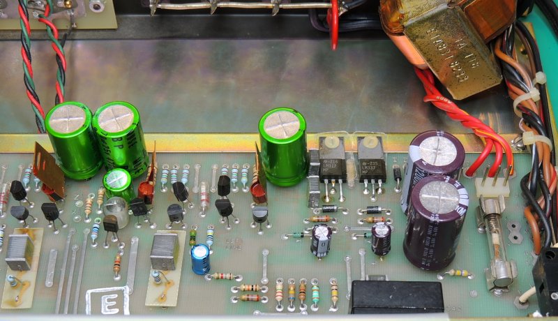

there's a schematics error related to the muting circuit: 4.65k resistor that connects the mute circuit to capacitor c19 is not shown. below r66 on newer boards. left channel was out. fetched the resistor out of the trash. if not using the jfets j112, there's a possibility that speakers could get blown out. happened to me...pop! good thing polyswitch fuses are my thing. now I use the mute switch prior to power on. haven't noticed any negative muting issues, yet...but time will tell. have had to drill a hole to get the cleaner into the volume pot, on some preamps... disassemble others. there's usually a thick-black goo in them.
nice and easy way to trace component path is to shine a flashlight on the solder side of the board....helped me find the missing 4.65k to c19 trace break and a non-fully soldered spot. cool!
older model has the resistor integrated on the polycarbonate cap board. see pics.
