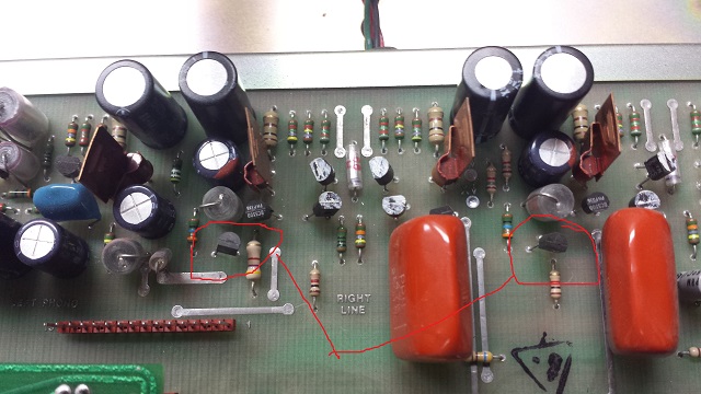

there's a schematics error related to the muting circuit: 4.65k resistor that connects the mute circuit to capacitor c19 is not shown. below r66 on newer boards. left channel was out. fetched the resistor out of the trash. if not using the jfets j112, there's a possibility that speakers could get blown out. happened to me...pop! good thing polyswitch fuses are my thing. now I use the mute switch prior to power on. haven't noticed any negative muting issues, yet...but time will tell. have had to drill a hole to get the cleaner into the volume pot, on some preamps... disassemble others. there's usually a thick-black goo in them.
nice and easy way to trace component path is to shine a flashlight on the solder side of the board....helped me find the missing 4.65k to c19 trace break and a non-fully soldered spot. cool!
older model has the resistor integrated on the polycarbonate cap board. see pics.
