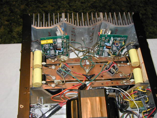

Another mod consideration is to simplify input signal wiring. Get rid of the level controls, the stereo/mono switch and wiring, and for sure the ambiance speaker output circuit. You will be surprised how much "grunge" is removed by simplifying input and output signal wiring.
I built a custom version using DH-120 circuit cards and made an amp that sounds almost like the DH-220. I used a power trans with about 3 times the amount of current drive, 4 times the amount of PS capacitance, and a separate diode bridge for each channel -- plus the simplified wiring mentioned above. It made a great sounding little amp much improved over the stock DH-120 and with great sound stage and imaging. But, of course it required a larger chassis and heat sinks. Its picture is attached.
So, tell us why you want to mod your amp? What do you hope to gain from mods?
