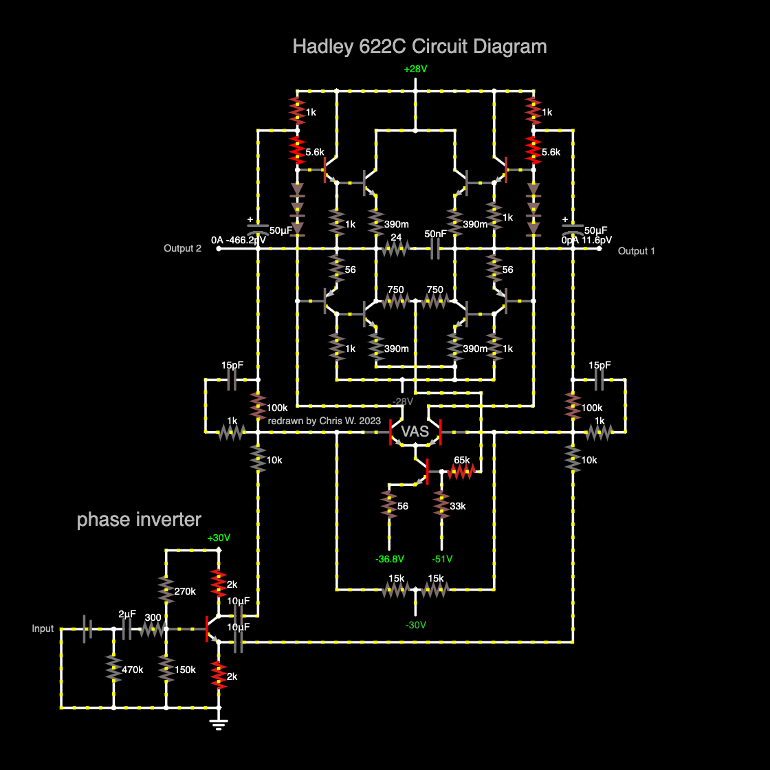

Yes, but it may be ample. On the up-swing the bootstrap cap can boost well above the + rail. On the down swing, the tail of the diff-pair has its own lower rail, -36V re: the -28V fed to the power stage.the input diff stage does all the voltage swing.
It seems awful shy by modern standards, but transistors were expensive then.
Based on the simulation I created and used to guide the entire restoration, I could hit around 70W into 8-ohms or ~+12V and ~-12V at the outputs simultaneously before the boosted voltage would touch the Vceo of the Dual NPN differential pair. That assumes an ideal power supply, however.Yes, but it may be ample. On the up-swing the bootstrap cap can boost well above the + rail. On the down swing, the tail of the diff-pair has its own lower rail, -36V re: the -28V fed to the power stage.
With supplies of nominal +/- 28 V I would expect peak output excursion of a little bit less than this, and not only 12 V.
But if you are afraid of damaging the dual bjts we will not see a scope picture of the peak voltage .. ?
You will get higher voltage if you measure the individual output transistors, but not at the outputs.With supplies of nominal +/- 28 V I would expect peak output excursion of a little bit less than this, and not only 12 V.
When the amplifier has an output of +12V at one output, it simultaneously has -12V on the other output which gives you 24V total.

Te original plan is here, at the beginning of this thread. I was adding the link for completeness.
This is a very interesting schematic and far ahead of its time.

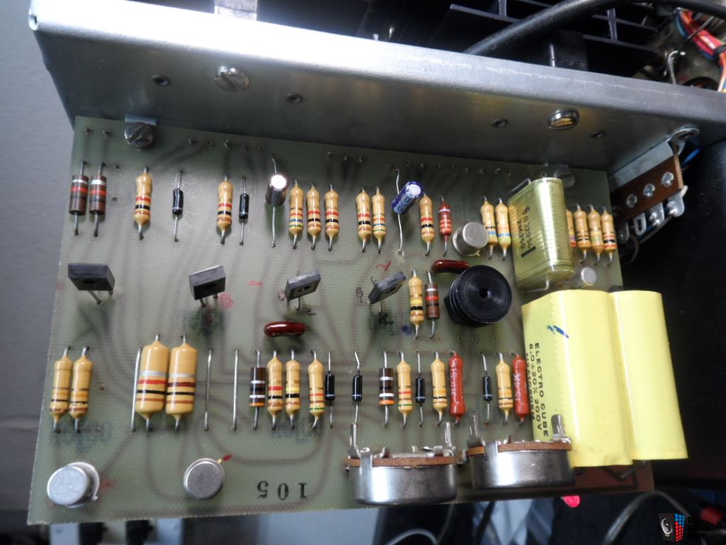

This amplifier has been tested and both channels work. However, it may, and probably does, need some routine
maintenance to perform optimally. After all, it is almost half a century old, and has not been used in a pretty long
time, except for today, when I plugged it in and tested it. I don’t know if it has capacitors or resistors or other parts
that routinely wear out over time, but it probably does, and those types of things, while they may not stop an amp
from working, can impact the sound quality, if they need replacement. If you are going to actually use this as an
amplifier, and not just a super collectible extremely rare piece of audio history, then you’ll probably want to have
a qualified technician go over it and tune it up. If I was going to use it, I would do that, but it works now, as it stands,

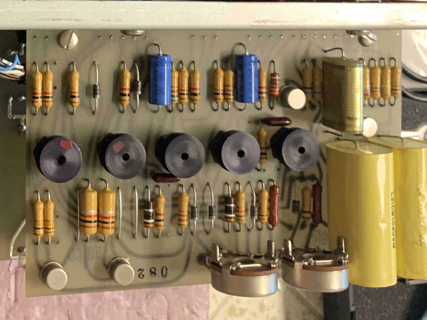

I'm having some issues with the amplifier that I'm working through, but while I was troubleshooting, I made some observations I had not previously made.
Below is one of the boards from my amplifier and a board from a later serial number model. I believe all of the resistors to be original these particular units.
Why would Hadley go from using early film resistors for most everything (except for the 56 and 15k ohm resistors) back to using two additional carbon comp resistors for the 1Ks in the top left and one toward the middle of the board? I've seen carbon comps used for the 10Ks below the 1Ks and the larger 1W 1K resistors the right of the 10Ks. These sets of resistors as well as the transistors at the bottom are both related to the current limiting circuit. Assuming this was not because of cost, would there be any reason to use carbon comps here?
The carbon comp 1K resistors in the top left are for the DC protection circuit. They're likely carbon comp to soften any sudden rush of current if the protection circuit were to become active.
There were a couple of carbon comps in the power supply that seem to be for a sort of "soft-start" or current limiting at power on.
Below is the abstract for the x-design patent with my notes relating to the 622C and the colored sections in the table below:
AMPLIFIER WITH GAIN STAGES COUPLED FOR DIFFERENTIAL ERROR CORRECTION
Abstract: An amplifier circuit having two identical inverting folded-cascode amplifier stages coupled together through a coupling resistor at the positive terminals of the respective stages. Each stage includes an input gain transistor whose gate forms the negative input terminal of the amplifier stage coupled to receive an input signal through an input resistor, whose source forms the positive input terminal of the amplifier stage, and whose drain is connected to the source of a level-shifting cascode transistor. Both transistors are supplied current from a constant current source also connected to the source of the level-shifting transistor. The drain of the level-shifting transistor forms an output terminal of the amplifier stage. Each stage feeds its amplifier output negatively to the positive input of the other stage, while at the same time feeding its distortion and noise contribution positively, via input gain transistor conduction, to the other stage. Balanced amplified outputs are produced from either balanced or unbalanced inputs, and distortion and noise components are produced in common on both outputs for differential cancellation. Complementary-symmetry and power amplifier versions of the basic single-ended line-level amplifier are also provided.
Below I've redrawn the Hadley 622C schematic into something that clearly shows the beautiful symmetry that I don't think Dawson Hadley wanted to show the world in 1965. One thing is for sure, he knew what he had. Now did he come up with it or did it come from elsewhere? Any tube circuits that look like this?
As one can see, there isn't much left in the abstract not addressed and simply put, the Hadley 622C exhibits the same (if not more) of the "super-symmetry" the x-design does and was capable of doing this 28+ years before the patent.
An example of this behavior: if you inject noise into the inputs, the amplifier will not only cancel the noise and eliminate DC at the outputs completely (to the extent your components are matched and can handle the voltage), but it'll return to its quiescent AC balance as well.
Additional, since this amplifier has one power supply and two of these bridged amplifiers per physical unit, there is a beautiful interaction of the three that takes over at a certain point of matching precision that I can't quite explain.
Inherently, there is no need to match component temperature coefficients to the transistors, but the closer the components match and track each other and the more β & other parameter matched the components are, the better the amplifier will perform up the limitations of the physical construction of the unit as a whole. The circuit is certainly not the limiting factor.
Hi hadley,
Just what do you mean by "if you inject noise into the inputs, the amplifier will not only cancel the noise and eliminate DC at the outputs completely (to the extent your components are matched and can handle the voltage), but it'll return to its quiescent AC balance as well." ?
The amplifier doesn't know what is noise or a signal. This amplifier is an elegant bridged amplifier design using a quasi-comp output design. It's pretty simple to figure out and shouldn't be difficult for a competent technician to repair properly. It is a minimalist component type design but should work fine.

I've continued work on the 622C and I've reached the point where DC offset can be measured in μv and a car driving by outside affects the meter reading. Keep in mind that I removed the DC adjustment pot so this is due to the design and the components alone.
According to the HP 3440A voltmeter I use (yes, I use this heavily modified dinosaur for a reason...), the 622C has a DC offset of +/- 50μv. There seems to be no pattern and the reading appears to spend about equal amounts of time positive or negative.
That is just electronic circuit noise, and you will have thermal drift in there as well.
Did you examine the output using an oscilloscope? There may be some answers there.
Thermal drift is cancelled in this circuit.
We are talking about +/- 0.00005 VDC offset here, so there is no problem with the amplifier.
Look at the circuit and tell me what happens to the noise. Now of course, there are limitations like the PCB, but performance is still being limited here by component matching.
This result is why I matched the components in the way that I did to 0.01%. Understand now?
