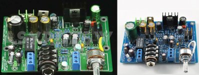

Yes, but the picture shows TIP41C written on the PCB. When first released it had IRF610 and then LJM revised with TIP41C.
I assume since the photo was updated to the version with TIP41C that the seller is shipping that version. But I guess it is hard to tell since the picture reads TIP41C and the item title/description says IRF610.
I wonder what else needs to be changed to swap TIP41C with IRF610. Bias but are the changed compatible with the new PCB layout?

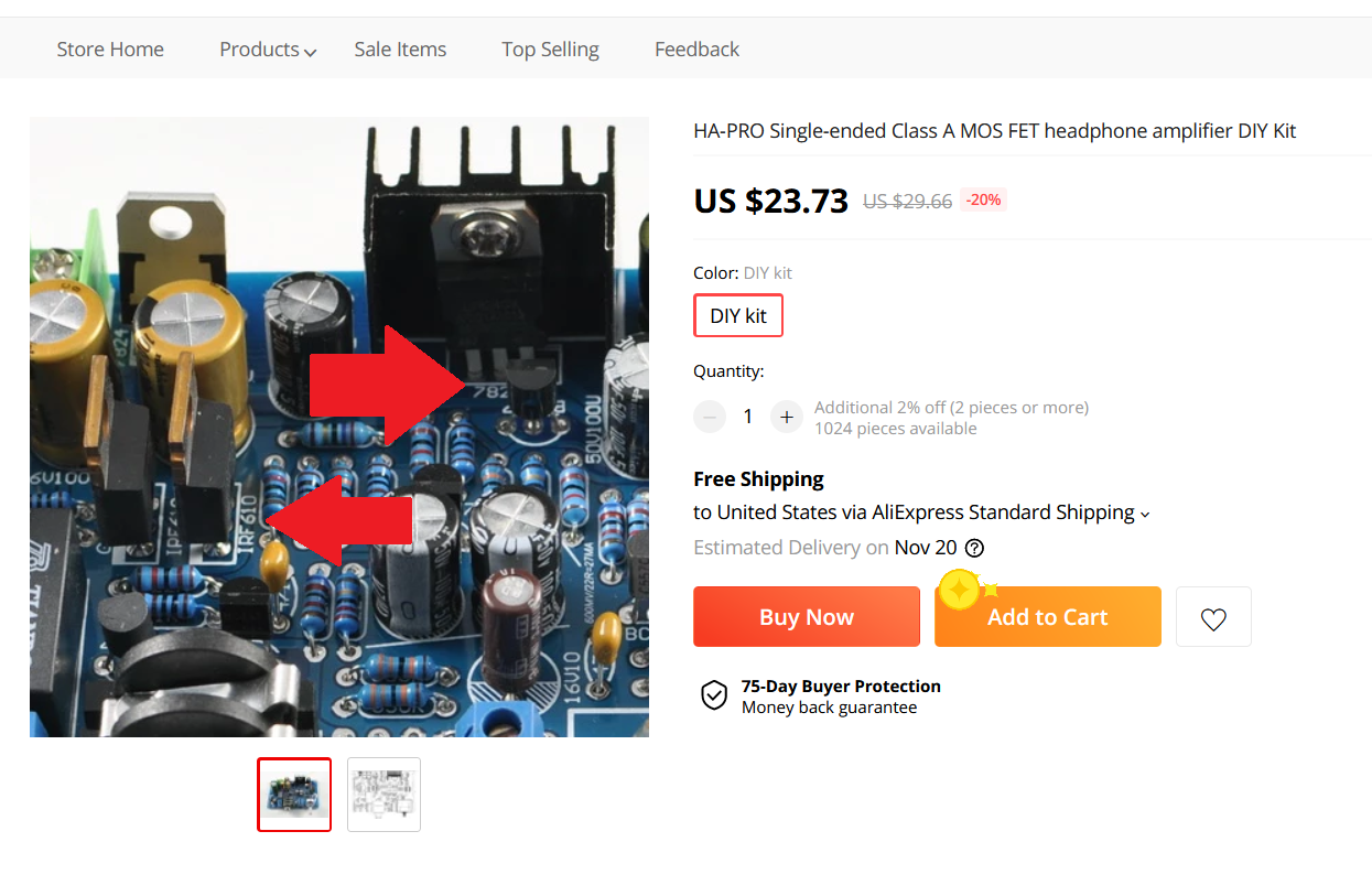

As another example this listing has a photo with LM7824 (old old version) with IRF610 written on the board. And it looks like the metal tab IRF610 LJM used. (I think the TIP41 he used was fully plastic encapsulated.)

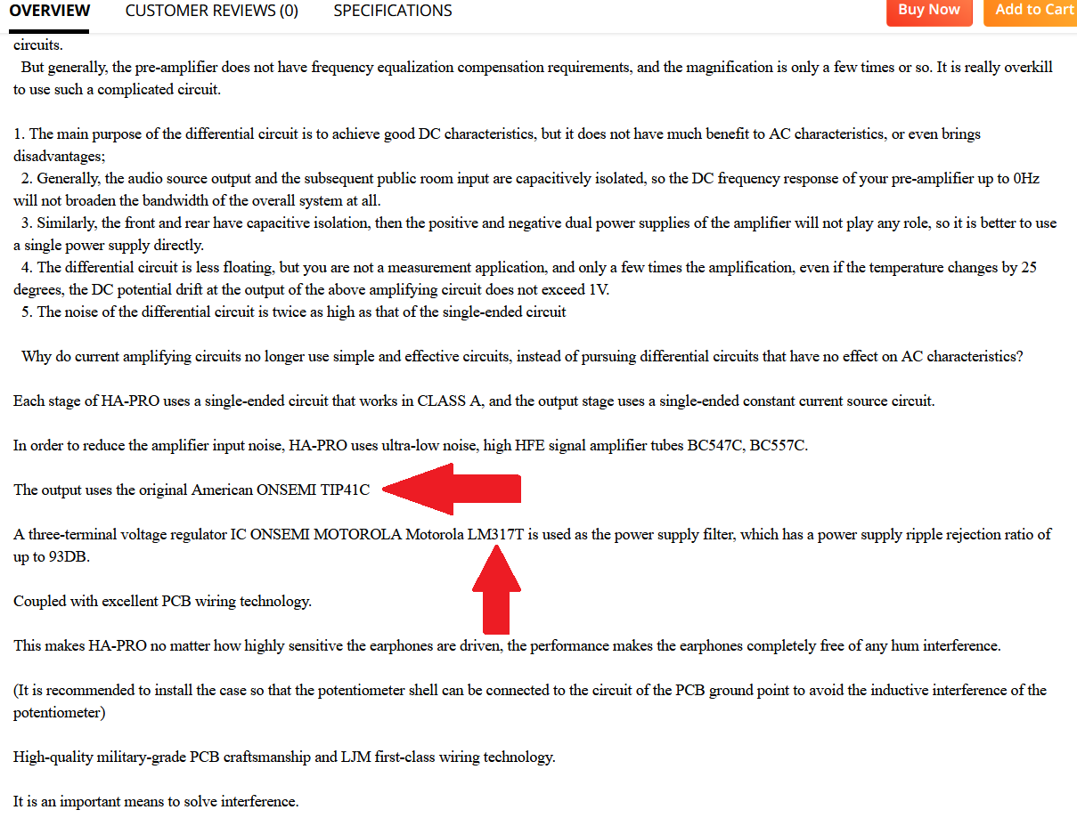

HA PRO Single ended Class A MOS FET headphone amplifier DIY Kit|Amplifier| - AliExpress
Yet when you read the detailed description you first see a silkscreen outline drawing with LM317 and IRF610 and then you read text that says LM317 and TIP41. So who knows what you get.
I assume you get the latest LM317 TIP41 version. I would like LM317 and IRF610. Of course no published schematics so I will need to do some digging to see if there is any other changes outside of the biasing.

From the attached comparison it looks like the layout and components are the same for the IRF610 and TIP41 versions. Perhaps the BC547 NPN plus emitter resistor "current limiter/regulator" works fine with both the TIP41 and IRF610 to create the constant current sink without any other changes.

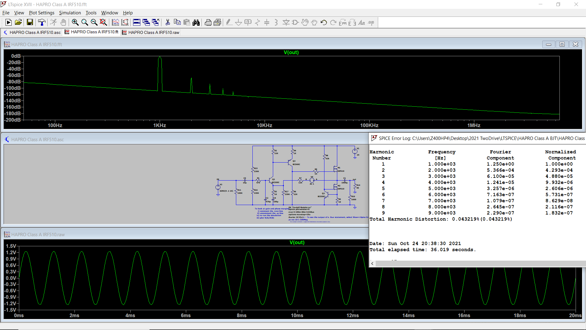

I made a first attempt to simulate the original IRF610 HA-PRO that I have (old long board, IRF610).

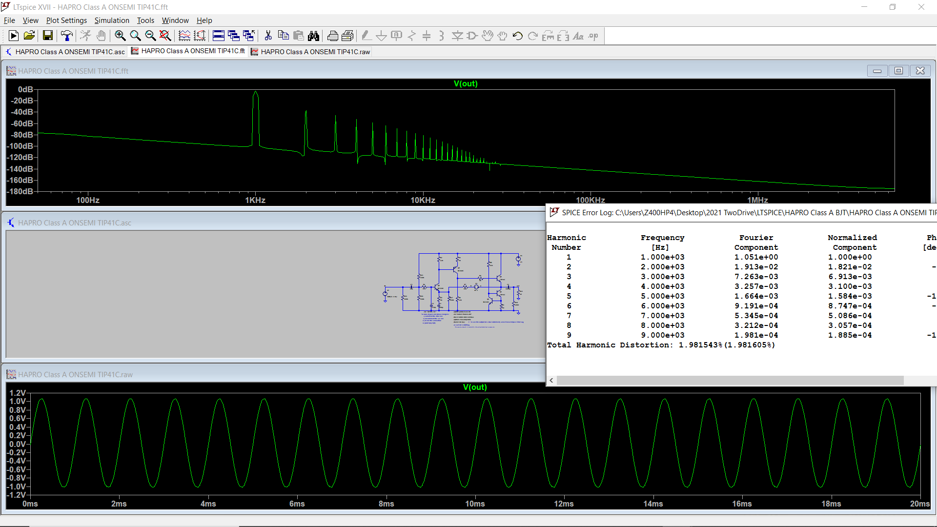

Then I looked at photos and board outlines to try to deduce the changes for the TIP41. I found that the new boards are silk screened with a 20 Ohm resistor (for the current sense/regulation) while the old long boards used 10 Ohm (twice the current).
I set the input to 0.1V sine 1 kHz and output load was 40 Ohm to match my ATH-A900. Since both the long board and new HA-PRO have built-in 100 Ohm load resistors and I saw it was having trouble with the 40 Ohm load I replaced the built-in 100 Ohm load with 2000 Ohm in simulation. (The 40 Ohm headphones are already low. I don't know why the design has such a low (100 Ohm) load built-in on the PCB. Hopefully not for... ...stability?)
With 1.3V peak output the distortion was about 0.04% THD for the old IRF610 long board and 0.76% THD for the new BJT version. That is just in simulation. I used Bob Cordell's BC550C/BC560C and BD139C models. Later I could try to find a TIP41 model but is that really going to be better than BD139C?
I tried halving the voltage for the BJT case and the results are still very poor at 0.28% THD. I wonder if there is another schematic change (on the TIP41) version that I don't know about. If anyone has a real/verified schematic please let me know. (The new HA-PRO with TIP41.)
Perhaps the modified NAIM design can not drive a large BJT but can drive a MOSFET. Perhaps it can only drive a smaller BJT output and lower currents suitable for line stages?
Perhaps I should not add this but I bet the harmonic profile shown in simulation for the IRF610 sounds better than the harmonic profile shown in the BJT simulation.

We should not rely solely on computer software.
Principles in computer software. And physical objects. In fact, there is still a big difference.
MOSFET is used in software simulation. It has no input current factor. This is a problem for software designers.
In practical application, MOSFET needs high VGS. About + - 4V
The impact is serious. We can't output higher voltage.
In practical application. I use ktc4370. TIP41C is not used.
However, both BJTs can get good sound.
