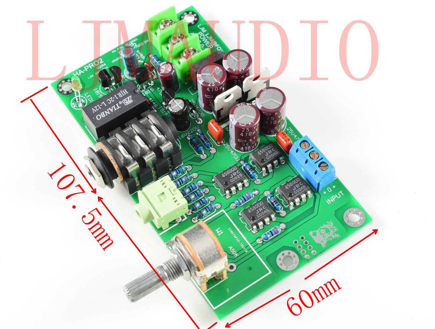

If you need excellent mains operated headphone amp you should try this kit. It’s reasonably priced and it needs only mains transformer and suitable amp case. Simple regulated PSU with high quality Rubycon elcos is onboard. PCB is of excellent quality and is double sided. All resistors are metal film with copper leads. There is mute circuit onboard using 12V relay so you won’t hear any annoying turn on and turn off pops. Enough space is provided on the pcb for ALPS Blue Velvet 27 mm pot if you think that you can not live without expensive high quality pot. I used 10k 16 mm log pot instead of 20k 30-position dented log pot provided with the kit. I shall use that pot for some other project.
Schematics are not available but I can describe circuit to you. It uses 4 opamps per channel. First one provides all voltage amplification and is driven from the pot wiper. Voltage gain is 5,5 times. Three remaining opamps are parallel unity gain buffers used as highly linear output transistors providing necessary current for headphones. Original kit was supplied with NJM4580 opamps which can give 50mA output current. I used high performance NJM2114 which has 60mA output current. I also have NJM4556 at hand but in this configuration they are not really necessary. Each output unity gain buffer has 10 Ohm series resistor at the output.
Sound quality is excellent. I tried this kit with both my Sennheiser HD424 (2000 Ohms) and AKG K141 Monitor (600 Ohms) headphones. I don’t think that headphone enthusiasts using modern low impedance headphones will have any problems with this kit. There is plenty of output current available to drive such headphones. (I don’t think that anybody has Koss K6LC 8 Ohms headphones in working condition to chalange this headphone amp design.)
This headphone amp kit from China will outperform many expensive western HiFi industrial products.

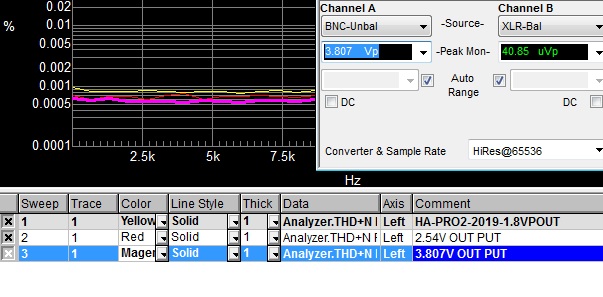

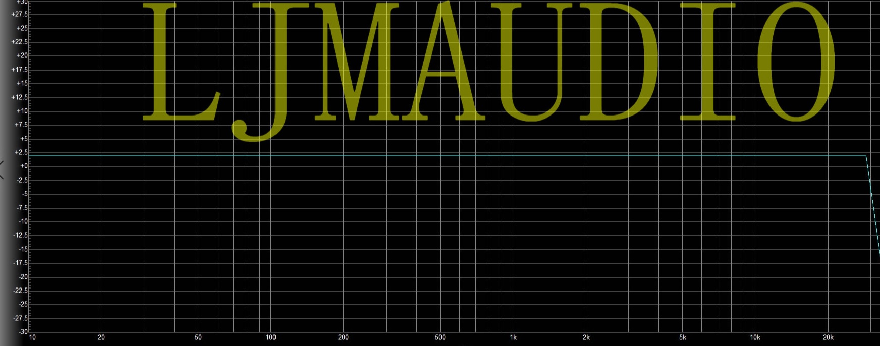

B: yes. HA - PRO2 is very simple, but it can play a full performance of the operational amplifier.
And I think it do not need to be more expensive operational amplifier.
I'm in the new production. Socket with a 3.5, by the way, mostly I feel more convenient.
In addition to the test data. To facilitate the actual contrast.
If someone need to other test data can email me. I really very slow landing site.
Three minutes maybe can open web pages.

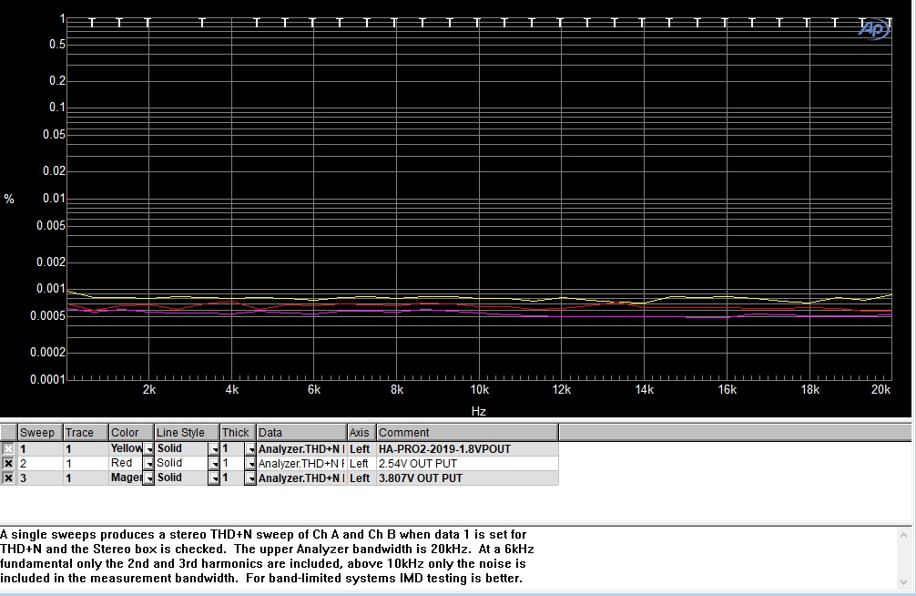

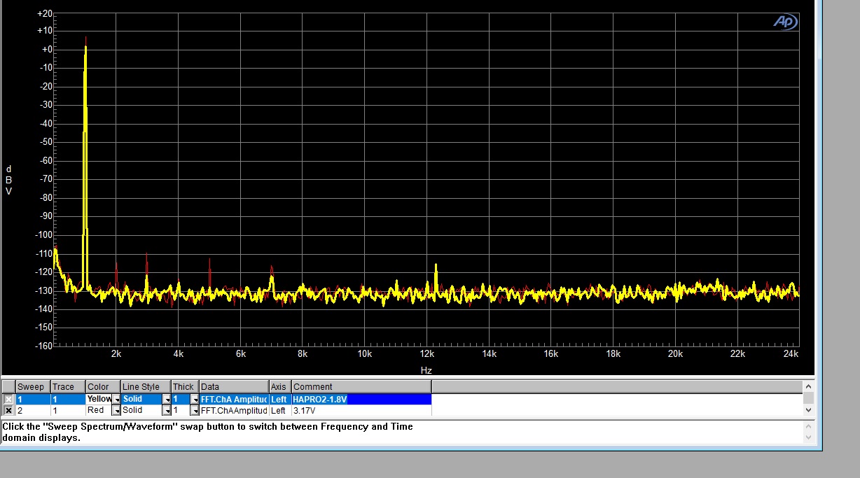

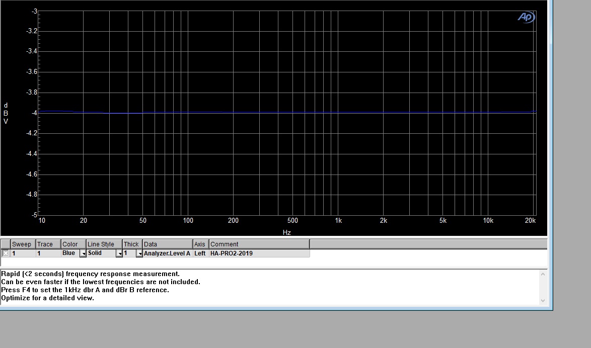

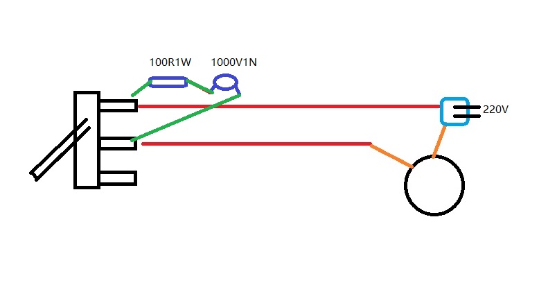

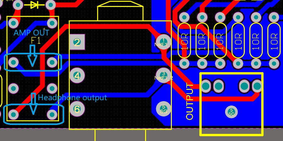

I have just assembled HA PRO2 Headphone AMP which I got it from aliexpress. It started working fine. But my 32 Ohm Headphone suddenly got some crackling sound and the board have not output any audio now. what could be the issue here? I am a newbie for electronics and like audio electronics very much.
It is a very simple circuit.
But must pay attention to the installation is correct. Especially the diode 4148 5 v must not mistake.
And important point. It must use AC 12-0-12 v transformer.
Can't a higher voltage. Because there is no voltage regulator IC relay. Higher voltage will damage the relay.
If you can. If you can measure the relay conduction. Or when the relay switch on.
If there is a gentle sound. Prove that no damage.
If damaged. You can consider to use wire, sub relay input, output.
Try to listen to sound output.
