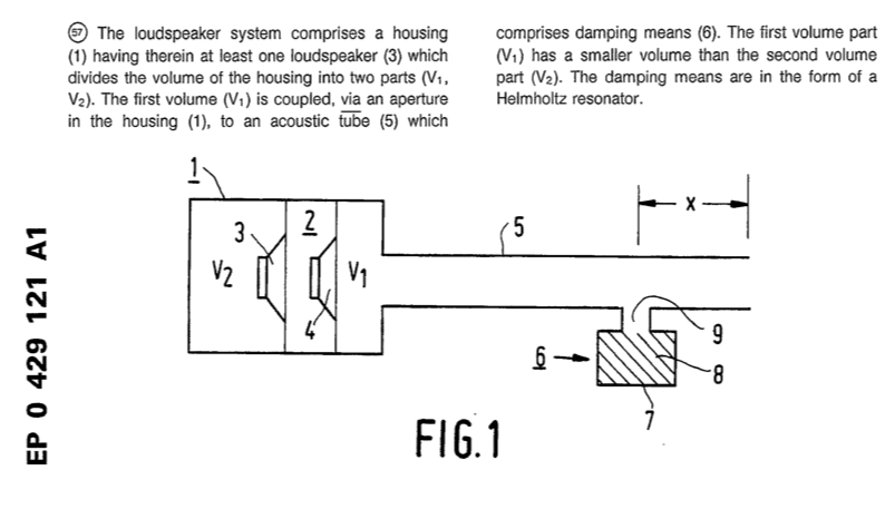

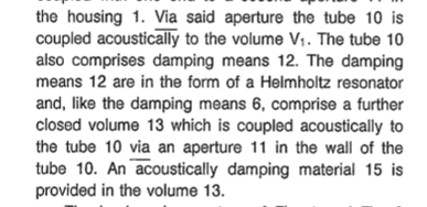

I thought i saw something like this before... here it is. espacenet - Original document
http://worldwide.espacenet.com/publ...DB=EPODOC&locale=en_GB&CC=US&NR=5261006A&KC=A
But then I guess marketing is marketing....

Hi revboden,
Nice find Post #41: Pat# 5261006. If you look through the prior art in that one (and so on) it's obvious, that applying a Helmholtz resonator to an acoustic pathway is an interesting, and always novel and patentable idea. (ROFC - rolling on the floor crying) 🙂
Any invention released with insufficient useful data to allow its' reproduction isn't an invention at all.
