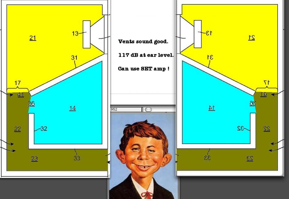

It looks like a reversion chamber, like the ones used on race motorcycle exhausts. It is used to produce a back-wave 180deg out of phase of frequencies that you want to kill in a Transfer line (or exhaust, same thing really). They can also be used to create back-pressure packing (120-160deg out dependent on freq.) i.e. wave scavenging.
ref: http://www.google.com/url?sa=t&sour...ubHTCQ&usg=AFQjCNGBOJixIKH3qtyZElcDav6DtzhDsQ
I think GM nailed it -- double bass reflex. No TL even involved.... (unless you consider the narrowing of the long port as a TL....)
From the 'fresh' patent..... page 1. ...
That drawing is perfectly modelable in AkAbak, given some dimensions.
It's more like a standard reflex with an additional resonator rather than a DCR in the accepted sense of the term.

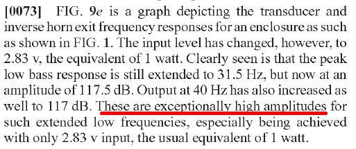

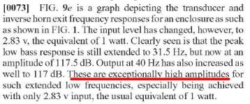

The 117dB they mention is that taken near field at the vent, not at the usual one meter. The overall sensitivity remains that of the bass driver itself rated at 1m/2.83v input.
However, the output at the vent is significantly higher than that observed from typical vented systems due to the pressure created from the inverse horn section of the enclosure. As mentioned at the competition, it is not just the extended low bass achieved in doing this it is the added dynamic range to the lower frequencies that sets H-PAS technology apart.
I could be completely off track, but my take on the H-PAS patent:
It seems to be a bass reflex design, constructed in the form of a short tapered transmission line (however, too short for the line length to have significant effect). Constructed as such, the acoustic impedance variations of the bass reflex enclosure can be flattened with the use of a coupled (closed) resonant chamber (instead of stuffing).
I believe I've seen a coupled-resonant-chamber used to flatten the acoustic impedance in a closed box/transmission-line, but I've never seen it applied to an open (ported) one [If someone has, please link]. (The topology seem more akin to dual-chamber-reflex with a closed secondary chamber, than it does to double-bass-reflex, IMHO.)
As far as I can tell, there is enough originality to warrant a patent.
If I'm off the rails, I welcome being put back on track.

Mr. Clement's response made me think of the inverse square law.
I calculated the output of a vent “taken near field at the vent” compared to a speaker with a sensitivity of 89 dB one watt one meter, using the 6 dB increase per halving of distance the inverse square law predicts, the figures below.
At 15.6 mm (about 5/8 inch ) from the vent, one could expect about 125 dB from a speaker with flat response down to the vent frequency, 117 dB would be about 8 dB down in response with a 89 dB output. If one assumes the speaker puts out half the level, and the vent the other half down low, reduce the above vent figures by 3 dB.
To check my figures, having a “ typical vented system “ a Tannoy PBM 6.5 (a small two way speaker) and a Radio Shack SPL meter handy, I played pink noise (LP at 24 dB per octave above 160 Hz) into one speaker, set the level to 89 dB SPL at one meter, indoors.
Moving the meter to 5/8 inch from the vent SPL was 118 dBC, with the meter’s microphone flush with the vent, SPL was 120 dBC.
The “ typical vented system" read 1 to 3 dB higher “at the vent” than the H-PAS technology.
Of course, allowing for the fact that “C” weighting reads a bit less than flat below 100 Hz, the Tannoy’s vent output may may be a bit louder yet.
Hoffman’s Iron law still seems to be unbroken 😉.

Measured at the vent.... I knew my BS-O-Meter was pegging 10. At least when I assumed 1 meter.... If you read carefully, it does kinda say 'at the vent.' I just missed it.
from the patent...
117dB etc
