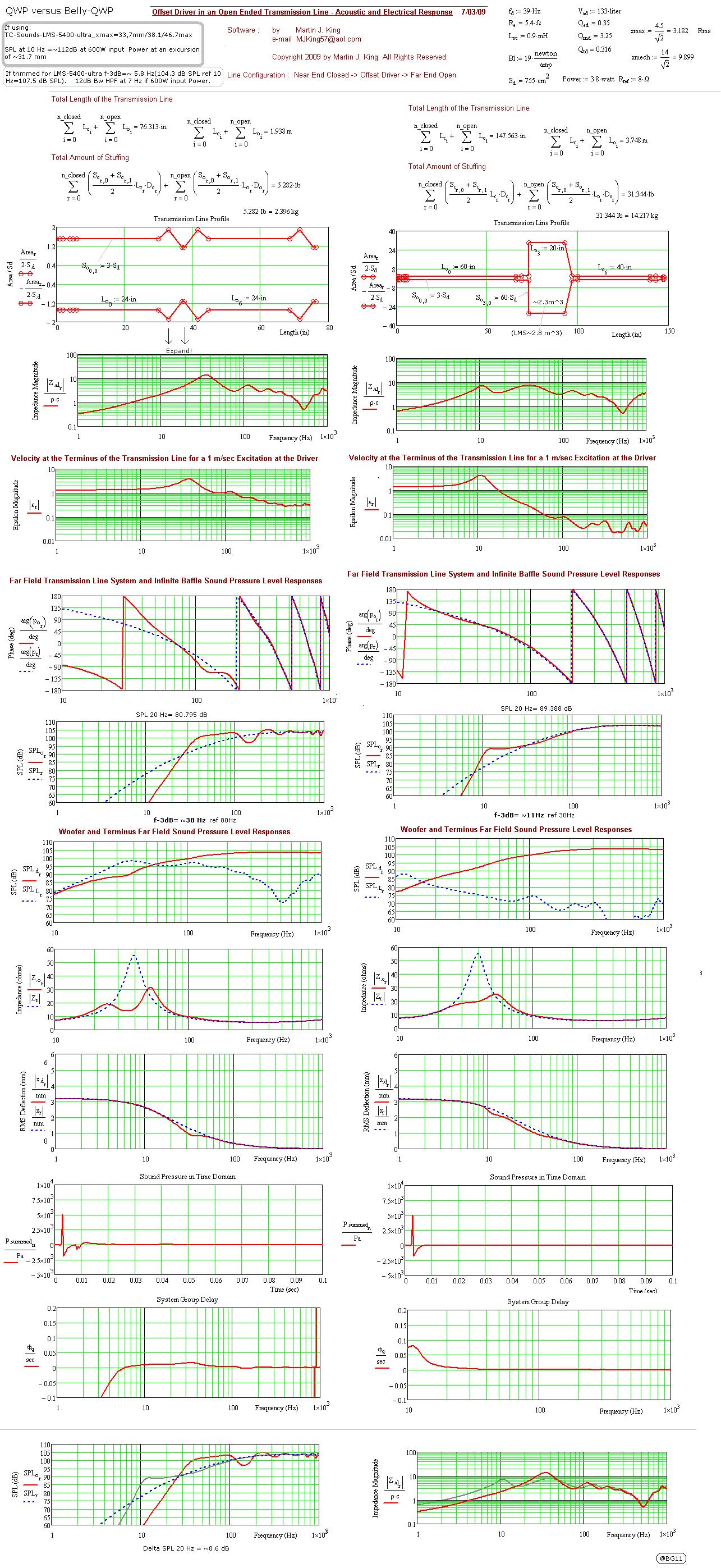

From Martin King:
"Atlantic Technology is using custom versions of my MathCad worksheets to
design the H-PAS enclosures. I wrote the worksheets for them and they are
doing all of the design work. Can't say much more."

From Martin King:

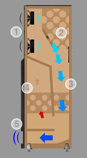

Isn't the 'secret' that it is just a TL, but with a 'jug' that resonates and adds like the holliman, and not as a helmholtz that reduces?
quote: "that serves to null the unwanted primary resonances of the main line." kinda sounds iffy to me...

I took it the other way jbell, that the "jug" is an absorber to smooth the line resonances or harmonics but I don't know much 🙂

The enclosure looks like a normal reverse tapered TL. I can't see
how it any different so his explanation on the link New Page 2 should
apply to any such TL if he is right. The "jug" appears to be at one
fifth of the line length, maybe one third even, and the speakers
at the end. The "jug" is where you might mount the speakers
in another design, although this would normally be done at the
end of the first fifth (third) rather than the last fifth(third). At
such low frequencies do the fundamental waves see the jug as
anything but an extension of the line?

It very well could be... however there are other simple ways to smooth a response spike, like danley does with a bit of pvc pipe in some of his TH.
However if that is all the h-pas has going for it -- I'd have to agree with the post above -- it's nothing remarkable.

Yeah, looks to me like just another innovative variation of a double bass reflex [DBR] same as the G-H contraption.
GM

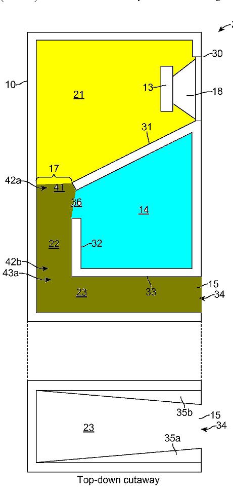

Phil Clements describes it as an Inverse Horn, with Resonance Distortion Reduction.
Looking at & reading both Patents, & other published material about it, i would describe it as this.
Transmission Line, with internal Frequency Trap ( as in bass etc traps ) In this case the FT is designed to filter a higher frequency, such as for eg the 2nd harmonic etc of the drivers fs. The FT enclosure inside the main box, also appears to act as additional Internal Volume to the main TL volume at the Trap Frequency. Thereby acomplishing something akin to a Double Chamber Reflex enclosure, whereby you have two fb's in one.

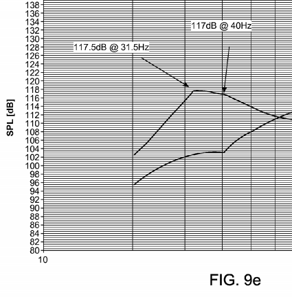

What i found hard to swallow, was the claim in one of the patents that 117dB was achieved at 31.5Hz with a 5 1/2" driver with only 1 Watt ! From what i could gather, the raw driver itself was rated at around 92dB or less at 1 Watt. So where does ALL the extra, at least 25dB come from ? The Atlantic Technology AT-1 which uses PC's H-PAS, is specified as only 89dB sensitivity. It doesn't say at 1 Watt, but i'm presuming it is ? As you can appreciate, there is a Considerable difference between stated outputs !
I'm NOT trying to poo poo any of this, just trying to establish what are the real Facts ?
Hi Zero D,
"....117dB was achieved at 31.5Hz with a 5 1/2" driver with only 1 Watt ! From what i could gather, the raw driver itself was rated at around 92dB or less at 1 Watt. So where does ALL the extra, at least 25dB come from ?"
Maybe that'll solve our "energy crisis". 🙂
P.S.: What are those patent numbers?
I asked Mr Clements to support/verify that very point this past Saturday. Maybe he will join us here and help us understand better...

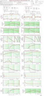

Has anyone posted an Akabak model of this? I can't see any reason that Akabak couldn't simulate it.

I think GM nailed it -- double bass reflex. No TL even involved.... (unless you consider the narrowing of the long port as a TL....)
From the 'fresh' patent..... page 1.
I think we need the ohm of the driver used... The language is suspicious on the "2.83 volt, what is normally considered 1 watt...."
Sounds like marketing speak when using a 2ohm driver.
