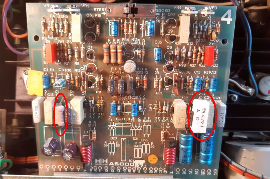

Dear friends! (kramtweeter, BSST, thermionic, and all the others)

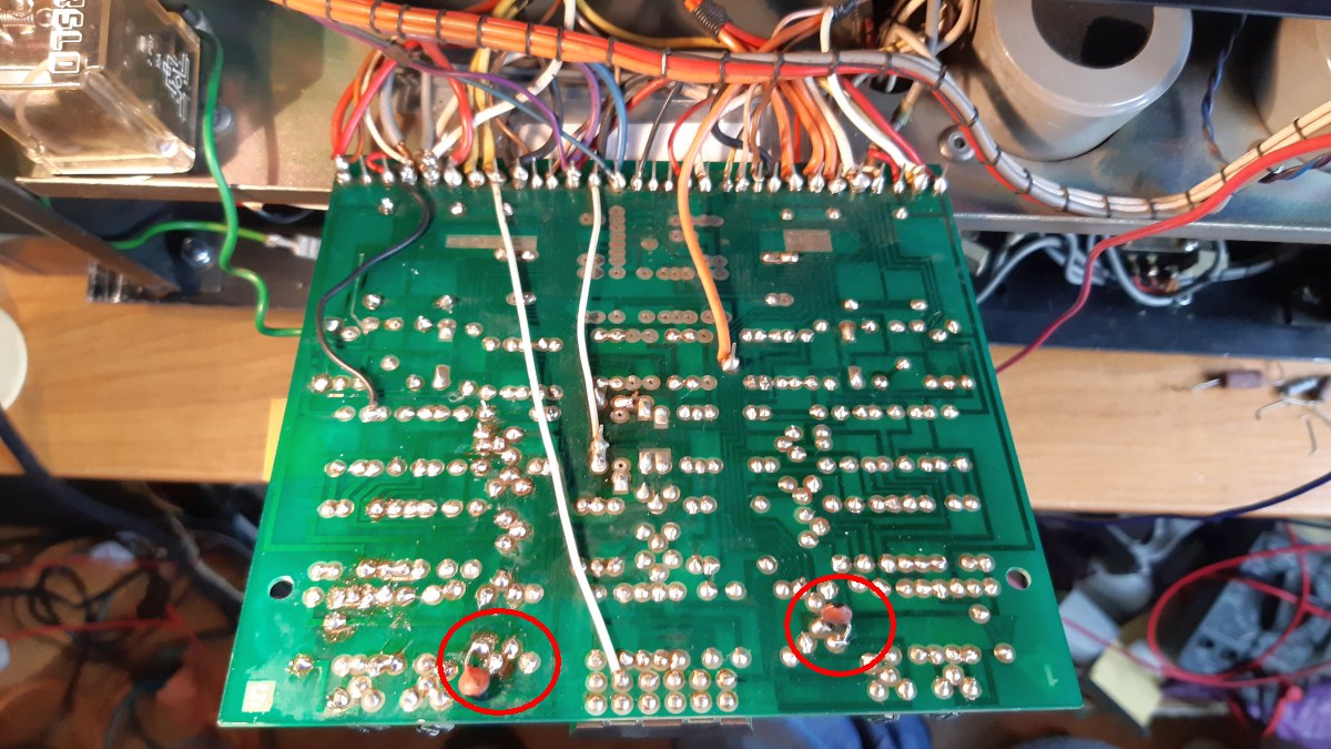

Thank you for all your help! What you said is the solution! The missing resistor from the Zobel circuit. I added a 4,7 Ohm resistor in series on the unaffected channel (as shown on the V800 drawing: resistors R20 and R38) the oscillation stopped immediately, I can't even detect it with an oscilloscope! I restored the experimental channel to the factory version, also the 10pF VAS Miller capacitance, still good! Only I didn't restore the C4 capacitor to the factory 22pF (left the 10pF) because I still need to put together a pulse generator to see how stable it will be under load. Perfect with sine wave 🙂 Thanks a lot my friends. One more question: how to set the quiescent current? I don't have Source resistors on the FETs to measure voltage drop (I don't even know how much quiescent current is needed for this device).

Thanks to everyone who commented, without You I don't think I would have found the error! I don't know why they could have left the resistance out of the Zobel tag, as it was still there in the early version. It is incomprehensible. But the point is that everything seems fine now, the amplifier seems stable.
