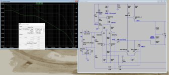

valgamaa had it. get a 33-47pf silver mica for the Q5 (miller cap) and 5-10p for C4. This amp is one of my input stages for "slewmaster".
No one simulated this ? I have even built it (slewmaster) , forgot where the inspiration came from?? Can't believe they were relying on the VAS BJT's Cob
and then using an oversized lead compensation cap to cover up a bad design. Ceramic caps ! Blasphemy !
You end up with a typical 735Khz unity gain circuit with 93db phase margin - quite stable. 10pF (miller cap) in my simulation resulted in 1.6MHz oscillation.

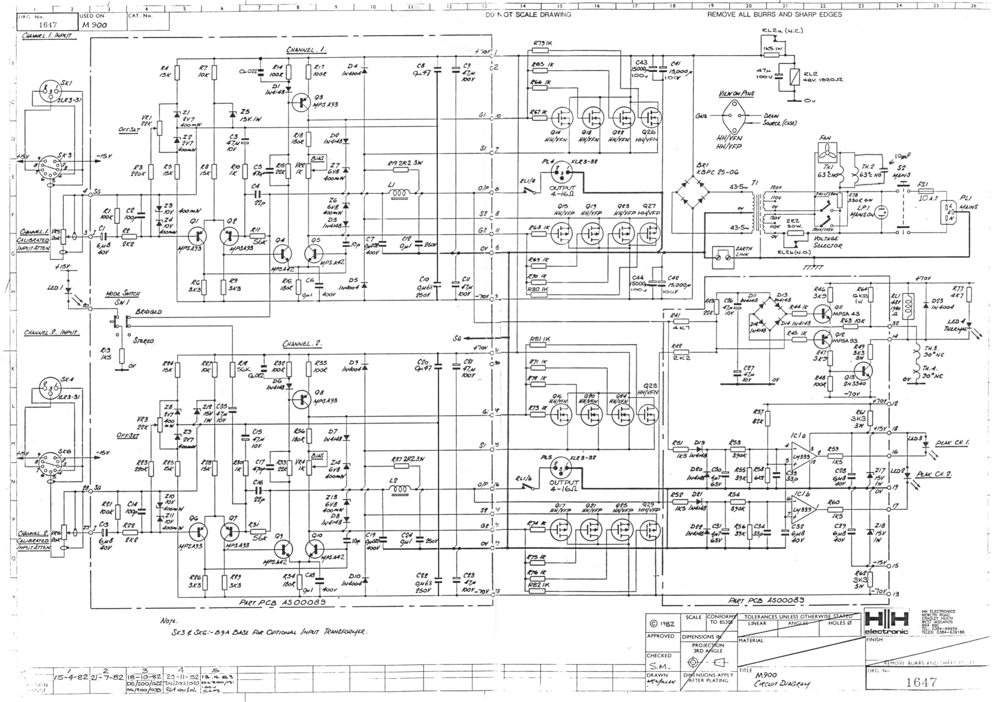

Would you post a drawing that shows the entire amplifier? At first I was alarmed that I couldn't spot a DC connection of SG (pin 4 at board edge) to "ground." Eventually I found another SG path that led to the power supply. Is this connection a wire connection across the chassis?
I share suspicion about the lack of a proper Zobel network.
How do we know if the oscillation is due to "global feedback" vs. a local inter-stage oscillation? As an experiment, I suggest installing a short across R10. That should establish working bias, but let the amp run with full open-loop gain; I believe global oscillation will be precluded and any remaining oscillation should be localized instability.

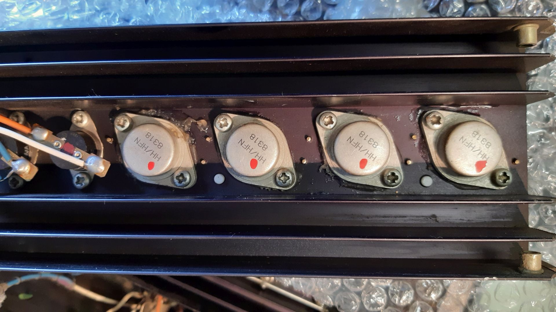

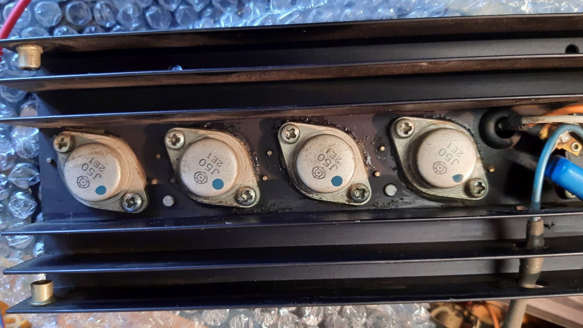

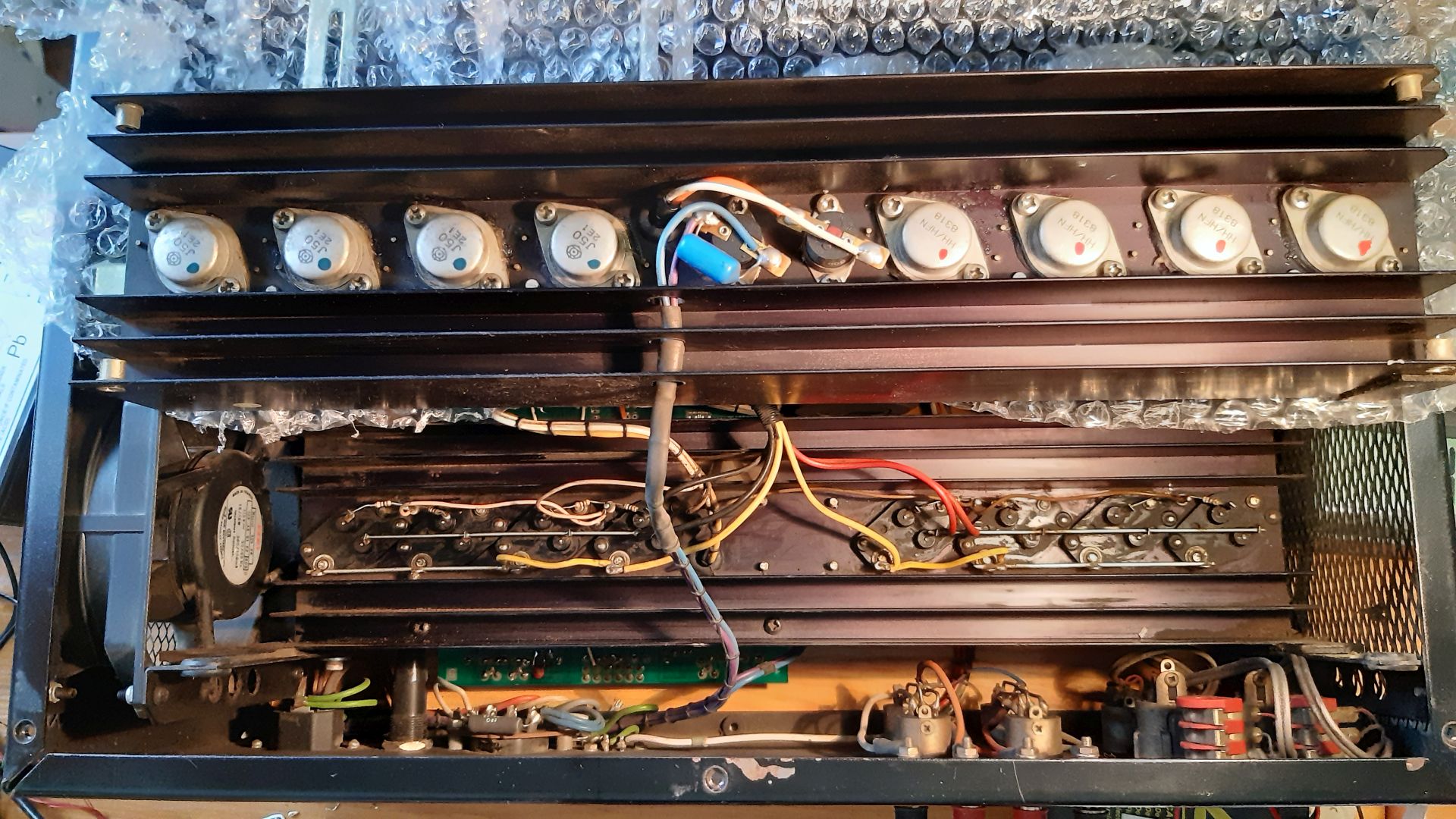

From your description, it sounds like the bottom half of the output stage is unstable. Try increasing the gate stopper resistor values on this half and see what effect it has. i.e. R68, R69, R70, R80.
If there are connectors involved in the connection of the output transistors to the main PCB, make sure they are all good. Also make sure the output transistor screws are not loose.
Oh yeah, from the pictures, it looks like the output transistors are in sockets. That might be problematic. You could try removing the bolts, levering them up, pushing them back down a few times to improve contact.
If the Laterals really are in sockets, then that alone strikes me as an oscillation risk... But it does make it easy to test them. Assuming that you have a basic transistor tester, I would take each one out and test it. A simple unit such as the Peak Electronics unit will do this - I've used it for laterals before.
Thank you all for your suggestions!

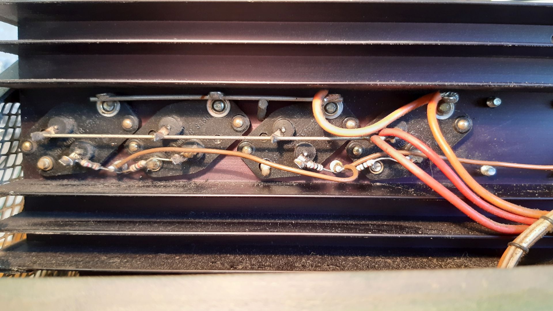

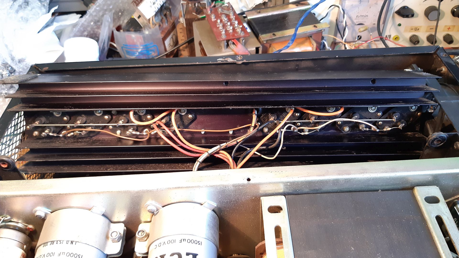

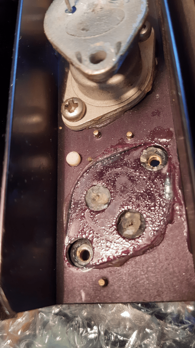

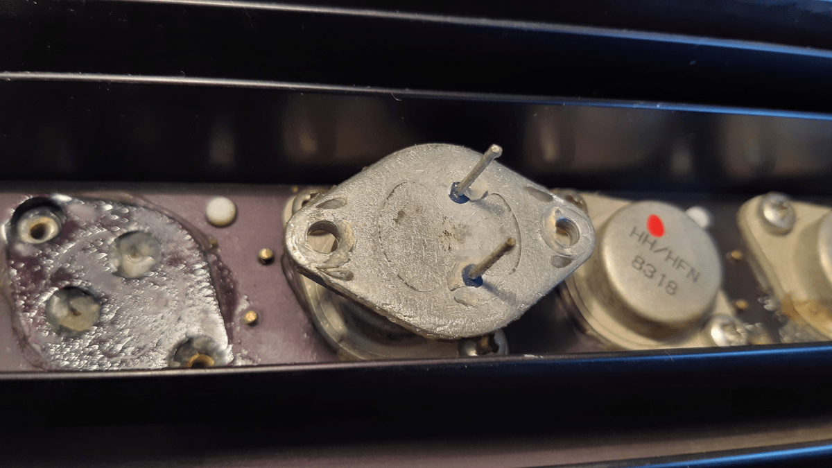

Yes the FET's are in sockets. There is no isolation between the FET's case and heatsink, so there are two large heatsinks, each mounted with 4-4 MOSFET pairs, and since the case is the SOURCE terminal, the heatsink is directly the speaker output of the two channels. The heatsinks are rubber-bonded to the case in parallel, I suspect there is at least 100pF of capacitance between the two channel outputs. Perhaps that is why both channels produced almost the same phenomenon, at almost the same frequency and amplitude. BUT, after the changes described in https://www.diyaudio.com/community/threads/h-h-v800-mos-fet-amp-oscillating.397284/post-7305601 post, the oscillation on the channel in question was greatly reduced, but regardless, the other channel (the one in its original, untouched state) produced the same oscillation, so I guess it could be a case of aging of the FETs, since both channels, independently of each other, produced the same thing.
These are 40-year-old parts, so who knows. Another thing is that the area between the FET case and the heatsink is filled with silicone-like material due to heat transfer, the MOSFET's GATE and DRAIN terminals are "sitting" in the grease. I wonder if this grease-like material might become a bit conductive after 40 years? Lots of possibilities 🙂
Do you have a tester? Like this: https://www.peakelec.co.uk/acatalog/dca55-atlas-dca-semiconductor-analyser.html
My advice is to go through the FETs one by one, making sure that they are ok. I don't see the 40-year age being a problem. Driving sub stacks at festivals for 4 decades is likely to have taken its toll, as it would do on any amp. If the FETs test ok, I am sure they will be ok. I would be most concerned about the mounting, and ensuring that the insulation hasn't broken down.
Unfortunately, I don't have one of those testers. Actually, the device works, but the oscillation at the output -visible only with an oscilloscope- was disturbing. There is no isolation between the MOSFETs case and the heatsink, the heatsink is galvanically equal to the output.

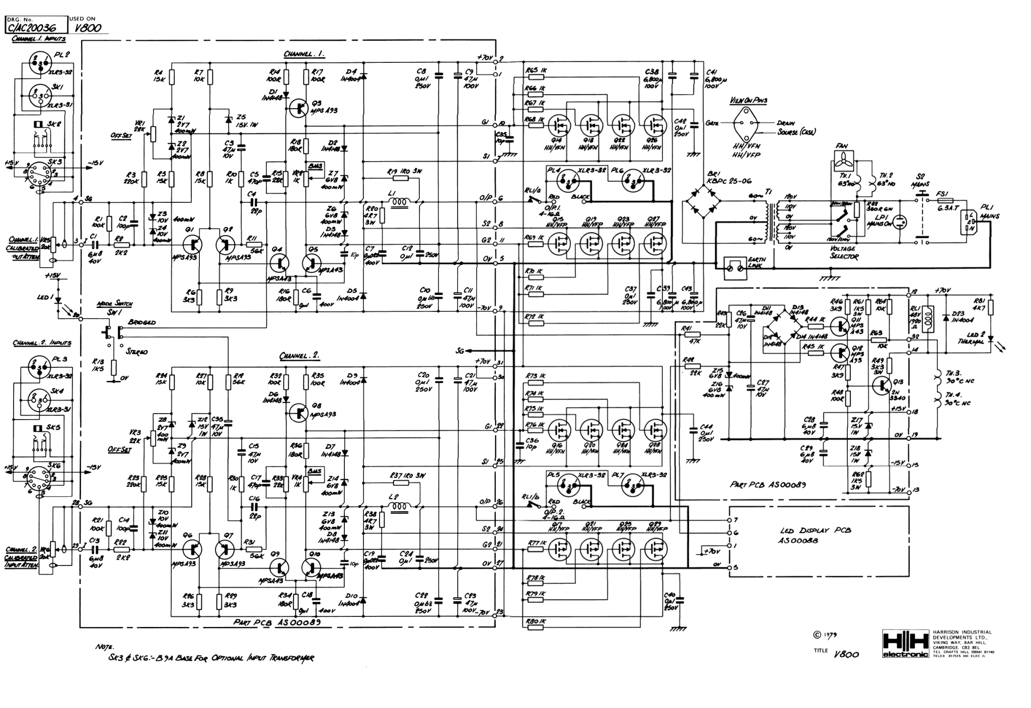

...and the schematic of the V800 (This seems to be a slightly earlier release, the amplifier part of the actual unit looks more like the M900, but of course the I/O connectors and the LED level meters on the V800 wiring diagram are shown in reality)
Hi mickeyratt,
Thanks very much for the big view on the schematics.
IMHO, the V800 shown in post 49 is closer to a reasonable design. Am I correct that your amp doesn't have an R20 site in series with C7, i.e. no provision for a Zobel network?
The frequent revisions of the amp's compensation suggest the manufacturer struggled with stabilizing the amp. I can't reconcile the argument that the proliferation of these amps proves they must have been reliable, but the frequent design tweaks focused on compensation seem telling.
The presence of C4 shunting R11 suggests the designer wanted to extend the closed loop bandwidth, but many other design details conspire to restrict the bandwidth: eg. relatively large gate resistors (R65-R68, etc.), C6, C22, C7, C18, C11, C10, C35, cap at Q10 b,e. I get the impression that many of these components are unsuccessful attempts to suppress oscillation.
Simply stated, the open loop amp should be designed for maximum bandwidth, probably constrained by the gate resistors needed to prevent self oscillation of the MOSFETs. Typically, then a single (Miller) capacitor is used to lower bandwidth enough that unavoidable phase shift from the output stage doesn't intrude enough to provoke oscillation. More later.
