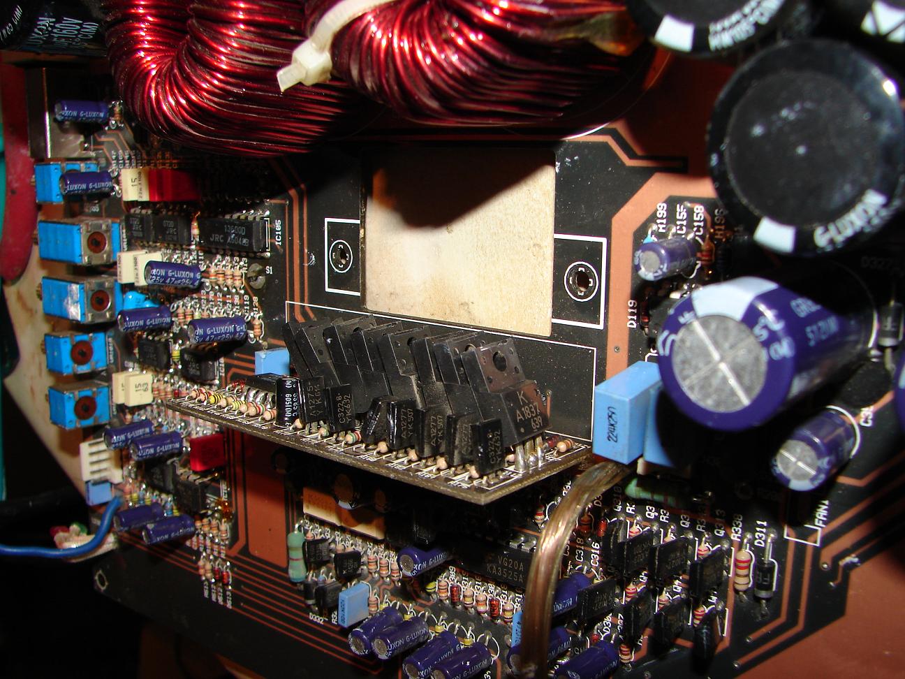

hello, i have a Ground Zero GZPA 1.4000D it is a class D mono using IRFP264 in the output ...
after some trouble with a 220nf capacitor on the input side i blew a irfp264 (leaving the amplifier on without a heatsink for a lot of time does that

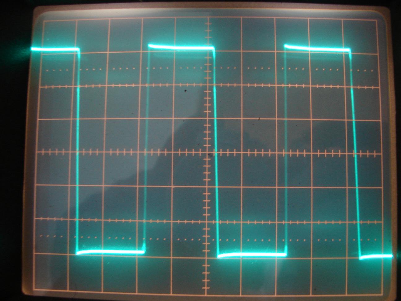

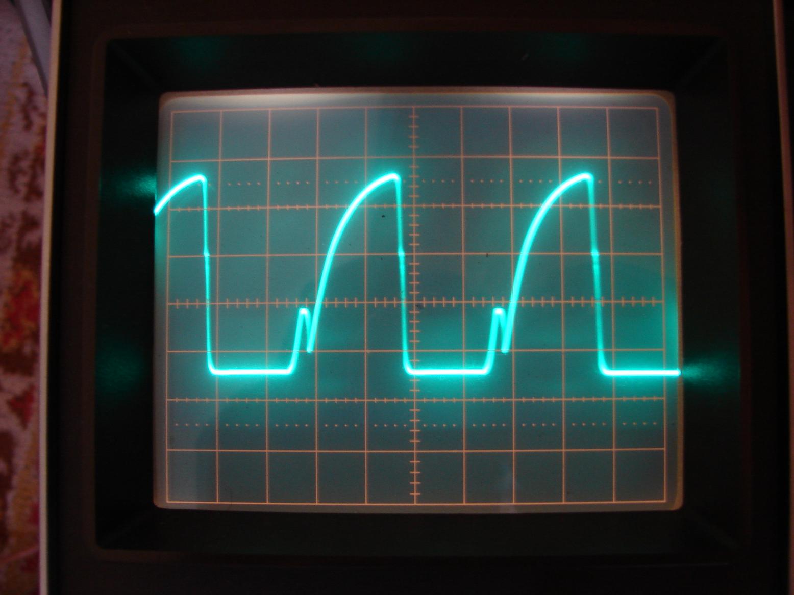

i replaced all outputs with irfp4229 and looking with a scope on the gate it looks like this 😕 it should be a square wave ?? it actualy looks like a triangle ...
the output of the fets is square....
i did apply power and loaded it on 1 ohm woofer playing music and it blew when i turned the volume up ... at about 1000-1500W ...
all irf3205 are dead and 2xirfp4229 ... i replaced the irf3205 and it works again ... any ideas on why did it die ?
the scope in the first pic is 2v/div ...

I figured out that the configuration is half bridge with 5 MOSFETs paralelled (originally).
Interesting gate drive signal.
Could be they have a resistor on/ diode off circuit in which case the gate on drive will be a bit slower to stop cross conduction.

Waveforms look perfectly normal for car-subwoofer grade class D. Were you expecting something better?
100 ohms is not a low value, but the first limiting factor for "switching speed" is PCB layout, MOSFET limitations (like body diode limits) only play a secondary role in that kind of amplifiers.
In fact, sad truth is that you may manage to make it work with IRFB4229 by further increasing gate resistors to 150 or 220 to reduce di/dt to the levels that the PCB can tolerate without EMI becoming self-destructive 🙂 Reducing gate supply voltage a bit (keep it >9V) does have the same effect but it has to be done with care because other parts of the circuit could be disturbed.
Note that, although IRFP4229 is quite similar to IRFP264, it has 2 to 3 times higher transconductance than IRFP264 resulting in about 1.5 to 2 times higher di/dt (transconductance is higher but input capacitance is also a bit higher too).
Driving the gates with square-like waves only makes sense in resonant circuits (like in a push-pull SMPS with proper dead time) or when there is other means to control di/dt.
Are you sure? Notice that falling and rising edge on output are very different! This can't be normal! If the slow one is normal, then the fast one is not.

I was talking about the gate waveform. It's true that the fast rising edge in the switching waveform is telling "risk of overlap, more dead time on that side please", while the other looks more or less right (could use less dead time).
However, have you ever repaired one of these? They are intended for LF output only, >250Hz, switching frequency is usually in the 50khz range, and the discrete gate drivers they use are ugly. Many use electrolytic capacitors in the output filter, and nearly all use either pre-filter feedback or no feedback at all 😀
So what I mean is that good symmetry is not even attempted, and at the low di/dt rates they operate (mandated by dumb PCB and junk MOSFET) overlap for a few dozen ns is not really a problem. They may take a whole microsecond of overlap to develop destructive currents.

Turn-on current is the range of 80 to 100mA, while total gate charge is around 500nC. Simple calculation gives a total turn-on time of around 5-7us for around 20us period.
Ergo: the wavaforms look perfectly like the 'designer' wanted them to.
Good news is mosfets are pretty forgiving here, the 99% of transition takes probably more like 1.5 to 2us, the rest is sub-threshold charge and post-miller charge. The first makes no harm at all, the latter results in just a bit higher effective Rdson.
I haven't met with these, but a switching event lasts for some microseconds sounds to be a nightmare for me. And with the original MOSFETs it must have been much worse. With 4*50 nC miller charge the switching transient must have been more then 10 us long. This would be almost fully linear operation, not ClassD!
Well, you get the idea now, but switching events don't last that long, a few hundred nanoseconds would be more accurate. Yes, charging the gate to the full drive voltage can take a few microseconds, but IRFP4229 is already fully on at 6.5V and IRFP264 is similar, so it's not that bad.
Consider that the PCB is good only up to 50A/us per MOSFET or so, so building up the current has to take some time (achieved just with 100 ohm gate resistors and relying on finite transconductance). Not much to do with our >500A/us switching.
