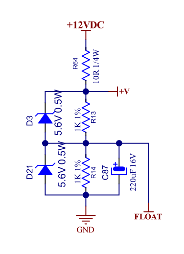

The 'float' network is the bias point for the audio circuit. There have been many times when one of the two 1k resistors in the voltage divider go out of tolerance and that can cause various problems so it's something I recommend checking. The networks vary. Some have the diodes, some are just a series of 3 resistors coming off of the 12/15v regulated supply. The attached image is just a generic example.

Fixed it.
I got frustrated and changed every diode, resistor, capacitor and element in the Feedback section.
Works fine now.
I bet one of the those elements got out of tolerance once voltage is applied or something like this (measuring it while not turned did not show up anything on the MM.)
