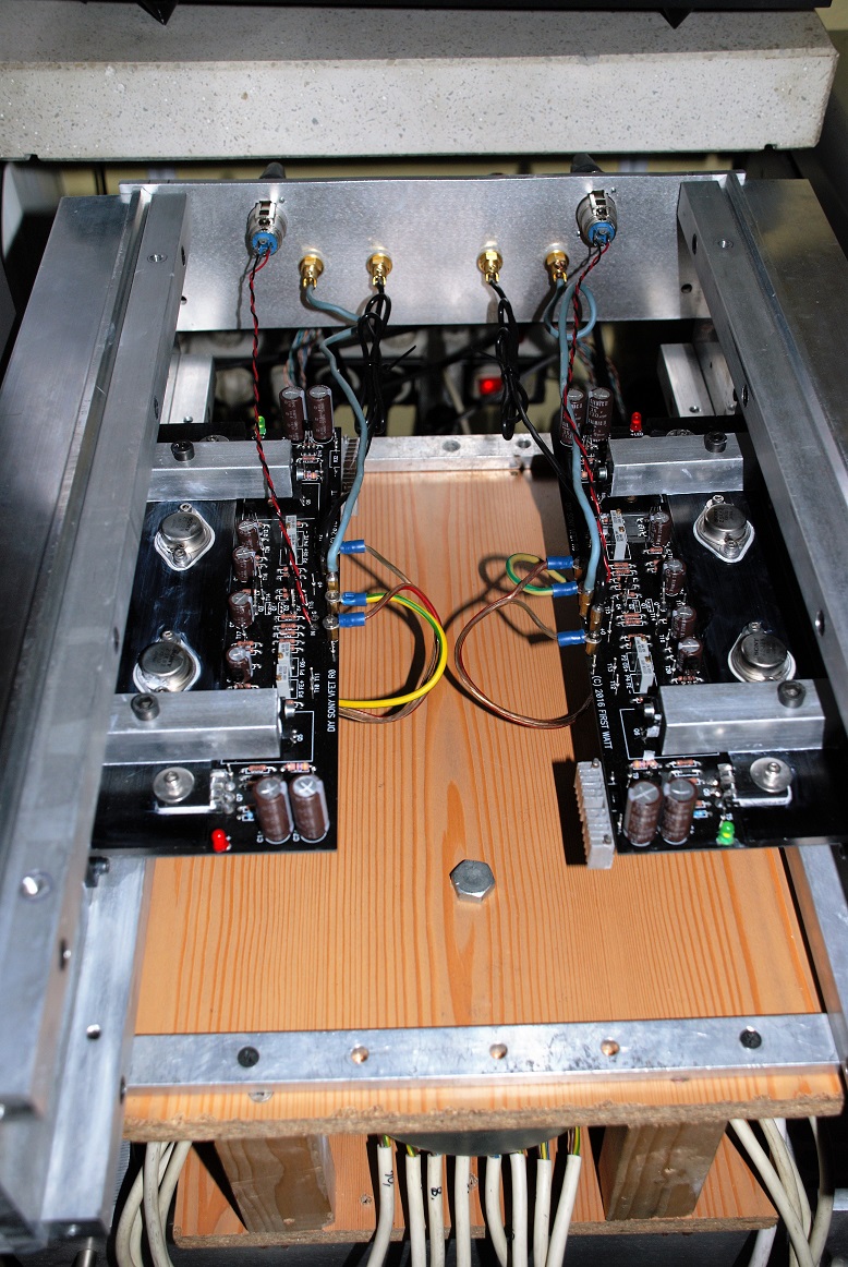

i build this one with fews new to me resistors :
Texas Company Components , Vishays bulk foils...let's give a try.
Do is worst ? Anyway is fun 🙂
Detailed DC measurements:
left: right:
T6 to T7 = 1.6260 T6 to T7 = 1.5630
T8 to T9 = -1.6140 T8 to T9 = -1.5680
T7 to T10 = -2.024 T7 to T10 = -2.041
T9 to T12 = 2.063 T9 to T12 = 2.019
T6 to T11 = -6.807 T6 to T11 = -7.025
T8 to T13 = 6.742 T8 to T13 = 6.933
G to T2 = 24.52 G to T2 = 24.52
G to T6 = 29.43 G to T6 = 29.35
G to T8 = -29.32 G to T8 = -29.20
G to T14 = 13.980 G to T14 = 13.970
G to T15 = -14.000 G to T15 = -14.000
G to T17 = -7.399 G to T17 = -7.416
G to T19 = 9.689 G to T19 = 10.076
G to T16 = 8.201 G to T16 = 8.164
G to T20 = -9.205 G to T20 = -8.806
G to T10 = 25.72 G to T10 = 25.72
G to OUT= -1mV G to OUT= 1mV
G to T18 = 1.1720!! G to T18 = -0.860!!
V+ =29.9 V+ =29.9
V- =29.9 V- =29.9

G to T14 and T15 is ~50% of the rail voltage. That's good, and as expected.
G to T18 can be zeroed during the test with very small adjustments of P3, but it's not that critical.

You know, what I don't like, T16, T17, T19 and T20.
I don't know, these value are depending on parameters on VFET or not.

Those specific test node measurements have a very wide range of acceptable.
Your measurements are good. 😀

Anyway, if I can understand it correctly, I can set anything to anywhere, while I can maintain 100mV across R32.

Hi Gyuri,
The way I see it, the main things are to get T18 close to 0, while getting voltage drops across R5 and R6 near 1.5V and drop across R32 around 100mV when your amp
is warmed up. The final values for T16 - T20 I think will depend on your vfets
so I wouldn't worry too much about them.
