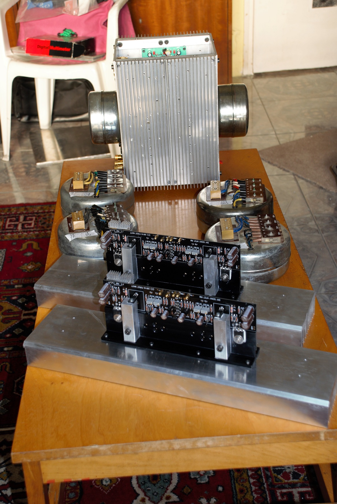

So where I'm with these?
All of the parts are in place, except VFETs.
Testing Part1, Part2, and Part3 was done.
Everything was O.K..
Frontends sucks about 55mA. 5.5mV/0.1Ohm.
Voltages are set.
Even at T18, (front end output) although it is a little bit funny.
If I blow some air on input JFETs, it can change more than 0.6V.
I give back that suspicious tranny, and get another one(s).
I have four of them now.
I think these are O.K..
They are sucks currents without load, as follows here:

You know, I wouldn't trust in my luck.
I'm a fearless BA builder, for sure.
However in this case I'm more careful.
Above I was whining about FE DC offset settings.
Everything was simple and straightforward, except this.
Papa wrote it:
"If it looks reasonably stable over a period of time, then we are ready for the final
assembly and tests."
and:
"Keep in
mind that this is a good time to get these values and a low DC offset right. It
becomes a little more complicated when the VFETs are installed and the
feedback loop starts working."
Voltages at R5-R6 and T16-T17 are O.K..
Randomly changing DC offset at T18 not O.K. for my opinion.
It changing more than 1V, if I blow some air on JFETs.
So VFETs remains in the box for a while.
I would like to know, other builders experienced a similar occurence?

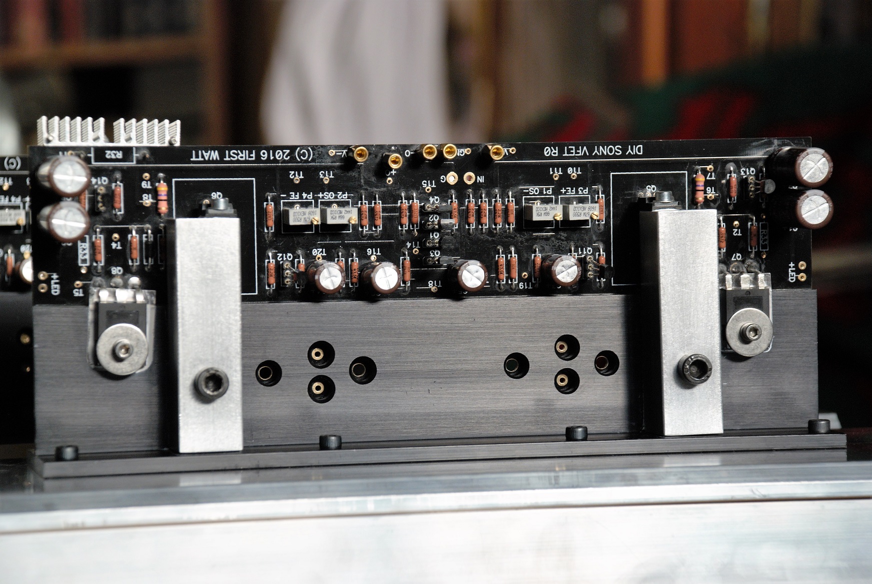

Forgot to say, a very slightest change at P3 or P4 results a couple volts change at T18.
Is this normal?
I'm using this 20 turns trimmer at P3-P4 position, I think it is not the crappiest one:
http://hu.mouser.com/ProductDetail/BI-Technologies-TT-Electronics/67WR500LF/?qs=sGAEpiMZZMvygUB3GLcD7jZSyzxDqivkG93jEX1vRMU%3d
Is this normal?
In my opinion, the phenomenon is closely related to the temperature of JFETs.
Even heat radiated by my hands near JFETs, causes changing DC offset at T18.
