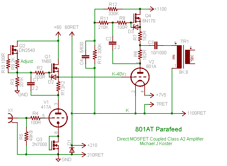

Well I guess great minds think alike. Here's what I'm wiring up on the breadboard. The MOSFET (actually a sort of IGBT) on the output is a so-called anti-triode which shares the load 50/50 with the 801A. The 801A sees 2X the Zpri of the OPT, in this case it sees 16K. If I can get close to 1000V P-P swing on the anode I should get about 15 watts Po. I will need to drive the grid to +30 to do this, using the A2 drive circuit recycled from the 4-65A experiments.
I thought a good use of the anti-triode would be to help lower the circuit impedance of a high impedance triode like the 801A, which I believe is similar to your VT-25. Actually I think mine are VT-62s.
Maybe I can modify this to try a constant-current version of the output instead of the (now) constant voltage. It would be interesting to compare notes. I'm running the 417A at ~170V/12mA

Michael Koster said:. . . . I'm running the 417A at ~170V/12mA
Hi Michael, Do you in fact have three power supplies?

Hearinspace said:Hi Michael, Do you in fact have three power supplies?
It's a clever design, but it needs three supplies so that it can be direct coupled throughout. The 1100 and 60V supplies are stacked on the 210V supply.

OK, to clarify, the 210 and 1100 are stacked for direct coupling. The third supply (60V) is needed to drive the grid positive for class A2 and could be derived from any source e.g. screen grid supply if you had a pentode... BUT arranging it this way provides a direct return path to the cathode, therefore grid current does not have to be dealt with in the current loop of the driver anode or the power tube cathode. The 60V supply in my breadboard amp (common to both channels) consists of a toroid, a bridge rectifier, and a capacitor ;-) Also of note is the 210 and 60 supplies can be shared in a stereo amp because there are no common return current paths to induce crosstalk. Eventually the MOSFETs should probably be cascode for better PSRR but it's very good as it is.
Michael
PS if you trust the isolation of the MOSFET active loads on the outputs, then all the power supplies and filters can be shared in a multichannel amplifier
