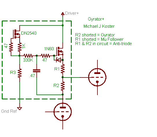

Here's what I would find useful as a modular bit of circuit, enclosed
in the dashed box. The current through R3 sets the DC voltage
to the gate of the anode load, and thereby sets the grid bias
voltage of the following tube. The mode of the output can be
changed by stuffing R1, R2, or both.
Michael

Why use a gyrator in a PSU? Really bad idea!
Better to use a capacitance-multiplier. This way you get low output impedance and don´t need expensive, high-quality caps at the output. Only a small plastic. The same amount of parts are needed. Ripple will even be lower or on par.

Michael, noticed you had to many components in your circut above. Remove the 330k and make R3 330k instead. It will not be much current through the DN2540 so one might choose a smaller one(LND150?).
revintage said:Michael, noticed you had to many components in your circut above. Remove the 330k and make R3 330k instead. It will not be much current through the DN2540 so one might choose a smaller one(LND150?).
That would work fine but I also wanted the option to use a zener etc.
in place of R3 for more stable voltage setting if needed. It could be
used at a lower voltage that would make the resistor value too small,
so I added the extra resistor.
This is a candidate for a PCB so I wanted to have some options in
stuffing.
Michael
OK, got it😎 ! Why not make place for another resistor above the 330k/zener as to make it possible to arrange shunt-regulation.

My opinion is, it is ready for production. Some extra holes and traces may be added for different variants of current sources, but not necessary, if you are going to supply parts with PCBs.
