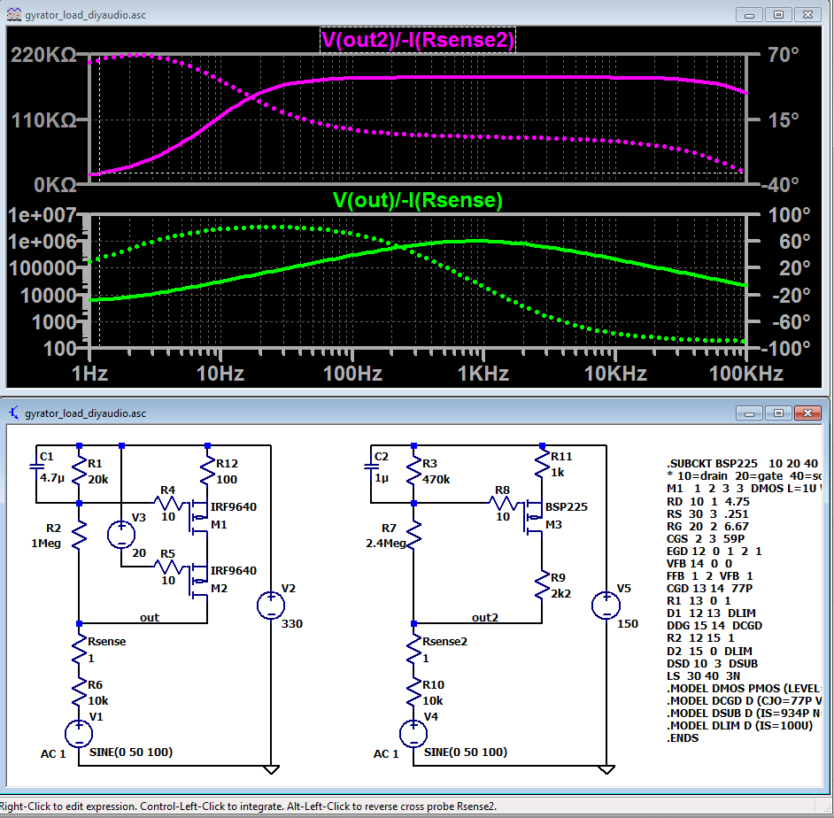

Gyrator impedance vs frequency
An inductor will act as a high impedance to AC but a low impedance to DC, in other words if you slap an inductor onto the plate of a tube or something, the tube's bias will determine the current through the inductor.
Since an inductor doesn't set the idle curren't it doesn't set the idle plate voltage, unlike a current source where the plate voltage must be determined by the current set by the current source due to ohms law.
A gyrator as I'm assuming we're talking about, is an electronic inductor. It can't swing beyond the rails like an inductor, but it will present a high impedance to AC without affecting the idle current.
Really? Talking about the two circuits I posted: the mosfet set a crude but real voltage reference, then the two resistors attached to the gate, which make a voltage divider, can be used to vary the anode voltage. Am I wrong?

You're mostfets are Pcan with a fixed voltage on the gate and the high impedance end facing the load so it will function as a current source, not a gyrator in that configuration.
If you want to make a gyrator with the same complexity of your circuits you want something like this
The current source ensures a stable voltage across the R3
The mosfet is a source follower so it sets the voltage and the capacitor allows AC feedback to create a high impedance at AC.
You can take the output at either side of R4 depending on how much you want to load the triode or whatever your connecting and whether or not you want the signal current to enter the power supply.
Taking it above the resistor keeps a constant current on the load and lets the mosfet drive the next stage. Taking it below the resistor removes the constant current from the load but ensures the signal current does not enter the power supply.

Oh haha, I guess I am blind afterall, yeah that's a gyrator, I totally was not paying attention to where the divider was feeding.
The resistor divider + capacitor combined with R4 allows for AC feedback from the output to ensure that the VGS voltage is the same at AC so the AC current doesn't change. Think of R4 as a resistor load for a source follower, it will try to keep the VGS voltage equal and an unchanging VGS on a mosfet means a constant current.
Feeding the divider to the output also allows the idle current to be set via the load instead of the gyrator because the load resistance is part of the divider.
But changing the divider should still cause the gyrator to change the idle current somewhat. Seems way too flimsy for my liking but it will work in a pinch.
But that gets us back to the first post.
In #9 (Gyrator impedance vs frequency) the simulation shows that it only acts as an inductor at very low frequencies, where the impedance is reactive.
See the top (magenta) trace. The phase is just close to 90º (voltage leads current) for very low frequencies. Then, it acts as a simple fair CCS, ok for low internal impedance tubes.
The question I was trying to ask in this thread from the very beginning is: is this the way the circuit is supposed to work?
As I've explained the intent of a gyrator for audio purposes is to act as a current source at AC and a voltage source at DC.
To my eyes the magenta circuit is functioning as expected, acting as a high impedance at audio frequencies.
The green circuit was missing the source resistor in the first few posts and it is not optional, the circuit won't function correctly without it for reasons I explained in my last post.

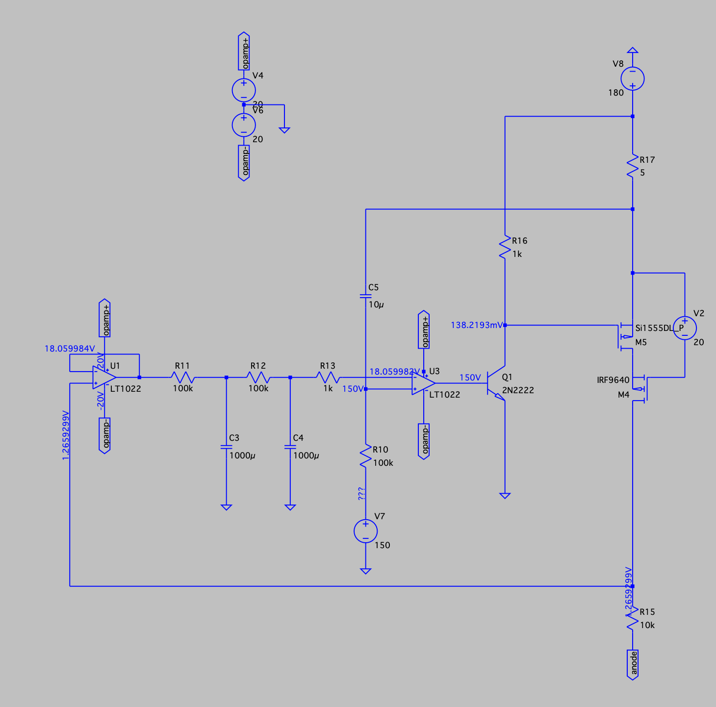

I just conjured it it up in a few minutes so not optimized or anything, not tested IRL.
I once made one that simmed terraohms impedance but I'm too lazy to find the file and no one needs that much. This one ends off at 4 megs @ 20k, plenty.
I like this design and it simulates, but how do you avoid popping the opamps with a large voltage across their terminals? I've attached my simulation - perhaps you can see where I'm going wrong...
