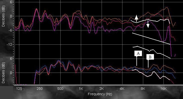

To my surprise I found an old measurement I´ve done myself recently posted by IngOhman on the site where he does most of his marketing.
Strangely it has been manipulated or "corrected", as he claims, for a imaginary microphone-curve that suits his taste better by a hand-drawn line..🙂
The "corrections" drawn on the curves representing a compared speaker are different done!
However, regardless of how the individual curves in the measurement should be interpreted I think they gives interesting information, compared to each other, about dispersion characteristics.
The upper set of curves regards speaker is Ino pip which i think is comparable to Guru qm10, and the lower set shows my own speakers with ATC/Stage Accompany drivers.
I think the curves shows 0, 15 and 45 degrees angle.
You are wrong about close to everything there Patrik.
Why do you behave like this?
The only thing I saw that was correct is that YOU did the measurement (with a "toy microphone"), and I stated that in the posting, as you know. Neither did I make any secret of the fact that I have added the correction curves (by hand), nor have I erased your original flawed measurements. Everything is there to view for any one interested.
And as you know (but continues lying about) I do not do any marketing what so ever.
If I start some thread on an internet forum, it is close to never about Ino (nor Guru or Carlsson) speakers. And before internet, I was writing articles for the same reason, for MANY years, and I can assure you - most subscribers of Music & Audio Technology did not even, after the first 6 years of writing from me, know that I vas making loudspeakers! Nor did they know that there was a brand called Ino!
I've never used any magazines nor internet sites for marketing, simply because it has not been in my interest* and there has certainly not been any need for it! It is a quarter of a years waiting list to even come and listen to Ino speakers. What good would marketing do me? I have no ambition to expand what so ever.
On the contrary - I'd love to have fewer people trying to reach me to buy speakers! 😉
(Why else would I be writing on a diy-forum, where there is close to a guarantee that no one will buy any speakers? I write here only because I got the impression that there were people here asking questions on the Guru speakers, and it is my general experience, that people at diy-foras are intelligent and knowledgably, and therefore are worth discussing with, since it is those persons understanding the basics about audio, that has the potential to help making the world of reproduced sound better.)
On the swedish forum Faktiskt.se, I have been writing close to 12 000 postings, and I it is not more than maximum a few percent where I´ve even mentioned my speakers! Close to all those times I’ve done so, it is because someone has asked questions about them, or has done what you do so often - brought them up to tell lies about them, or just generally tried to imply things in a very tendentious way.
Do you call ¨me defending myself from your vicious attacks¨ marketing??? That’s low, even from you.
The posting you are talking about from Faktiskt.se, was again in a thread I did not start. I only responded to questions asked about measurement on my speakers. Most of the curves did I post, was measurements made by other people.
Regarding the compensation I’ve suggested for your measurements, it is based on the compensation that was derived from the info on which microphones YOU said you used, and the analyses YOU did on them! i.e. on the clarifications that YOU were involved measuring! (Svante helped you figure out the errors of your measurements, remember?).
For any one speaking Swedish, this is the thread that the curve Patrik now (dishonesty) act like he has newer seen before 🙄 was first published:
http://www.faktiskt.se/modules.php?...ays=0&postorder=asc&highlight=stage&start=480
Best regards, Ingvar

PS. The first comment (the very first two sentences!) that Patrik Finn wrote 1.5 years ago when I first published
of the above graphs (that he now acts surprised about and pretend that he has not seen before) was:
Or in English:
(I've added an explaining parenthesis inside the quote, just so that no one has any questions on whos loudspeakers
he concluded was being wrong - his own.)
Originally posted by patrikf, at Faktiskt.se
Det är troligt att jag har dimensionerat delningsfiltret felaktigt med ledning av en förmodligt felvisande
mätmikrofon. De fel som har konstateras gäller diskantavrullning.
Or in English:
It is probable that I have erroneously designed my (own speakers) crossover being lead by a
measurement microphone being incorrect. The problem that's been ascertained is regarding
a roll of in the treble range.

It´s possible we have different views on what´s marketing🙂.
I made measurements with Behringer, G.R.A.S, Buel & Kjaer and Larson&Davis microphones with similar results. The common factor was that they were made with SIA SMAART which utilises two channel FFT.
It is more likely that the measurements with Smaart were influenced by the environment in which they took place than that all these microphones should have a common fault.
The frequency reponse of the Stage Accompany driver in not known to have the characteristic given by the home-made "corrrections" made in the "fixed" graph.
Parts of the difference between the two compared speakers in this measurements could depend upon different dependance of the "working envoronment".
My assumptions about crossover design in my speakers were hypotetical and due to a open discussion about the causes of these measurement results and has no relevance for this discussion .
My intention is not to compete about who´s speakers is best.
As i wrote in the previous post, the most interesting information about the Guru/Ino speaker(which is the topic of this thread) that could be extracted from the graph is that of its dispersion characteristics. Possible measurement faults should not vary between measurements for different angles and only on one of the speakers. The lower set of curves is furthermore consistent with other measurments regarding the ATC SM75-150S dome mid. For example those posted on ths site by ShinOBIWAN.
The results from this measurement MIGHT explain why rooms where these Guru/Ino speakers is used is recommended extensive damping.
Memory is a strange thing indeed. Fortunately, there are forum logs. I checked out the postings on the Swedish site and apparently you quoted and commented the image that you state surprised you (including the edits in white by IngOehman) on Aug 21, 2006, i.e. 18 months ago. The edits by IngOehman were done to show how the known errors of the microphones you used would affect the curves compared to a calibrated microphone.
IngOehman's re-posting of this picture was recently made in a new thread (on the same Swedish site) to show different measurements of his Ino range made under different circumstance by different people. It was illuminating to see how different things can look under different circumstances (anechoic vs. in situ, close vs. listening positioning, "dead" vs. "live" room, different smoothing and gating).

Kranis, there could be other reasons for being surprised than loss of memory 😉
Could you please explain these "known errors" in some detail?
As I wrote in my post above yours the conclusion that the measurement should be affected by the same imaginary "known error" on four different types of microphones is highly unlikely.
Instead of taking defence position by repeatedly paying attention to the shortcomings of the measurement that i already have pointed out, wouldn´t it be more fruitful to discuss what information COULD be extracted?
Or rationally discuss the measurements validity upon the dispersion patterns?
