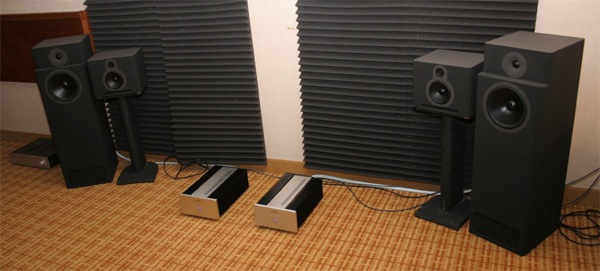

GURU Speakers
Why Martha,
it's a steal at $13K for the 4-pack.

Loving the huge step in the baffle for tweeter time alignment. I can see it now: "So you've time aligned the tweeter, nice work, but what about the diffraction and comb filtering caused by that surface right in front of its wave launch? Couldn't you budget in a 1/2" roundover or something?" and the guy goes "Erm..."
Sorry I'm being unduly harsh, I've never heard them nor likely too. But from appearances, for the money asked and from my own engineering sensibilities there's not a lot to capture the imagination.

The problem with these speakers is that the real performance is outstanding. They sounded much better than a lot of speakers at the show that looked mo' neato and cost a lot more. The guy in the interview was very friendly and was willing to share all of his data. Furthermore, he had a very good ear and was knowledgeable about music. I can see how someone who would be intimidated by a real professional could perceive him as being arrogant. The only thing he didn't know was the selling price in American currency. I found him rather refreshing compared to the other exhibitors and some of the boors found here.
So you know where the crossover point is? I think that may have something to do with it. With a high enough crossover point and the directional baffle, the high frequency wave may never see that ledge. His data, which as I said he gladly shared, didn't show any harmful residue.

Regarding the larger floorstanders. Well he's crossing to an 8" so ideally he wants to be doing so at around 1.5Khz due to the centre to centre spacing of the mid/bass and tweeter, thus avoiding comb filtering in the overlap region between the two. Also note that the directivity patterns of the 8" and 1" would become further dissimilar at higher crossover frequencies leading to poor power response.
Whether the XO point is a high or low, whichever way you look at it that step in the baffle is something to take issue with. Is it a problem? Well, did he show you on-axis graphs by any chance? Any problem may have been filtered out in the XO so it would be much more telling to see off-axis plots.
