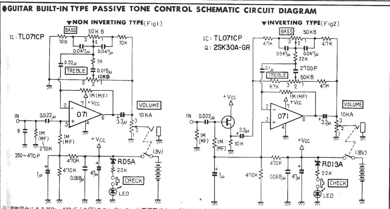

Ok I need to know what is the gain in this circuit (inserted in this post, the one in the left, the "non inverting type"), and how can I lower it, and if possible how can I make it variable. I connect another circuit (see the video in #91) at the output of 6, and as it is it seems to be a too strong signal for the second circuit...yeah I know I'm creating Frankenstein monsters here, but I did many and they're all ALIVE!!! In fact I kind of solved this with something strange, that is adding a 220k resistor at the input, but that alone create 2 undesired effect 1- it sucked the highs 2- messed with the tone controls. So I inserted in parallel to it a 3.3nF capacitor that bring the highs back, and changed the 1M resistor between 2 and 6 for a 2.2M to bring the tone control back...and it resulted all pretty well (I tried many values, off course)...but...what am I doing!?!? What monstrosities are this? Ooh! ooh...!
So, in order to stop this abominations...how do I properly lower the gain or lower the signal at point 6, conserving the tone control and original source frequencies (guitar)? Thanks!

Thanks rodbean, I get always a little angry at tagboardeffects page because they don't provide with schematics, hardly comment any modification, and I don't use tagboards.
I know people it's not hard for you the question I did in my previous comment, can someone aswer it?
