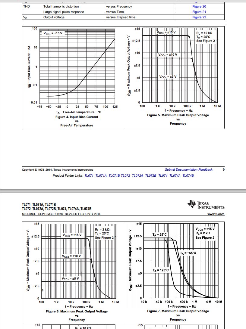

Not sure how much gain you need but I get about .8v to 1.1v peak out of my Strat when I hit the strings a lot harder than I normally would when I am just playing it.
When talking about getting as much as you can out of an opamp you can only get so much voltage swing out of them unless they are a Rail to Rail type.
The TL07x's are not this kind of opamp.
The data sheet will tell you how much of a voltage swing you can get vs your supply voltage (see picture).
Here is the data sheet,
http://www.ti.com/lit/ds/symlink/tl071a.pdf
IMHO opamp vs buffer, they are the same !!!
Typically you can have a buffer (opamp) that has 0 voltage gain (or a little bit of as in this case) and if it has a high impedance input and is it driving a low impedance output (as in this case) then it has current gain and is considered a buffer even the it is not increasing any voltage levels.
The term opamp is a type of amplifier called a operational amplifier and all amplifiers are considered a buffer of some sort or another!!
Also keep in mind that whatever output voltage swing you are trying to get, that the device you are trying to drive will only take so much before it starts to distort too.
Being a fellow guitar player I understand this completely and I have no issues about this.
But most amps won't tolerate much more that about 4v peak before this happens depending on the amp of course.
For most mixers this is another story as they are designed for such voltages swings.
I stated in another thread what my Mackie 32-8 is capable of but I don't remember exactly what my as measured voltages were at this time so I can't quote them.
But it does use NJM4560 opamps with +/- 18v rails and it is much more than enough and in most case to much for anything that I have ever hooked to it so far.
In fact my Gina24 sound card can produce higher peaks than my mixer can!!!
But not by much.
Typically the most you will get out of a TL07x is about 4V to 5V peak on a 12v single ended supply.
