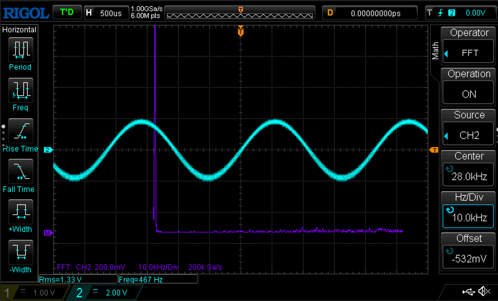

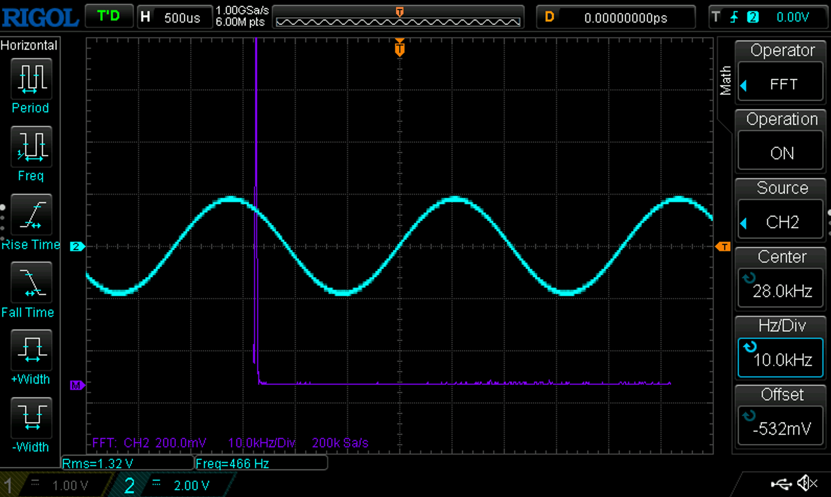

As promised here is a comparison between the NE5532 and OPA2134.
On the clean signal (from a signal generator) I could not see any differences on the scope. Frequency response and distortion was practically identical.
With a guitar signal the same picture. Very similar harmonics.
I don't know but to me there are no meaningful differences.
Maybe you can suggest an appropriate measure approach ?

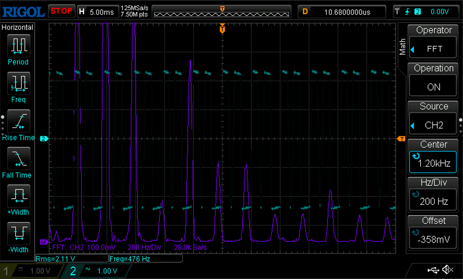

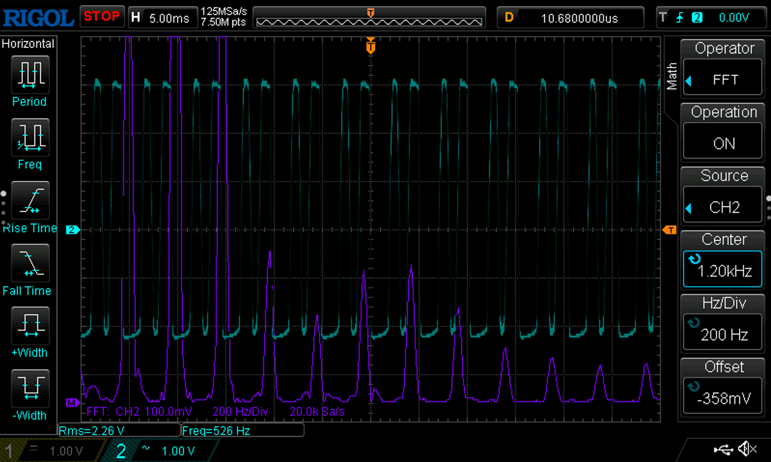

Accidentally I noticed that the 5532 is more sensitive to the low pass filter. In the graph there is more noise with the filter open.
All in all the 2134 seems to be more "indulgent" to filter changes.
NE5532
OPA2134
The noise isn't the real problem, the frequency rolloff of the guitar signal is the elephant in the room.There should be a difference between the noise levels when operating with a realistic source impedance (electric guitar, not a signal generator). No idea whether the difference is big enough to worry about.

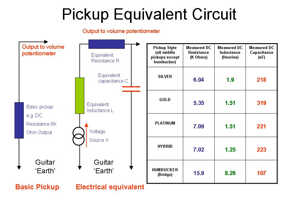

My apologies, I thought that was a simulator output. My point remains, though. A passive guitar pickup is high impedance.
https://ironstone-guitar-pickups.co.uk/guitar-impedance-matching-lcr/
That's exactly why I expect worse noise with an NE5532 than with an OPA2134, considering the higher equivalent input noise current of the NE5532. No idea if it is enough to worry about, though.
I still don't understand how you could get a noticable difference in high-frequency roll-off between the op-amps. The input impedance of the buffer stage at the input of the guitar amplifier is dominated by the input resistor and bias resistor, not by the op-amp type (the 300 kohm spec for the NE5532 only applies open loop).
