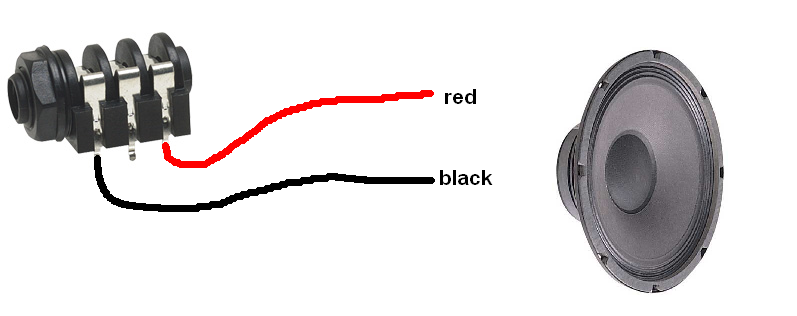

I have got all my material and starting putting thing together. Could any one give me instructions of how to wire from woofer to input jack.
the woofer comes with two plugs (connections) - Red and Black. the input jack comes with three prongs.

You want the tip and ground connectors. On a socket, these will be at opposite ends. Connect the black from the speaker to the connector nearest the hole, and the red to the one at the other end...
If you don't get that explanation, I'll draw something up...

Chris661,
Thank so much for all yous instructions. Honestly, I am confused. Could you please provide draw or image.
have good day.

thanks so much for the pic.
I think I have to buy the same input jack in your pic so that I can use the sample from the pic. Do I need ground?
I bought the metal-input jack which comes with three foots.
Did I buy the wrong type of input jack?
what is the different between the two?
Here we go.
It's quite difficult to explain - a picture tells a few words.
three foots.
=Stereo.
You can still use it, don't use the middle connection.
