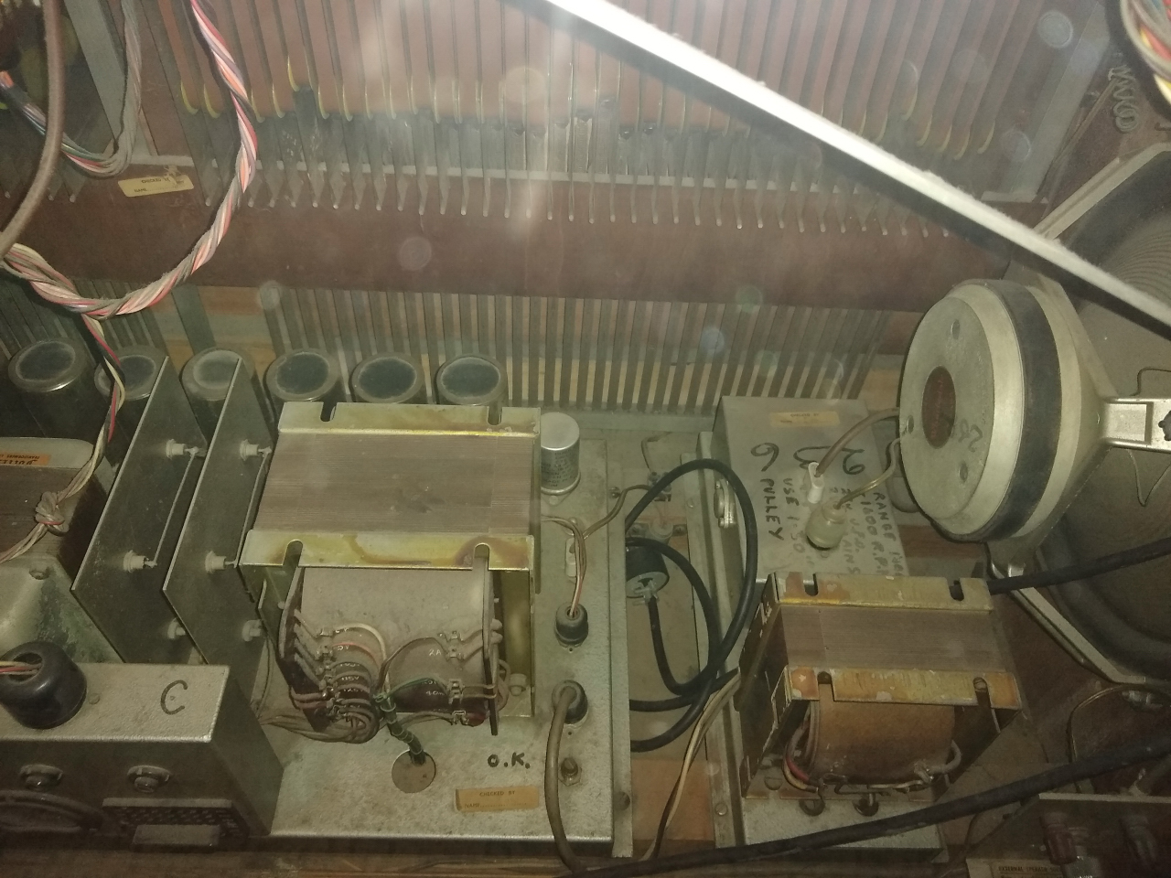

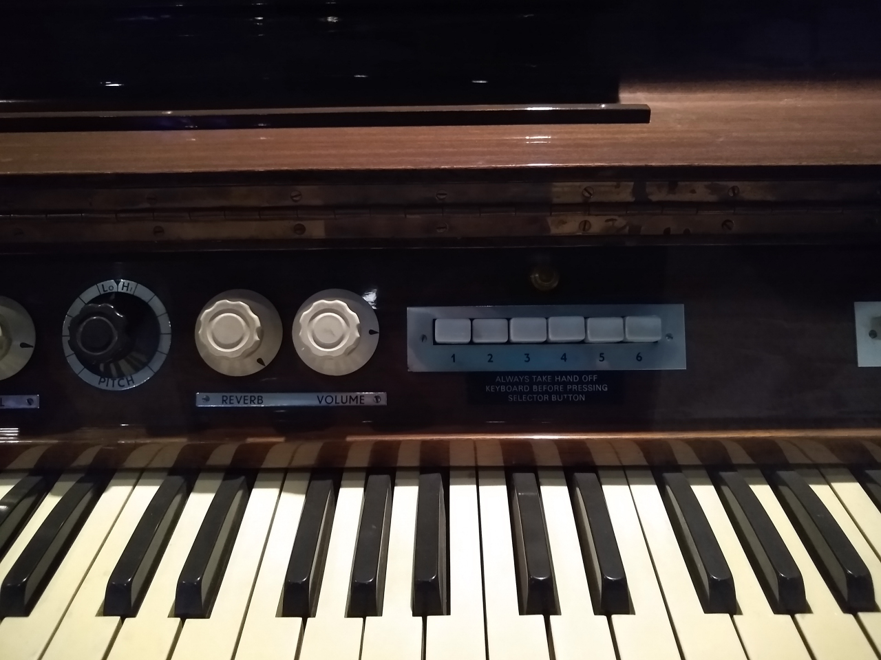

I found this M3 at a Goodwill store for $39.95. I was told that due to it's age it was not tested and the plug was cut off to prevent anyone from plugging it in. It was being sold as "furniture." Upon getting it home I discovered that the cord was still intact, just stuffed up inside, so you know what I did......It works perfectly too. Made in 1957 it still has all it's original tubes and capacitors.

The M3 is known as the "baby B3" but it isn't exactly a lightweight at 250 pounds. It's what Booker T (Green Onions and many more) learned his chops on.
