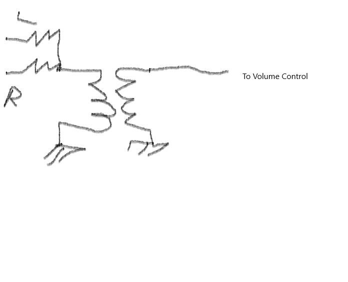

If you use one of the N-68X isolation transformers on the line cord input, then there is no need for any isolation on the guitar input, just connect the guitar ground to circuit ground and the guitar hot to the grid of the audio driver tube through a DC blocking cap of about 0.022 uF. The cap may not be required if the tube is cathode biased.

Plate to grid shorts are rare unless the tube has been physically abused.
Well, I was thinking along the lines of guitar players, and them lugging around their amplifiers. You know, without any doubts whatsoever, the physical abuse that they can do 😀. That, and they only bring in an amp when something REALLY goes wrong.
They are even rarer in small signal tubes....So maybe a 1 in a zillion short happens....you gave a cap in series with the input, so nothing other that the tube gets hurt. I have been abusing tubes in DIY guitar amps since the 1960's and I've never seen a plate to grid short in an input tube.

Man, I already have the schematic. I forgot I found it awhile back. My memory is going with these damn meds. It looks like I can just jump in on the grid, Tube 😀.
