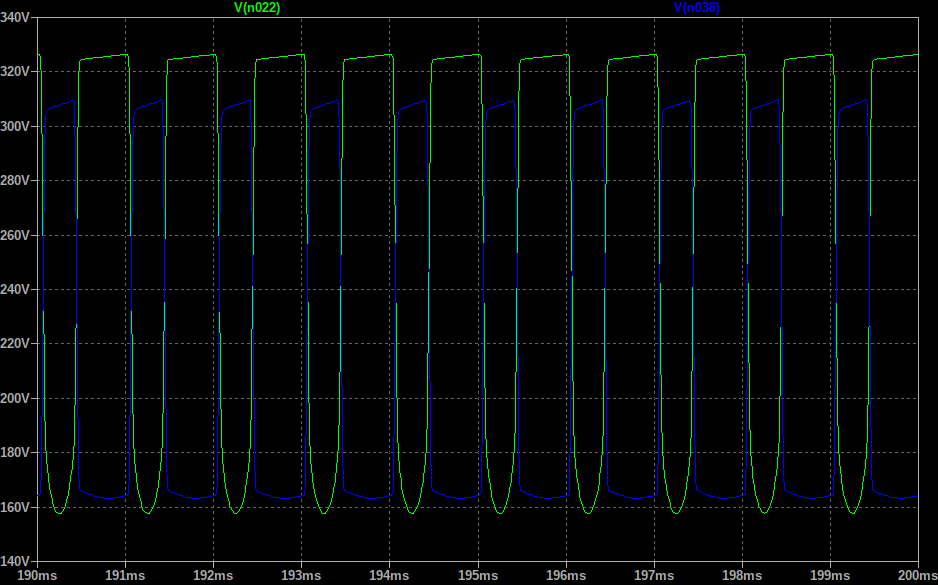

The LTPI is pretty symmetrical until you drive it into grid current clipping. The average current through one half goes down because of the grid current, so the other half must go up in response. Here's the signal at the plates of a Marshall-style AC-coupled LTPI (82k/100k plate loads, 470R bias, 15k tail) driven with a 60V pk-pk 1kHz sine (Rs=100k) for 200ms:

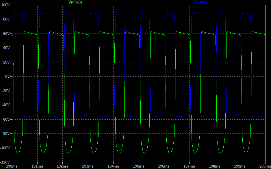

And the AC-coupled output (0.022µ coupling caps, 220k load):
The input levels can go even a bit higher than this in the real circuit. Voltages vary with frequency because of the tonestack, but the output from the cathode follower before the tone stack is nearly 150V pk-pk.

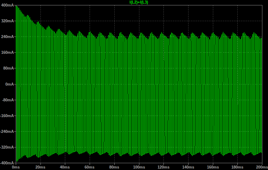

The coupling caps remove the DC component, of course, but what happens when you put this signal into the power tubes? The bias voltage is about -40V, so slice each waveform off at +40V, and there's your grid signal (approximately... it will shift down over time because of the power tube grid current). So for this example, one power tube conducts for about 60% of each cycle and the other for about 40%. Both control grids go to 0V, so the peak currents are similar. Voilà! DC on the output transformer primary. For completeness, here's the current in the OT primary (resistive load), complete with PSU sag and ripple:

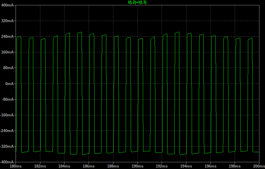

And zoomed to show the last 20ms:
The average current over this interval is -120mA.
Simulations suggest somewhere around 150mA of DC offset for a Marshall-style 50W power amp with the phase inverter driven hard.

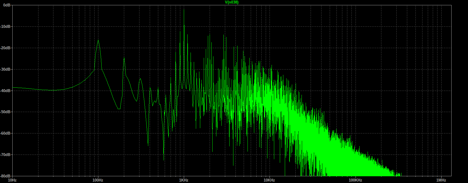

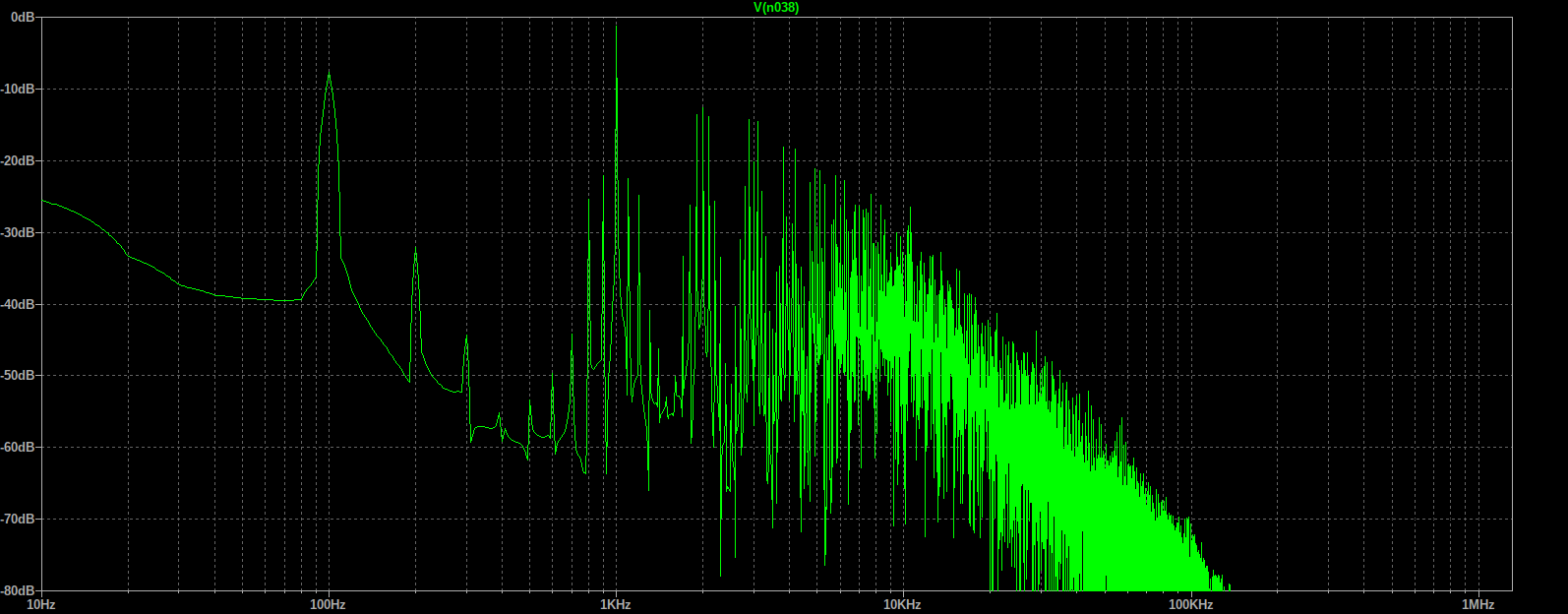

I found out that LTSpice has a couple nonlinear inductor models included, so I used the arbitrary inductor model to make a basic saturating inductor to represent the transformer magnetizing inductance (flux=L×Isat×tanh(x/Isat)). The test signal was 1kHz+100Hz sines at a 2:1 ratio (1kHz level was 55V pk-pk). With the magnetizing inductance saturating rather heavily, the RMS current increased by about 15% compared to no saturation. The 100Hz level was reduced (as one might expect) and IMD increased considerably (FFT attached).
