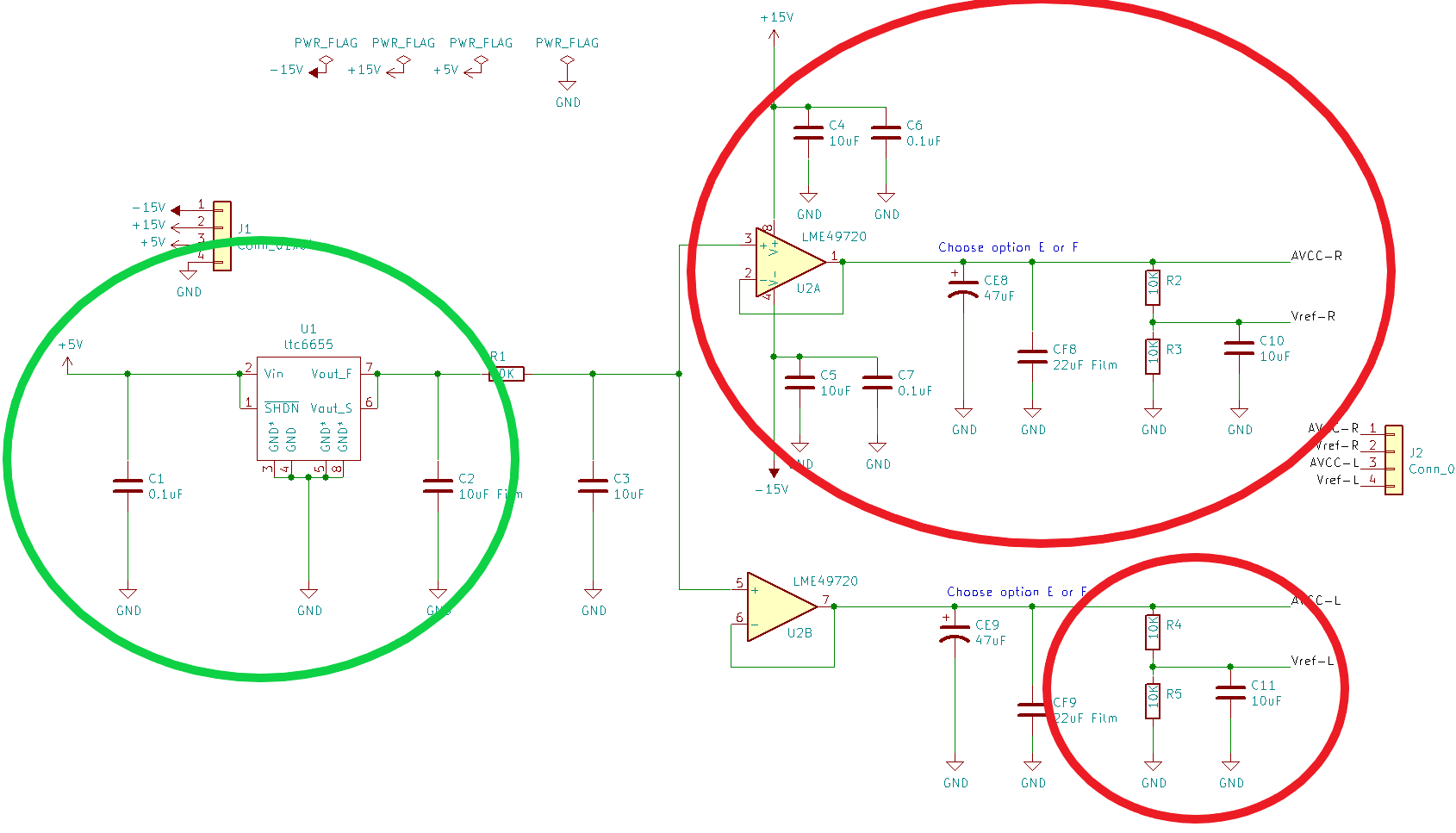

I am not quite clear on what the picture you attached is supposed to show?
Hi Mark,
You can probably ignore the picture I attached. I don't understand how the AD797 and AVCC circuit fits into this so I was trying to figure that out. Are you suggesting I switch out my current opamps with the AD797 and use the AVCC template for my 3.3V power supplies?
I got a I2C Digital Isolator chip and have a breadboard I can use to communicate with the DAC chip. What's the next step here?
I have also ordered a 7812/7912 regulator which I can run after my current regulator (after adjusting it to output 15V).
...I don't understand how the AD797 and AVCC circuit fits into this so I was trying to figure that out. Are you suggesting I switch out my current opamps with the AD797 and use the AVCC template for my 3.3V power supplies?
AD797 can be mounted on SMD to DIP adapters and plugged into sockets on your dac board. The are very good opamps, although expensive.

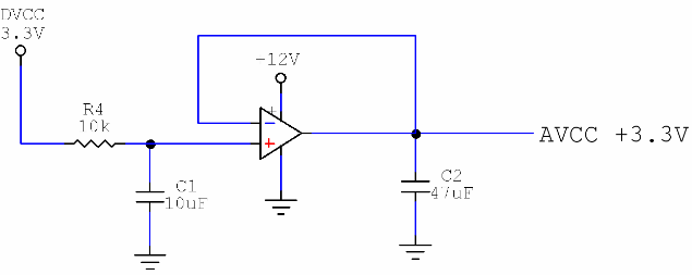

For ESS Sabre dacs, AVCC is a very particular type of power supply load. It should have a power supply that is good in ways good audio power supplies should be and that is very linear in its subtle regulation properties. It will affect the sound of the dac a lot. Most of the other power supplies are much less critical for sound quality.
Therefore, ESS recommended an opamp buffer circuit in a document from their website that I may have linked already. Just in case not, here it is: http://www.esstech.com/files/4514/4095/4306/Application_Note_Component_Selection_and_PCB_Layout.pdf
I would suggest building an opamp buffer supply as ESS wrote about and like the schematic I pointed to previously (if you feel up to building such a thing).
You need an MCU such as maybe an Arduino to talk to the dac chip. There are solder vias on the dac board you have to connect the I2C isolator. The dac board does not include pullup resistors to the digital 3.3v power supply to the dac though. Typically they would be maybe 4.7k, but the isolator you got may already have pullups, not sure. You should sketch up a schematic of what you intend to hook up. Then you can assemble parts from that as your reference.
Quoting* "I would suggest building an opamp buffer supply as ESS wrote about and like the schematic I pointed to previously (if you feel up to building such a thing)".
I say this a lot, but I appreciate your willingness to walk me through this as I continue to work my way through understanding. I think I now follow the intent and design of the buffer supply in the ESS document. Let me know if any of this is incorrect:

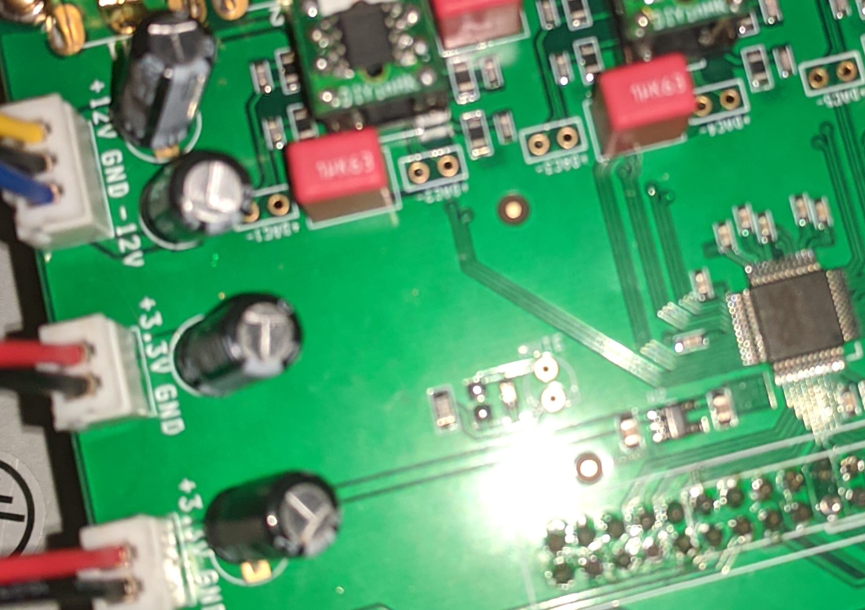

I could power this circuit using my existing +3.3V power supply as the DVCC 3.3V input in the ESS circuit diagram. Another option would be to use the left portion (green circle) of the circuit diagram you referenced from a different thread with that circuit being fed a 5V A/C signal. Is there any advantage to one over the other? And should ignore the AVCC-R portion of the thread's circuit as well as the final resister/capacitor portion (red circle)? These don't appear in the ESS document, and I'm assuming the thread's circuit has different functions than mine.
Three dumb questions:
1) How do I identify which of the two 3.3V inputs on my DAC board power the opamps? I assume this is the middle input in the picture since it looks as if the 'bottom' one powers the DAC microcontroller.
2) I could assemble this circuit on a breadboard, but it would look nicer and take up less space if I could put it on a PCB. Any idea on how I could go about doing this?

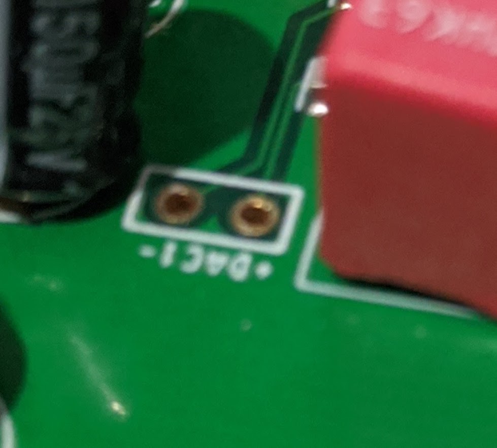

3) Any idea what the "-DAC+" inputs in board's picture are for?
