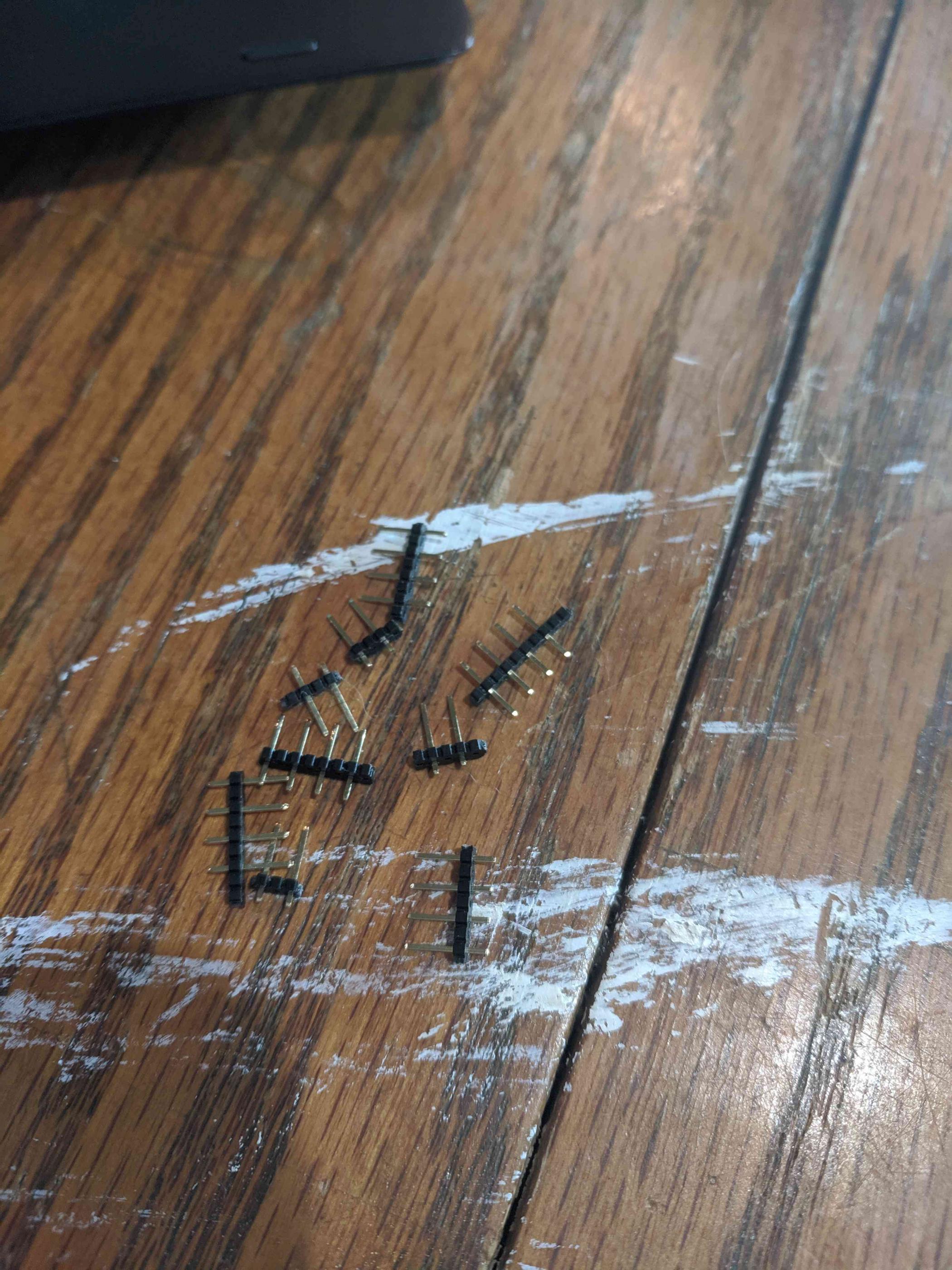

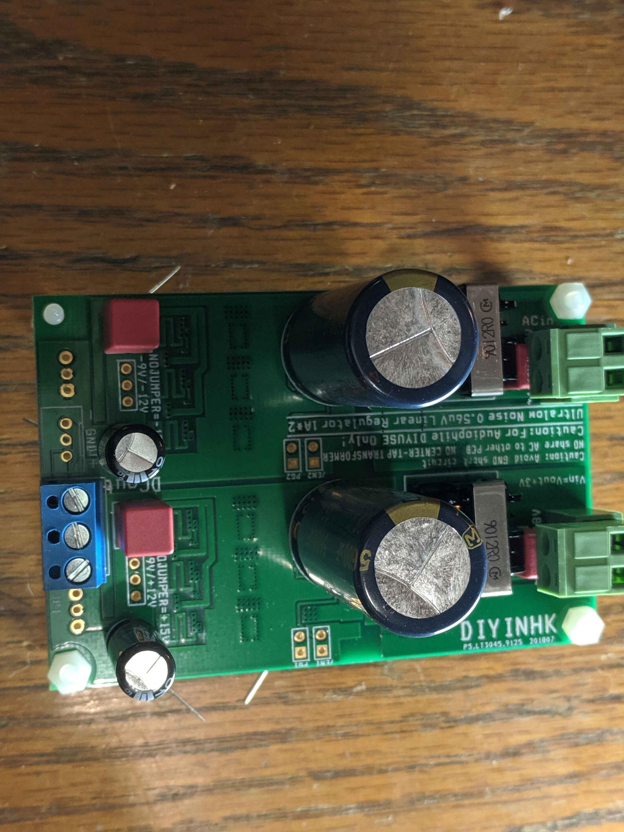

I've wanted to get some hands-on experience playing with circuits and such so I bought a USB 8 channel DAC kit and was hoping I could find some folks here that would be willing to guide me through the assembly. In exchange, I'm willing to write up the process as a guide for others in the future.
The board itself is an 8 channel ES9016 board here with this reclock between the USB input and DAC and the opamps here. I'm using this and this as the power supply.
My main questions are these:
1. What needs to be soldered and what does not? The site states "SMT components soldered, thru-hole components are not soldered", but it's not clear to me which is which. It is especially not clear how the opamps are attached to the board.
2. How consistent do the top/bottom lengths of the opamp pins need to be? For example, is it a problem that one side is longer as seen in the picture? Is it also ok if some opamps are connected by two sets of two pins (or one and three pins) instead of a single set of four pins? I had a lot of trouble resizing what was sent to fit.
3. What is the best order to approach assembly? Since the majority of my solder experience is with larger cables, I don't know what to expect when working with something this small.
4. How do I best go about getting power to each of the power supplies while minimizing the amount of outlets needed to power the DAC? I'd like to avoid having to provider a separate power outlet for each of the power supplies.

4. You can power the two boards with the same cable if you wire it correctly.

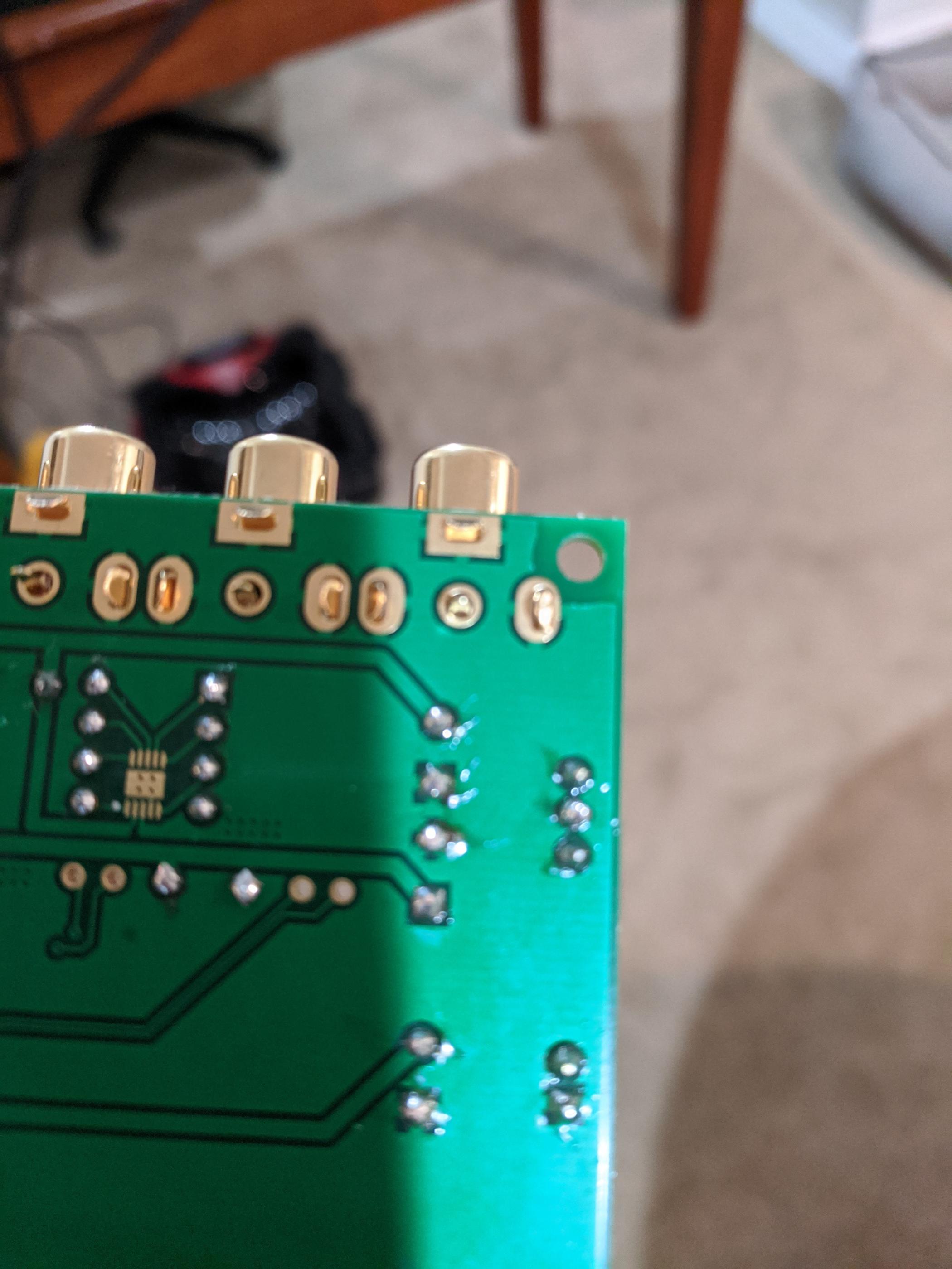

I managed to get everything assembled, but I am only getting output from 5/8 channels. I couldn't find any info on how to attach the RCA jacks so I soldered them to the board, and that may be my issue, especially since it was a really bad soldering job. Any advice on troubleshooting?

Otherwise, you could post some good, clear, well-focused, close-up pics of your work, the bad solder joints you suspect, etc., and let us take a look. Maybe we can see something that could be your problem.
I can identify the opamps themselves, but I don't know how to take the signal in or out of them. I could check for a signal with an AC voltmeter if I knew where to measure (no o-scope yet).
Since the files are large, here is a link to pictures showing the opamp and RCA soldering. It's certainly not pretty 🙂

Those pics look pretty bad. What solder and soldering iron did you use (pics please)?
Looks like one of the opamps has its pins shorted together with solder. Also, some of the output connectors are not soldered at all.
You will need a proper solder iron for electronics work and proper solder.
In addition, you will need some solder wick for removing excess solder you have already applied. Some extra paste-flux would likely be useful for that process.
After we see what you are used for the existing soldering then we can figure out what you need to do next. You might that find watching some youtube instruction on electronics soldering would be helpful. A short movie I made to help people in another thread see how an opamp might be soldered to an adapter or PCB can be found at: Dropbox - SMD Solder.MOV ...You may notice that solder on the tip of the iron tends to move away from where you want to solder to go. That's because it goes to where more heat is, and since one side of the iron is touching the PCB that side if the tip is being cooled. If that happens you can do what I did which was to rotate the iron in my fingers to bring the solder around to where it could make contact with the PCB and opamp pin. Once the solder makes contact then heat transfer from the iron to the PCB and pin are greatly improved. As that area heats up then the solder will flow there. However, it needs to be done quickly to avoid burning up the flux that protects the solder from oxidation. One can practice such things with iron cold. Once you can manipulate the iron in the necessary motion, then try it with a test board and test component before trying it on your project board. You need some practice before risking damage to costly equipment. There is much more that can be said, but let's take it in small steps for now.
Troubleshooting with power turned on should only be attempted after all plainly visible problems have been fixed.
Cleaning these pins up with some solder wick is a must:

Did you use pin leads to connect the op amp boards to the mainboard? Almost looks like you just tried to bridge the two holes together with solder. It could work, but I bet that is causing trouble as well.
Thanks Mark and Paul. Note that the RCA portion looks pretty bad in part because I tried to desolder using a desolder gun without any wick so what you're seeing is a result of both bad soldering and bad desoldering. I haven't powered it back up since trying the desolder, and based on what you're saying, I don't plan on powering it back up until much later.
The opamps are connected to the board with header pins and not just straight through. This proved to be much more difficult than I thought for the reasons Mark laid out so I'll be sure and practice technique before attempting again. Since I was on a roll and having success with soldering other joints that looked good, I didn't use any flux for the opamps, and I've since learned the iron needed to be cleaned at that point - the solder kept bubbling up on the iron. In addition, the iron only came with one tip which is probably too large for the opamps, and I had trouble finding replacement tips to fit this one. I've since ordered a replacement set of tips which includes a smaller one.

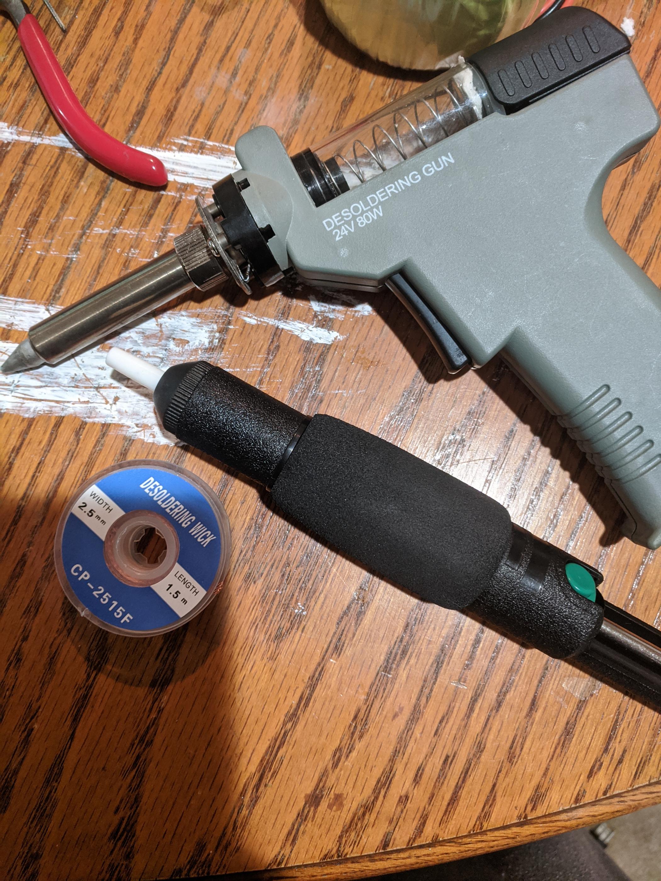

Assuming the next step is desoldering the opamps, any recommendations on what sort of wick I should use? (This is surprisingly hard to find - home improvement stores don't carry it.) Is what I have in the picture ok? When it comes to practicing technique on test components, any thoughts on where I can source such things in reasonable quantity for relatively cheap? Until I get a better understanding of these components, I'd prefer to see them in a physical store.

Best solder wick I have found:

Some suggestions and comments: Use a bigger tip for solder wicking than for soldering, if possible. My rule with tips is use the largest and shortest one that fits (just barely not too big). That gives best heat transfer and fastest soldering. Soldering pads attached to a ground plane may require a bigger tip and more heat since the ground plane tends to conduct heat away quickly. Iron temperature is important, only a 5-degree difference in temp can make a big difference to soldering results. Different tips will conduct heat differently so may need to be set to different temperatures. I try to find the minimum heat to barely liquefy unleaded solder on commercial manufactured PCBs, then adjust heat up or down a few degrees until I find a temperature that can be used to unsolder or add leaded solder to existing joints. Sometimes adding solder first can help removal. When solder gets too oxidized it will not flow and can be very hard to remove. It may be possible to dilute it with fresh solder and maybe some extra flux.

Next, I'd like to solder the RCA jacks to the board. Do I need to solder each 'leg' of the RCA jacks to board, or only some of them?
Solder all the tabs on the RCA jacks, but best to use a larger solder iron tip to easily get enough heat in there so you can solder quickly without producing cold or oxidized joints. I use the same rule I do with screwdrivers (especially Phillips head !) which is to use the largest tip that fits (without being too big). For soldering the tabs, that would likely be a tip approximately the same width as the tabs are.
If no tip like that in your collection, you might check with a cold iron to see if you can fit a smaller tip in there laying on its side so that it makes good contact with tab and its solder pad along where to two meet at the edge of the via hole. That might work well enough, perhaps with the iron temp turned up higher than usual. Remember, the idea is to heat up the joint fast, solder quickly, and get out before the flux starts burning off too much. Yet, you need to stay there long enough for the solder to fully liquefy and flow freely. Always practice on scrap material if unsure.
