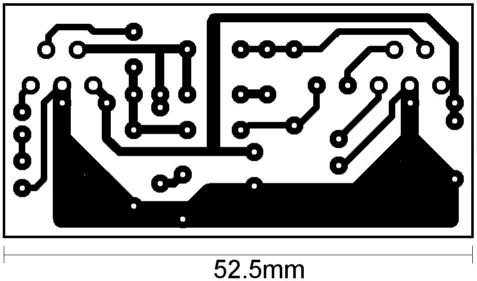

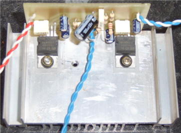

Here's a couple of pictures of the TDA2003 circuit I built. The original circuit was in an EPE mag. Their PCB pattern was originally around 100mm long but with a little messing about I was able to reduce it to 53mm. All the components are still in their relative positions I just changed the resistors so the are vertical instead of horizontal and rotated a couple of the polyester caps 90 degree's to aid the contraction of the circuit.
