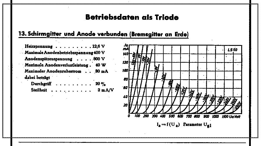

gorgon53 said:
Looks like your data is for application where efficience is not of primary concern and the more efficient data with the 85+W is
thougth for a application where efficiency is of prime importance.
Are you kidding?
Telefunken claims 62.5% for 120W p-p AB class.
Speasking of a triode mode, it needs helluva swing to drive, but is pretty linear:
yes, 62.5% isn bad
triode is interresting but only at high enough voltages at the anode, and high drivevoltages are needed, but you can get some serious power and it would be much more linear than a 6C33 for instance (wich is totally horrible), horrible also in respect to driving it
btw, look up a YL1370 or some other of this family, americans have equivalents like 6146, be supriced what you can get from that lill tube, up to 150W and at a efficience that is hard to beat,
without gridcurrent things aren so outstandin but 124W is still good, and also as a triode looks nice with 22W output and only 2x9W platedissipation it should last for ages

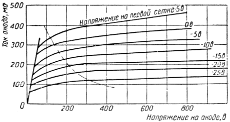

gorgon53 said:Rainbourne, do you have original data with all the tolerances, life-expepectation, a.s.o. and triodecurves for the GU50?
Very few that I've found in the Net.
Maybe this can be of some help:
GU50
It's the pages from a book "Lampovij Hi-Fi usilitel svoimi rykami" (Tube HiFi amps with your own hands) describing the GU50. There were some triode curves there.
