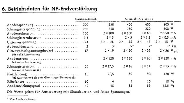

Wavebourne, dont be silly, I used this tube with a E88CC as the driver, in application needing 8W+-10%, between 500Hz 500kHz!!!
2 of those tubes can giv you 12W at 1% thd
100 5%
120 10%
you can get 120W with a Uin of 10Veff into a Ce of 50pF

Wavebourne, tell me how you squeezed out 120W from those GU50?
Telefunken wasnt able to do that with theyr LS50 wich is rated for use by the Luftwaffe, or RL12P35 with its to 35W derated anodepower for use by the Wehrmact or the 40W rated civilian version EL152, all seem to be electrically the same tube (exept for theyr ratings and sockets)
digged out my old Telefunken Databooks and checked
Best what Telefunken was able to get out from a pair of EL152 was 85W, a bit more than 90W could be achieved with some gridcurrent.
This at 1000V on the anodes and 360V on g2 and a supricingly low Rg of only 25kohm.
Offcourse you had only a Ce of 14.5pF wich isnt much of a achievment with a tube that offers a steepness of only 4mA/V

gorgon53 said:Wavebourne, tell me how you squeezed out 120W from those GU50?
Actually, I did not squeeze.
I experimented, what if to replace 4x6L6 by 2xGU-50. I expected to get the same 80W per channel. I rearranged a power supply to get 375+375V instead of 375V. I used 300V regulated to power phase splitter and screen grids. However, GU-50 specifications require no more than 250V on grids, but I decided to experiment and see if they surwive. They actually did, no glow. When I measured max output power I got about 120W on 1 KHz frequency. Then I measured output power of my 4x6L6 prototype and indeed got about 80W. For 6L6 version I used 4K guitar transformers, for GU-50 version I used 6K guitar transformer. I need this amps for vocal and acoustic guitars, so transformers satisfy me absolutely. For home theater I have an isobaric low-Q horn subwoofer powered by bridged 800W transistor amp, so I need frequencies only from 80 Herz from a stereo amp, it is more than plenty, so guitar transformers fit perfectly.
Conclusions: Soviet GU-50 can be used like Telefunken LS50 despite specs require more relaxed applications. They are amazing tubes and I love them. I recently bought hundred of such tubes, now going to sell on ePay all sweep ray tetrodes I bought before, like 6LW6 and similar.
