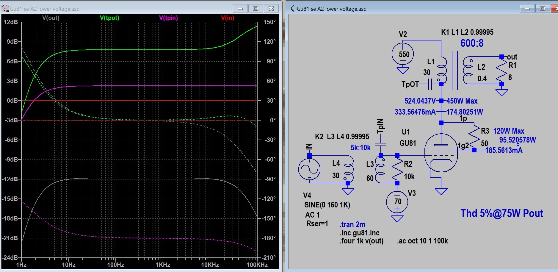

Me too also scare of voltage over 500V. But not everyone agree why one should stick to +-700V. It can deliver more than 30W with +-300 rail, or a total 600V. With SE amp you need about the same, I think about 500V on g2. Remember if you want more power with this tube drive it into A2, that should double the output power. Attached is Class A, can mod to A2, but I don't agreed everything in the snapshot (not mine): 150W?,in pentode mode.
You can do para feed so you can use PP type OT, need to use suitable choke to drive the OT with sufficient current more if into A2.

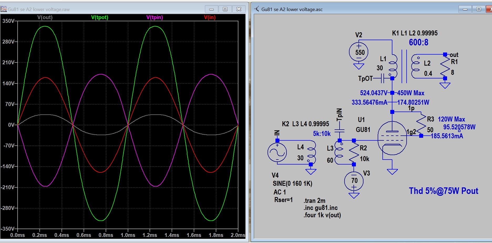

  • Gu81 se A2 lower voltage.asc

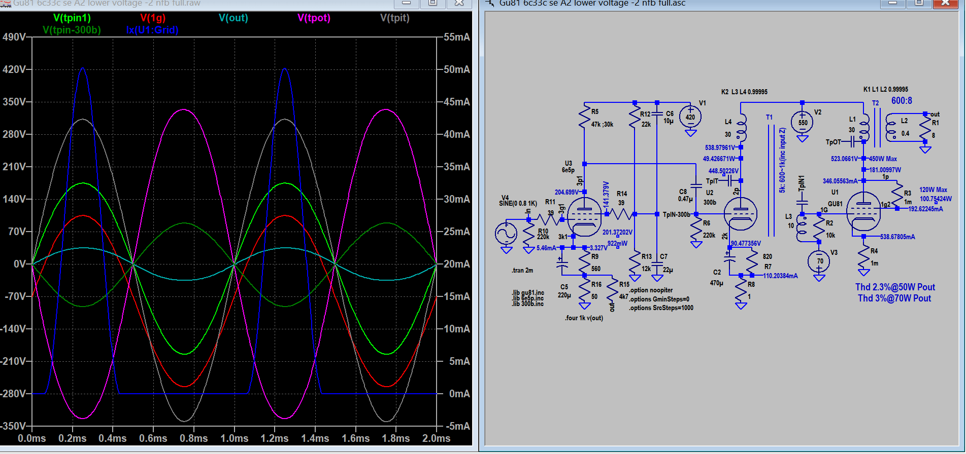

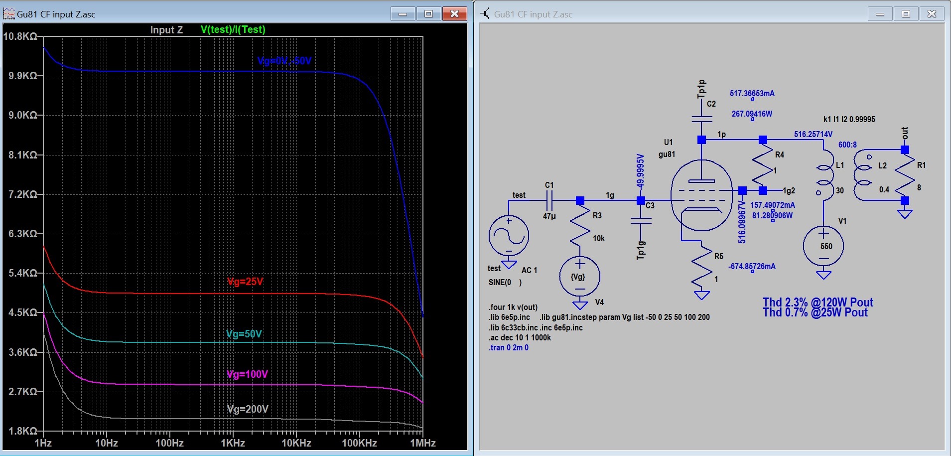

Here is SE A2 simulation for OP and and anyone who wants to persuade further. A2 in triode mode is better than A2 in pentode mode I deduced from sim. GU81 model file has been post to tube Spice page. This OT should work: https://sklep.toroidy.pl/en_US/p/TTG-6C33CSE-Tube-output-transformer-600-Ohm-6C33C/610, very low DCR (54 ohms) so output is higher.

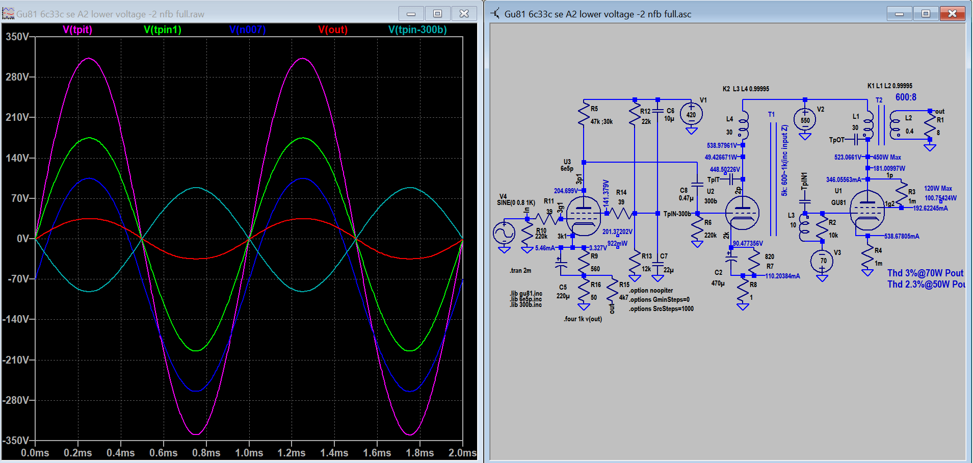

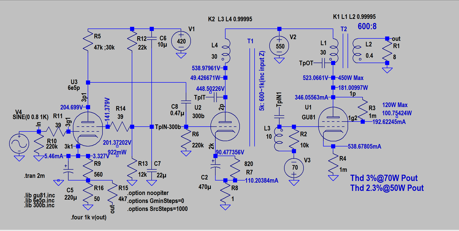

I'm looking at this schematic closely, how do I determine the dc current that the gu81 grid will draw? Am am I reading this correctly? 30v of swing into the Interstage transformer for 60v swing out to give approx 90w of output and the grid is held at +70vdc
Im keen to try an interstage transformer as this is something new in my builds. im assuming pick a tube that will swing 30v into a 5k load (maybie a SE 807 or 6l6 etc) or would this prove troublesome as there would be dc on both the interstage primary and secondary (gu81 grid current)
Attached snapshots show substantial grid 1 current of >50mA peak at 70W output, as A2 swing from>+100V to >-250V. IT would be 5K:600-1K rather than stated earlier (only good driven by Spice generator). So in real circuit the driver use could be 300b driven by 6e5p. The grid is bias at -70V, low secondary impedance IT could be the only way to be able to get large swing pass 0 into positive region. The grid appears drawn no current @-70V.

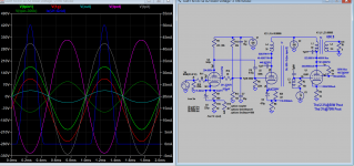

That looks a lot more as I was expecting In a schematic or similar to other large transmitting valve audio output circuits. 50ma of grid current, I thought it would be significant and I need to put approx 300v p-p across the grid into a lowish grid impedance hence the large DC current (I think I understand this correctly)

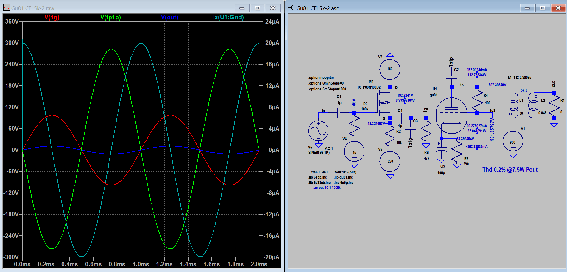

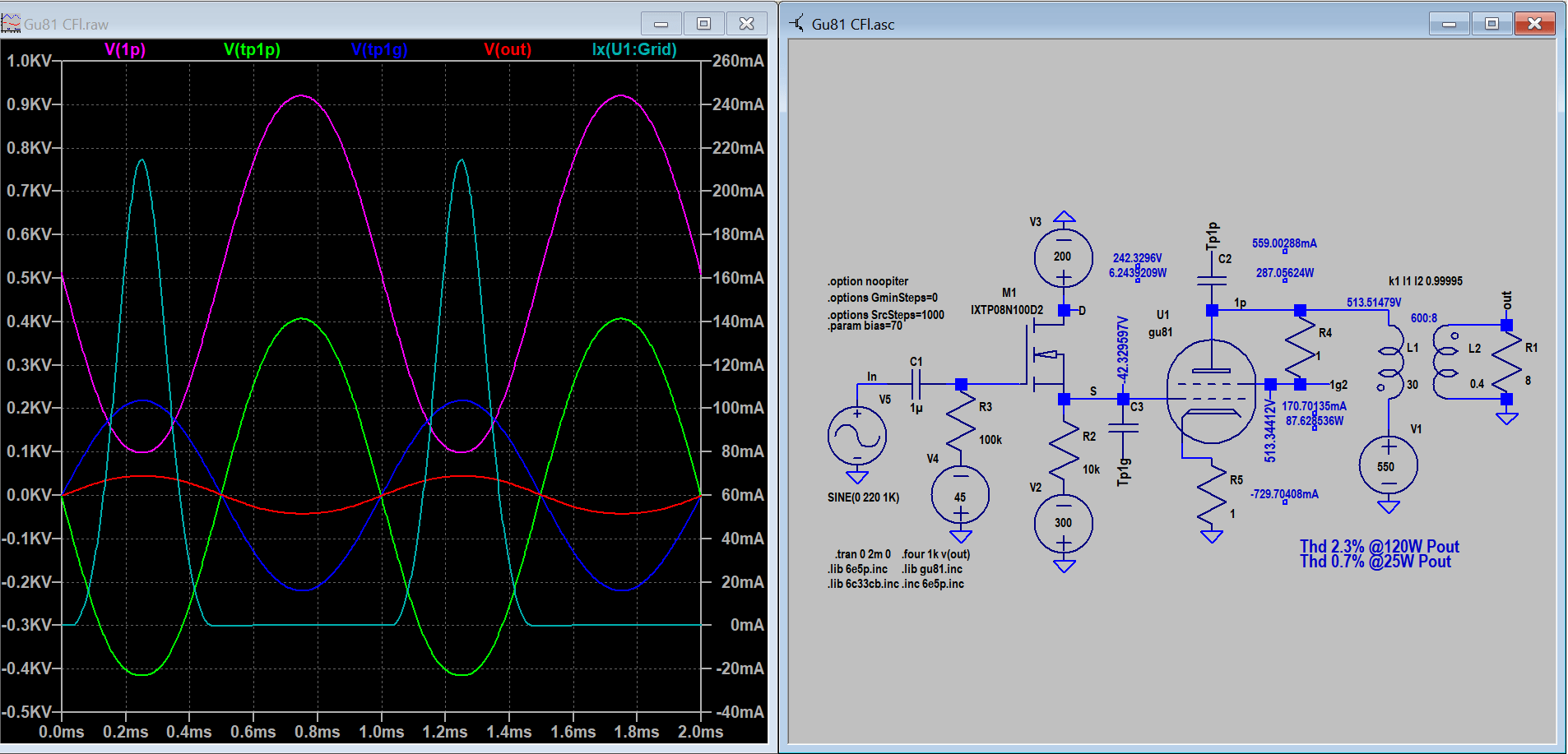

120W, is this possible? Can some comment on this circuit? The plate is up to almost max swing possible (with 100V margin) and it has efficient of about 40%.
I need to start simulating circuits myself it appears simple yet finding the time is tricky.. (young family) what is the software being used here as I'm keen to give it a go?
