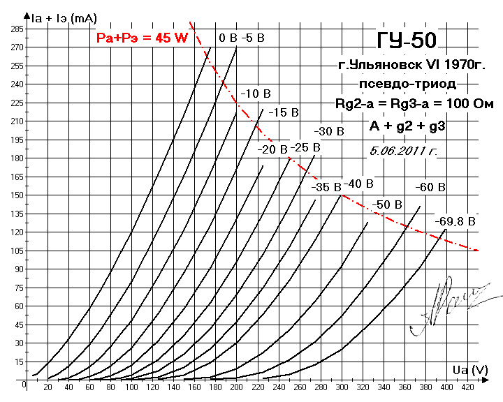

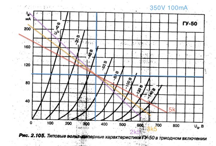

I have been playing with GU50 Triode curves for a while now, and it really looks like a 3.5k-5k transformer gives better power output with lower distortion, especially sitting at a quiescent point around 80mA at 400V. I have noticed in these forums that you typically advocate for something lower, more like 2k. What is pushing you in this direction?
A good example is attached (not my work, swiped from here).
I don't remember when I pushed toward 2k. Probably 2k5 for 300V B+ and 45W dissipation Anode+G2?
Edit: also if you add positive voltage on G2 curves shift left. I used +12V that I had from filament rectifier.
