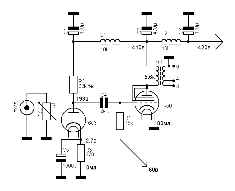

And the benefit of a Ri minor (write the autor)
Fixed bias (also in other tubes) allows to increase +B
to those 400V without problems.
Ra I suppose equal, 5K or 2K5 for 2 tubes, or more...
biasing 95mA per tube whit 2K8 3k? (better DF?)
Other diagram is biasing fixed, +B 400V and Ra 5K6.
THANKS

Nope!
Much notice must be paid to the fact that g2 doesn't take more than approx. 250V.
It can swing up to 750V easy, when tied to anode (triode mode, 400V B+). When anode goes below (pentode mode) I don't recommend more than 300V regulated.
Also, try +12V on 3'rd grid. And self-bias (cathode resistor) is the best for class A. Fixed bias is needed for class AB.

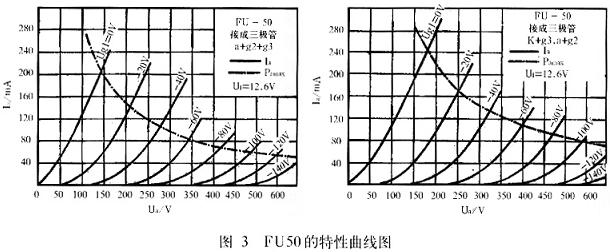

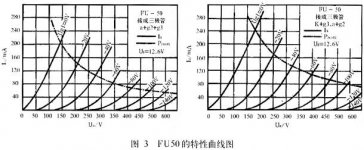

The limiting factor is the max screen dissipation. As Wevabourn says, it is not a concern in triode mode when Vg2 will not be above Va.
When connecting a+g2+g3 the g3 dissipation may be of more concern.
The Chinese equivalent FU50 shows a lower max power curve in this configuration (attached)

It was designed by TV repair technician Sergey Sergeev: G3 is on a separate leg of the tube, so why don't try to strap it with anode, right?
As Svein_B says, in order to get more of clean power it is better to tie G3 to cathode.
- It says to connect to the anode for Ri minor of the tube.
- Other tubes that allow, EL34 for example I have seen connect equal (Bas Honerman)
- Fodder that 1º, the tube works more like triode. 2º avoid the limitation of Vmax. g3.
I do not know if it makes worse the sound, if we lose something of power supposing that we gained quality, as it says to Ri minor and major DF.
Ri itself does not matter; ratio Rload/Ri matters actually.

Dear Feralmeida;
I would recommend you to search for Gu-50 triode curves, then draw your own load lines.
PS: Audio Guru and TV Technician is often the same. But more often Hi-end Audio Guru has no education in electronics field.

450V B+, 510 Ohm 10W cathode bias resistor shunted by 50 uF 100V capacitor; 2K 100 MA OT; 100 Ohm screen grid stopper connected to anode; G3 connected to cathode; 220K grid leak resistor to the ground (may be higher due to autobias).
That's it.
Can you draw it now?
That's it.
