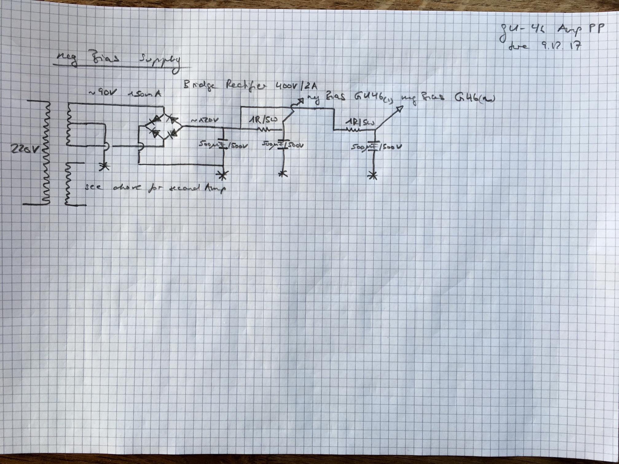

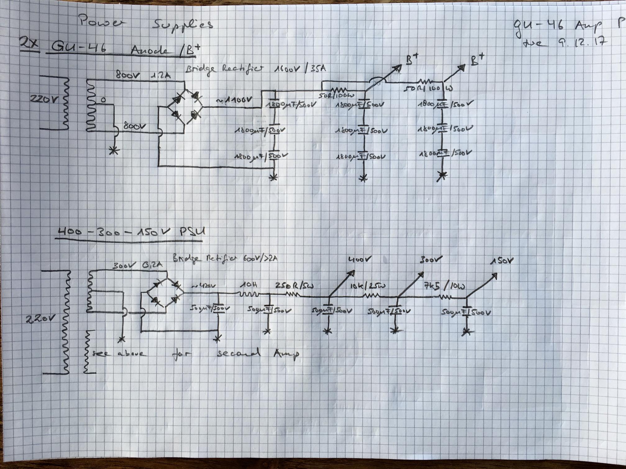

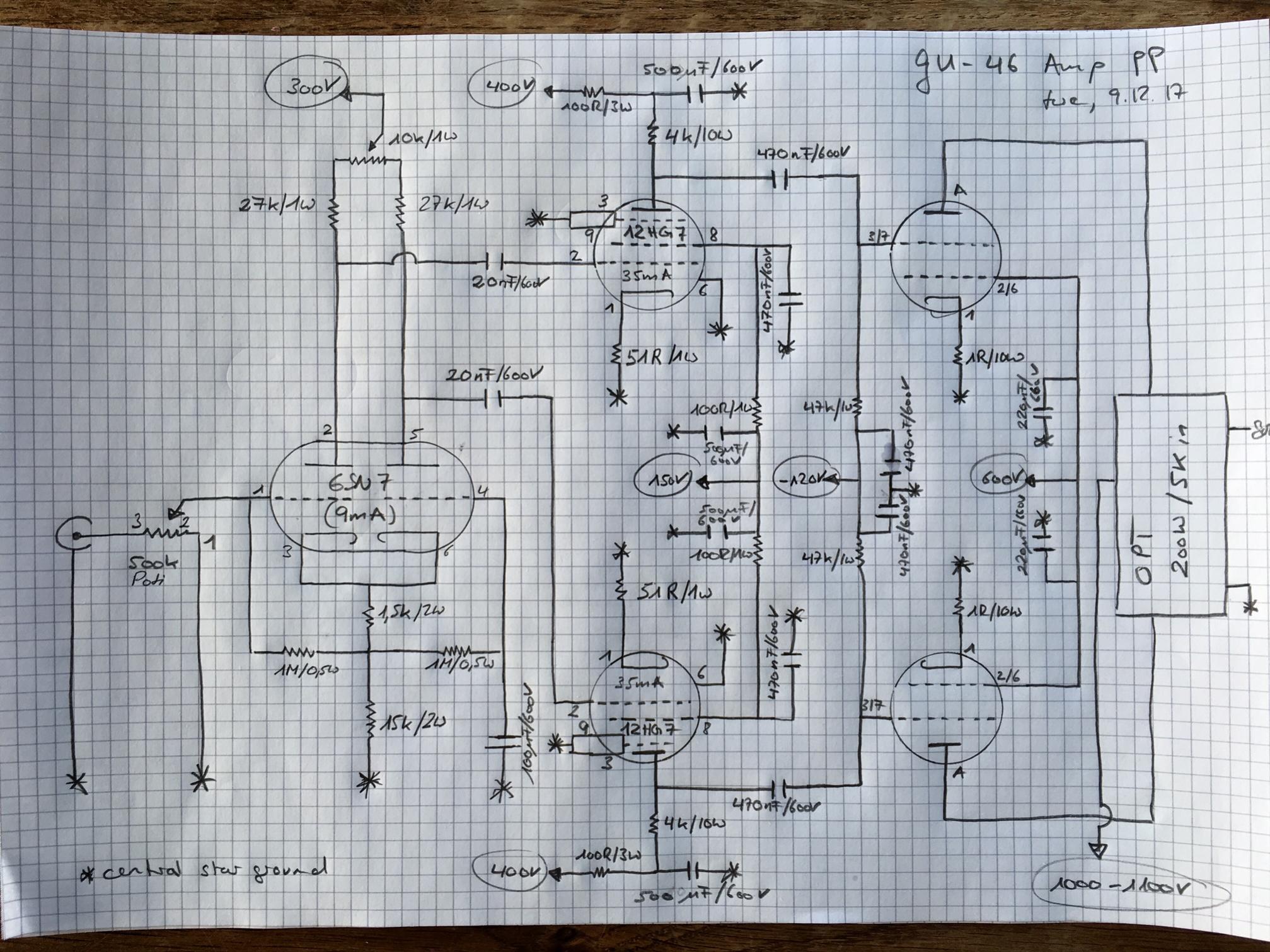

Hi Eli
I haven't seen your only now. I have drawn a couple of schematics, your Input not yet included.
Schematic for one mono amp, one schematic for the GU-46 anode voltage PSU, one for the rest of the tubes, and one for the negative bias supply.
You are proposing to use a hybrid rectifier composed of the above mentioned Schottkys and two pairs of 6CJ3s for one chanel. I wrote this down in my notes.
Greetings, Thomas
Greetings, Thomas

Thomas,
Mona drew a full wave center tapped B+ setup. Nothing wrong with that, but 1600 V. end to end is exponentially more dangerous than 800 V. That's why I suggested a hybrid bridge. The Schottkys form the connection to ground and the damper diodes form the "hot" connection. The B- supply in "El Cheapo" is a hybrid bridge. You would invert all the polarities, for a B+ supply.
As far as vacuum rectifiers go, forward drop in damper diodes is low. Damper diodes are extremely slow starting, which allows the signal tubes to get fully warm.
I agree Eli, but the TS stated "The high voltage cirquit for the GUs shall have its own transformer (approx. 800-0-800V 1.2A)".What Banat shows is much better, hope the TS will change his idea. Mona

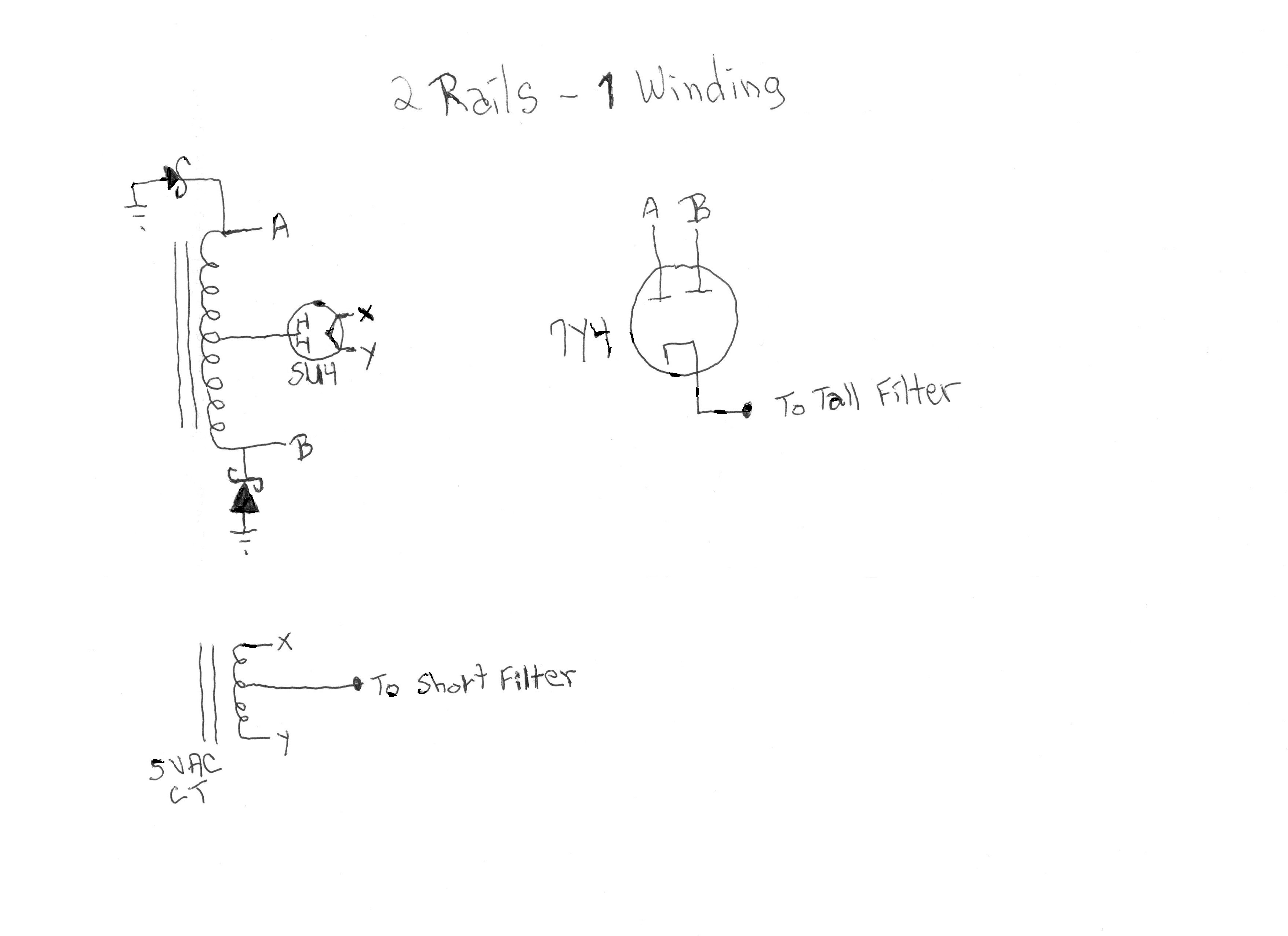

Some time ago, Pete Millett publicized a method for obtaining 2 full wave rectified rails from a single CT winding. Only 5 diodes are needed. By using a combination of choke and cap. I/P filters, it is possible to produce rails that are other than n V. and n/2 V.

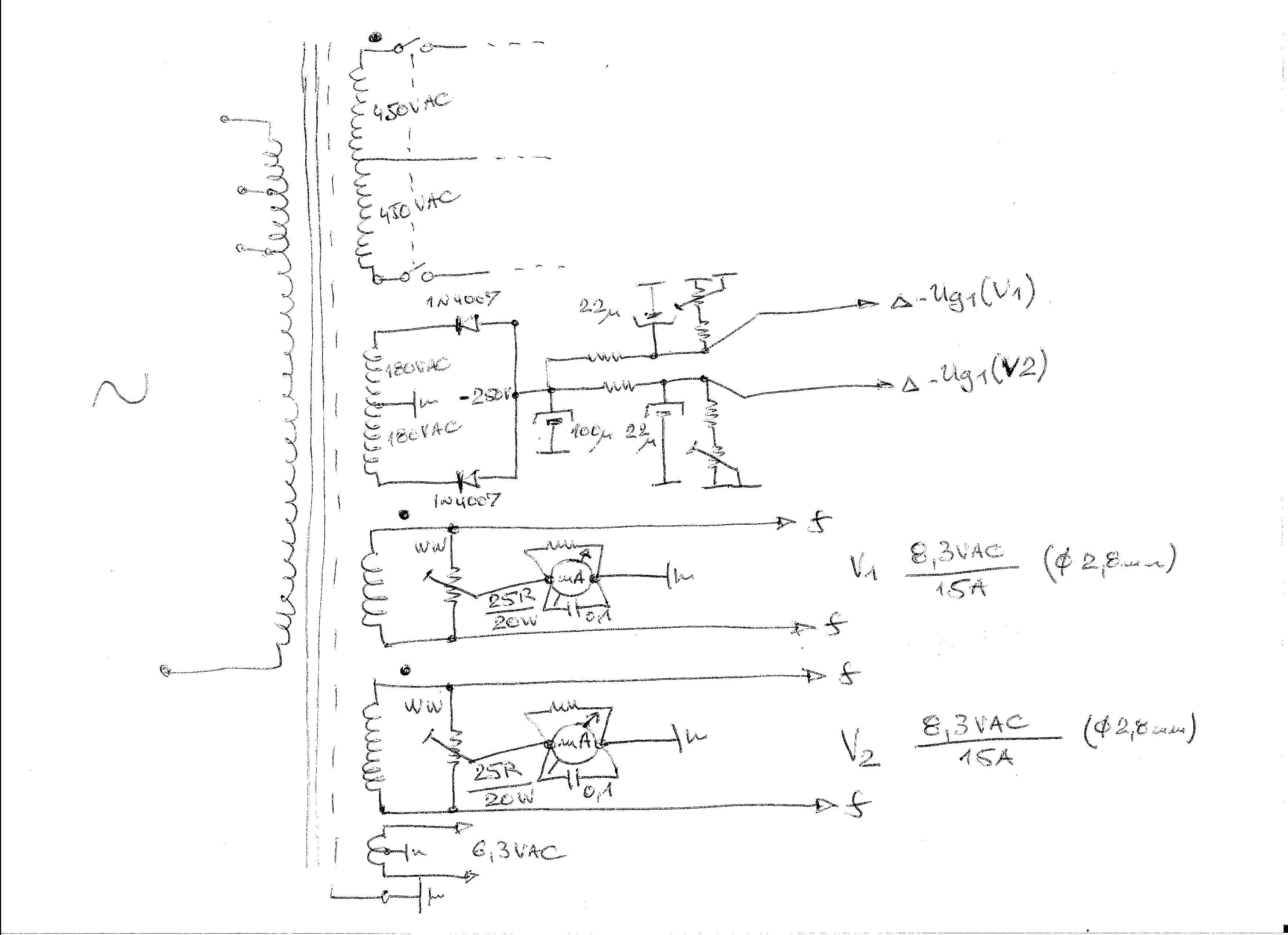

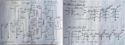

Dear all,
I am adapting my PSU Idea to the proposal of Banat.
This schematic seems to be relatively simple, and since the trannies will need to be custom wound anyways, it will make sence to combine these in one single large tranny per monoblock.
I will also go for AC heated GU-46, as proposed by Banat.
Does anybody have any comments in the amp schematic itself? Banat proposed using Mullard 5-20 topology, from other sources I have the Info that the GUs should be loaded with low impedance. There was once a thread in this forum of a guy using pmillets schematic with 12gh7 as first stage, but in a SE topology.
Greetings, Thomas

Where can you find that information? It seems the HV capability of the tube is wasted by running it at just 1kV.from other sources I have the Info that the GUs should be loaded with low impedance.
It is BIG...🙂 I like it...🙂

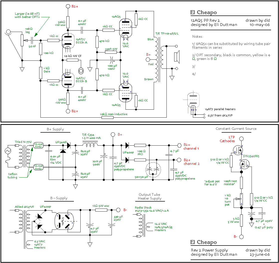

Let me suggest something in terms of topology. You'll need EL34 for signal tubes, and a single B+ supply for the plates and front end. Your OPT will need U-L taps( which you can use or not for the GU46's ).
The 500W plate will allow ~200 mA idle current, which working through a 10k a-a load in Class A gives you ability to swing nearly 1kV( a 200 mA idle plus 200 mA more on an increasing g1 swing will take the plate near zero V)
should be able to get 200+ W in Class A. Tasty.
Check out the pdf in post No. 4. Substitute EL34 for the 6AU6...🙂

Here`s updated PSU schematic , each GU46 tube can have separate filament winding , separate balancing hum pot and separate analog instrument to monitor IQ for each power tube, I think that each analog instrument need to be calibrated to show around 0,7A at full scale .
Each GU46 should have its own filament trans. I like to keep the filament supply separate. Also, a small variac to dial in exactly the right voltage on TT DH tubes is useful. If you grab a filament TX that requires a 10% reduction in primary voltage so that the output is right on, cuts flux density in the filament Iron and leaves it less likely that it will vibrate due to the load.
cheers,
Douglas
cheers,
Douglas
Hi Douglas
I understand your arguments but personally I like compact one single power transformer solution , IMO what is important is to have several taps on the primary side ,it is not bad to have from 230VAC up to 250VAC in 5VAC steps , by connecting main voltage on the right tap will allow to get close as possible that critical 8,3VAC for filament supply .
Regards
