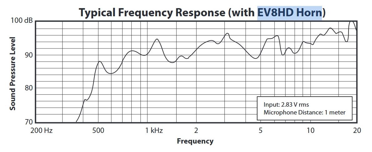

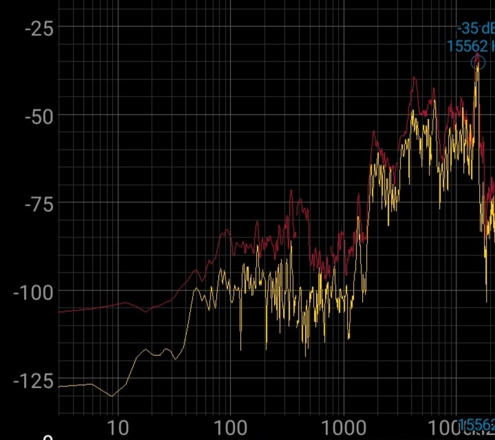

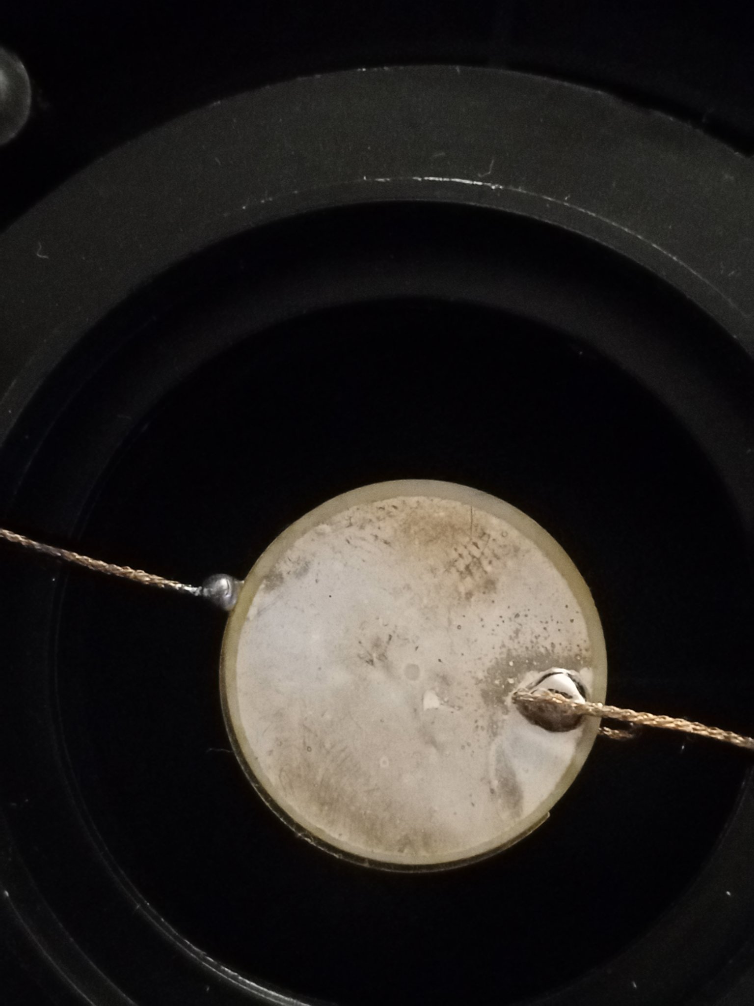

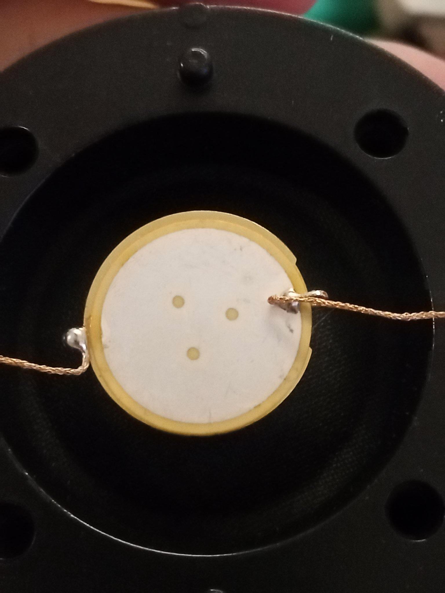

measured both piezos again.
The one with the broader plateau in the lows is the MPT-142.
But in the end not much difference.

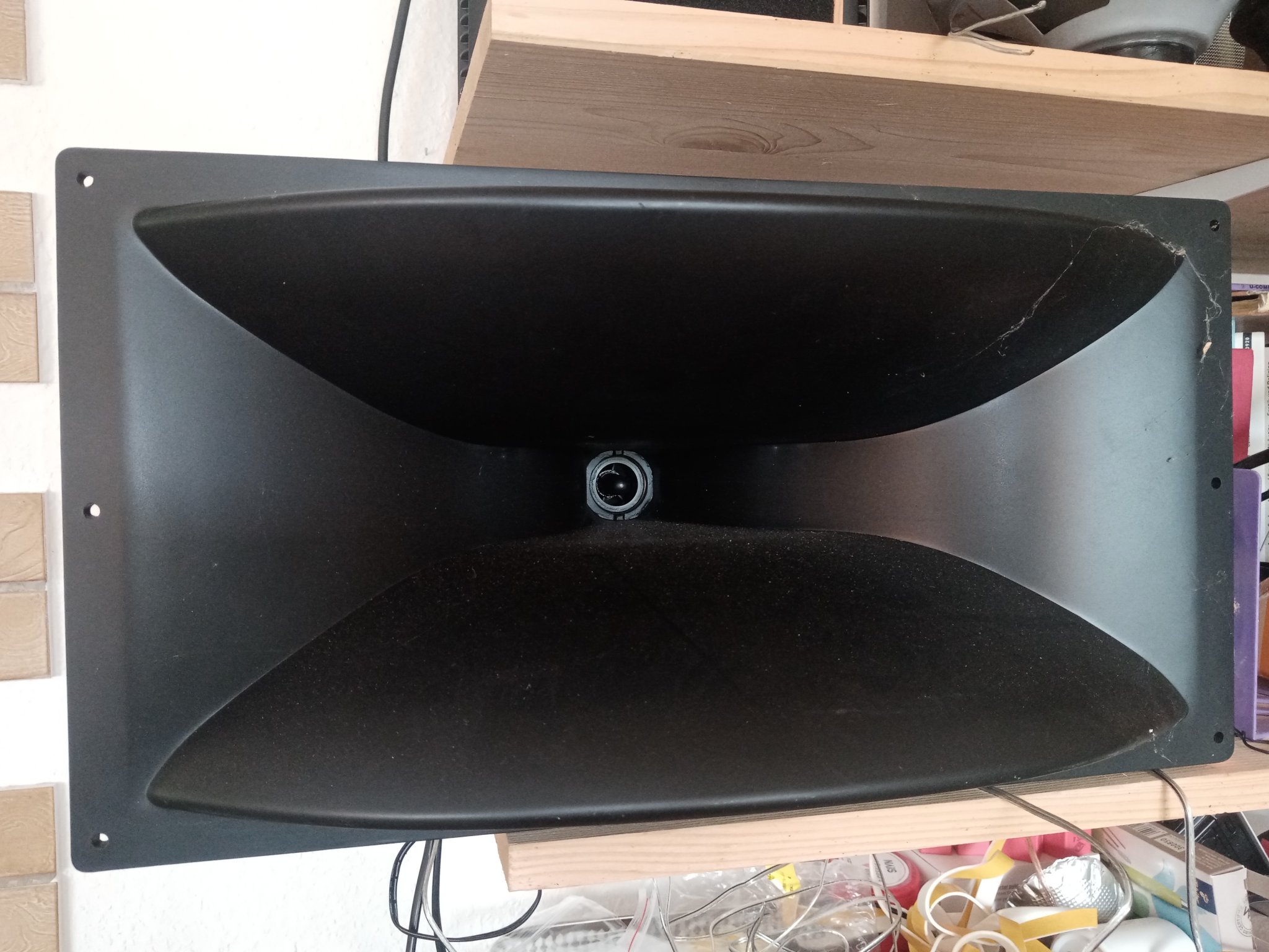

Maybe something could be gained smoothing out the horn throat step with silicone and smoothing the edge of the piezo driver by removing some plastic.
For more power in the mids a true dynamic horn driver is the only way.

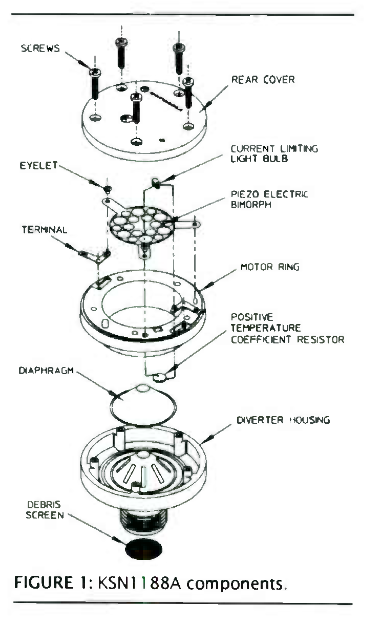

now found an older thread with someone showing original motorola piezo design ksn1142.
Looks like a sophisticated design:
Supported piezo disc helps it to push itself against the paper cone
uneven spread holes in the disc helps it bend itself easier
uneven glued on substrate giving differently distributed dispersion of resonance frequencies
paper giving isolation making the construction airtight
there is something to be learned here!

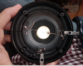

the smaller white round disc on the 1142 could just be some damping of resonances.
Its not part of the piezo disc as it is not electrically connected.
Electrical connection and the mechanical support of the piezo disc is in one integrated element.
