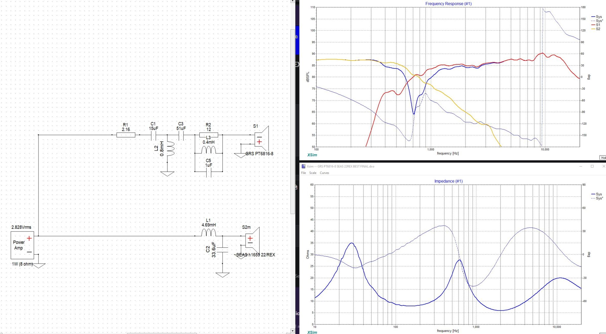

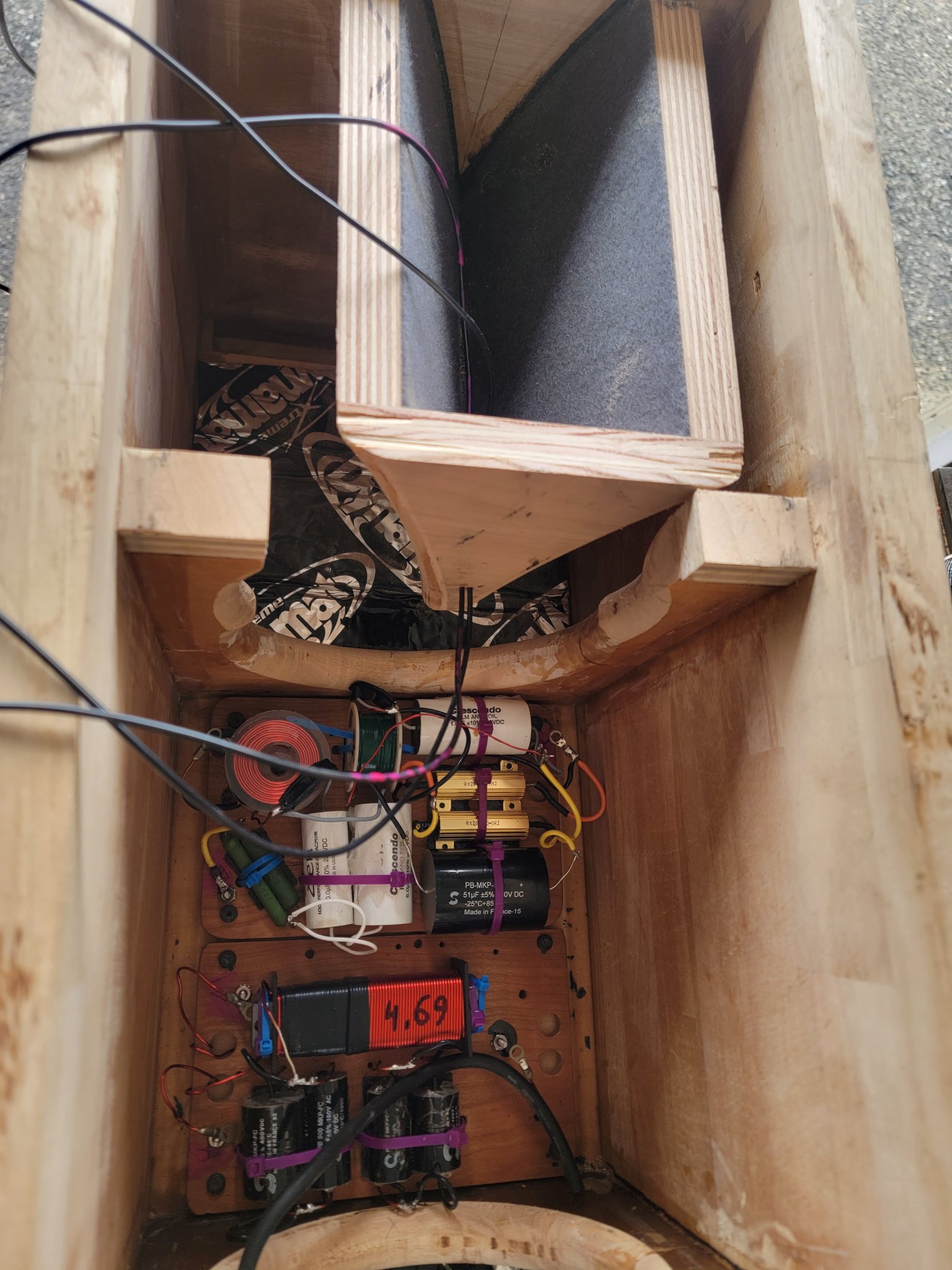

100 VDC for series woofer cap enough?
That's the only 30 uF cap I have
I have 4 -- 51 uF caps that are about 500 VDC

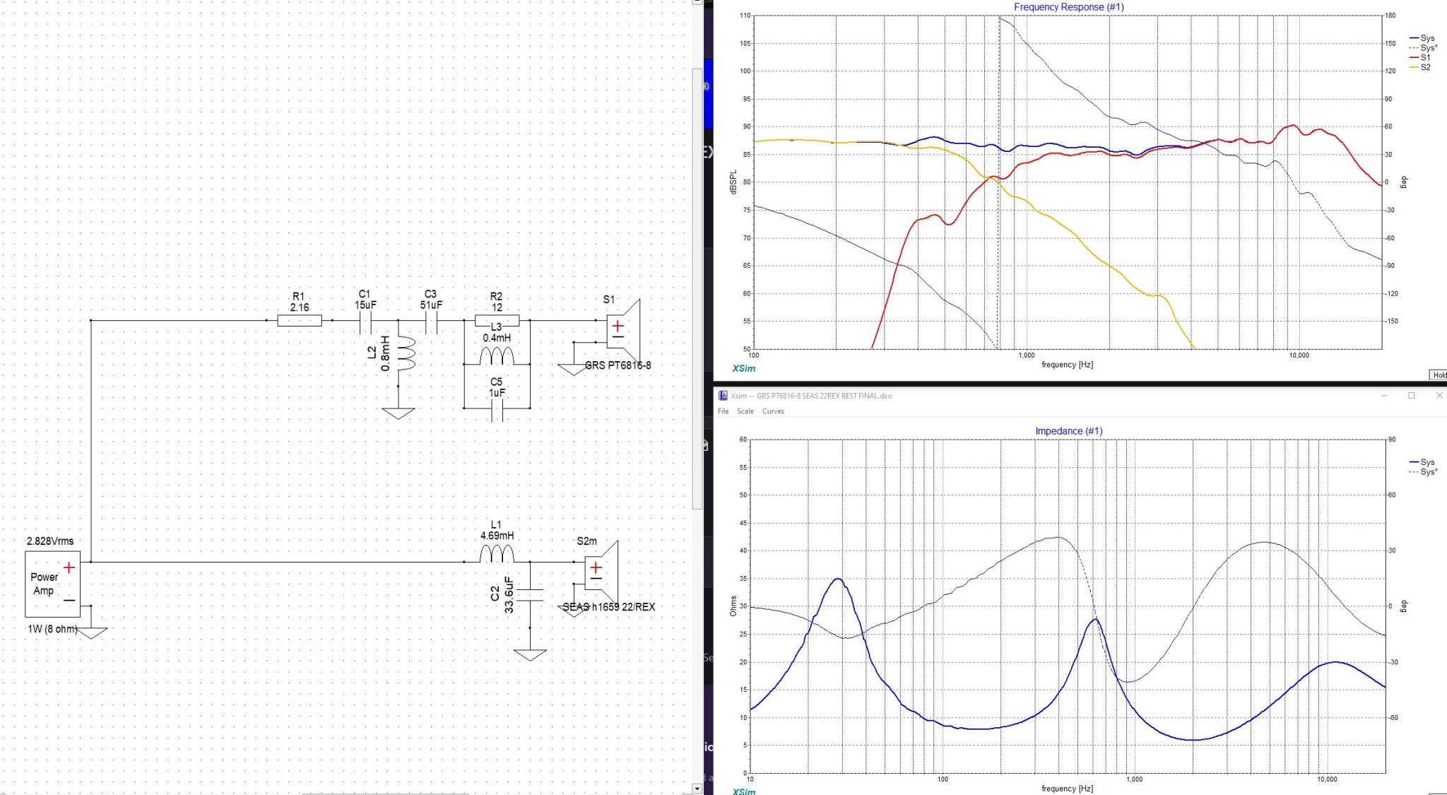

final cross over attached

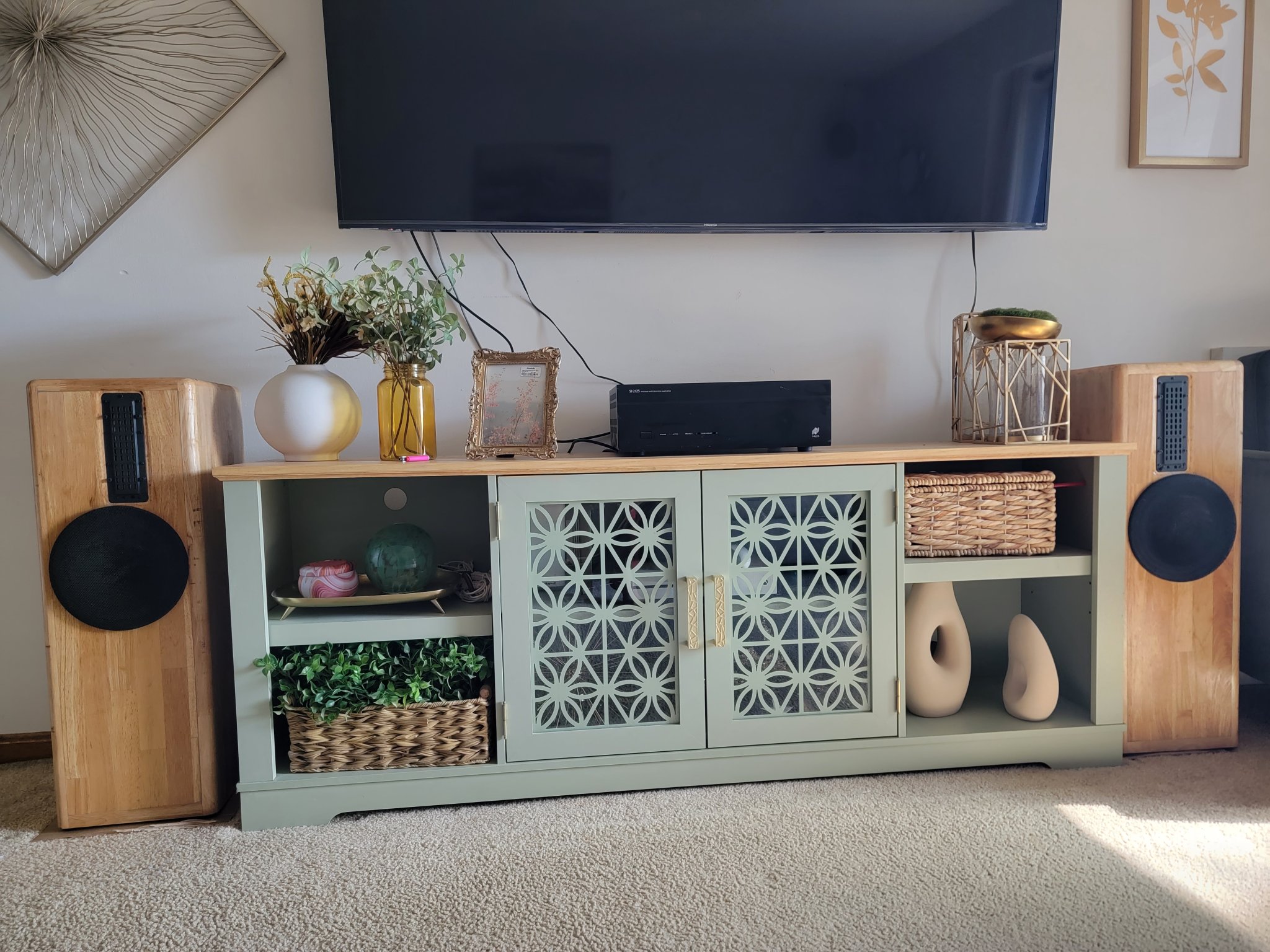

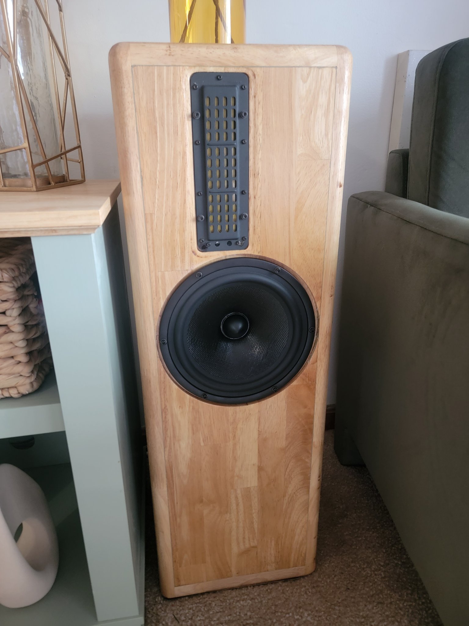

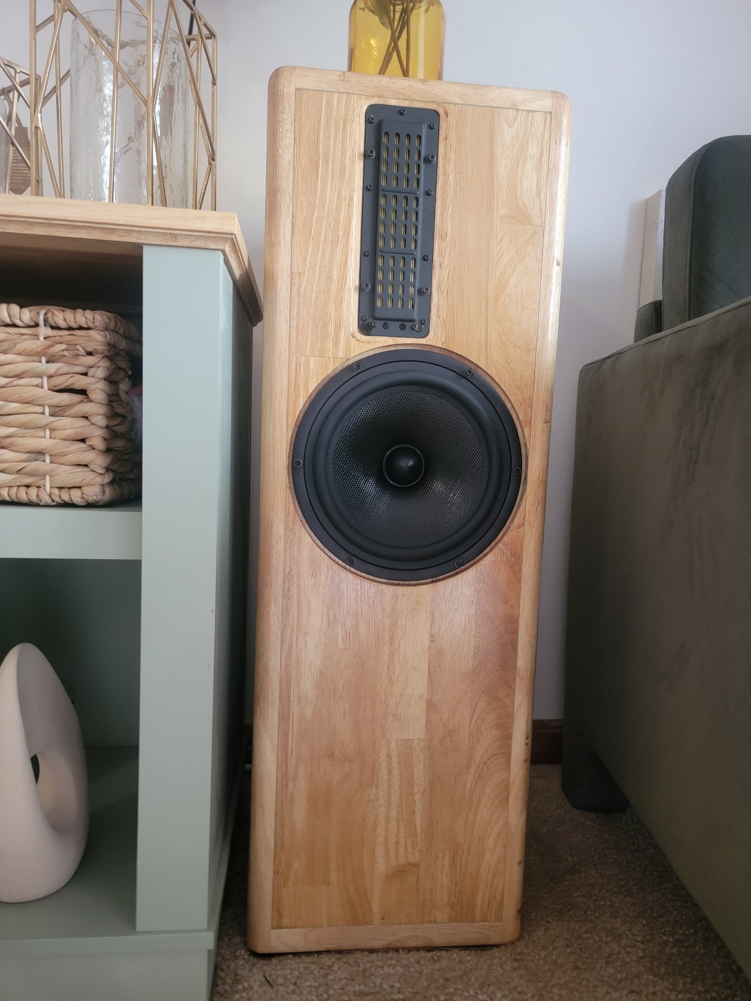

sound is very detailed for 8" woofer
And AMT of course has a lot of detail
bass is good tuned to 20-22 Hz -- 38 liter

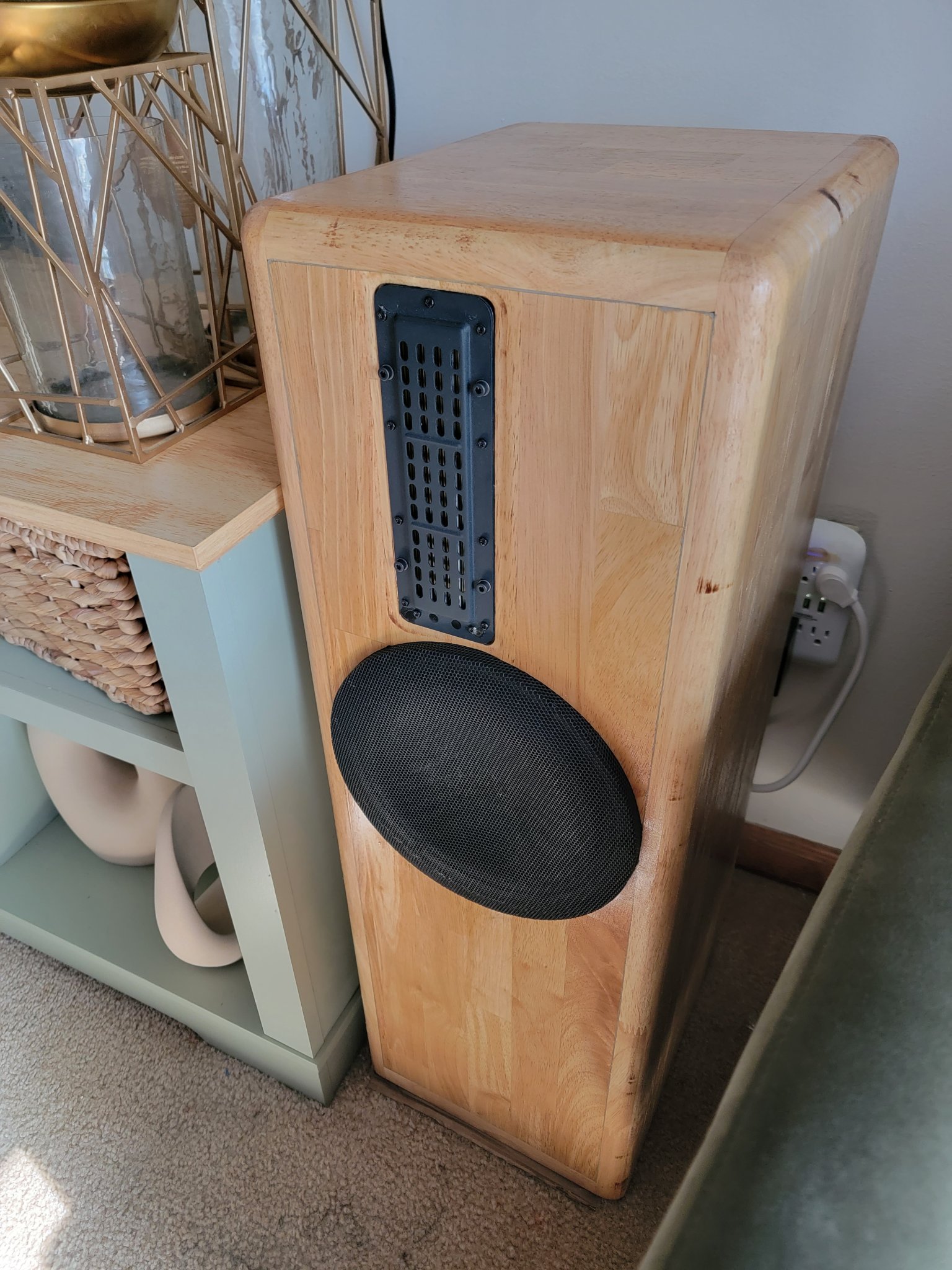

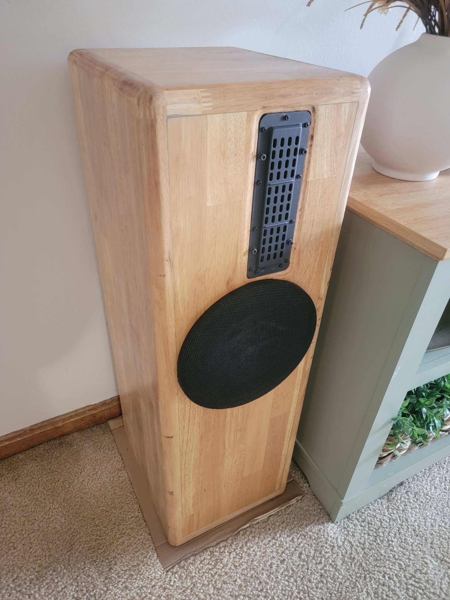

I like SB Acoustics deep bass and beefy/stout build quality, but Seas is a very good woofer.
A lot of detail for an 8" and excellent specs.
Grills weren't big enough for SB Acoustics 234mm outer frame diameter, but Seas 222 mm was fine.

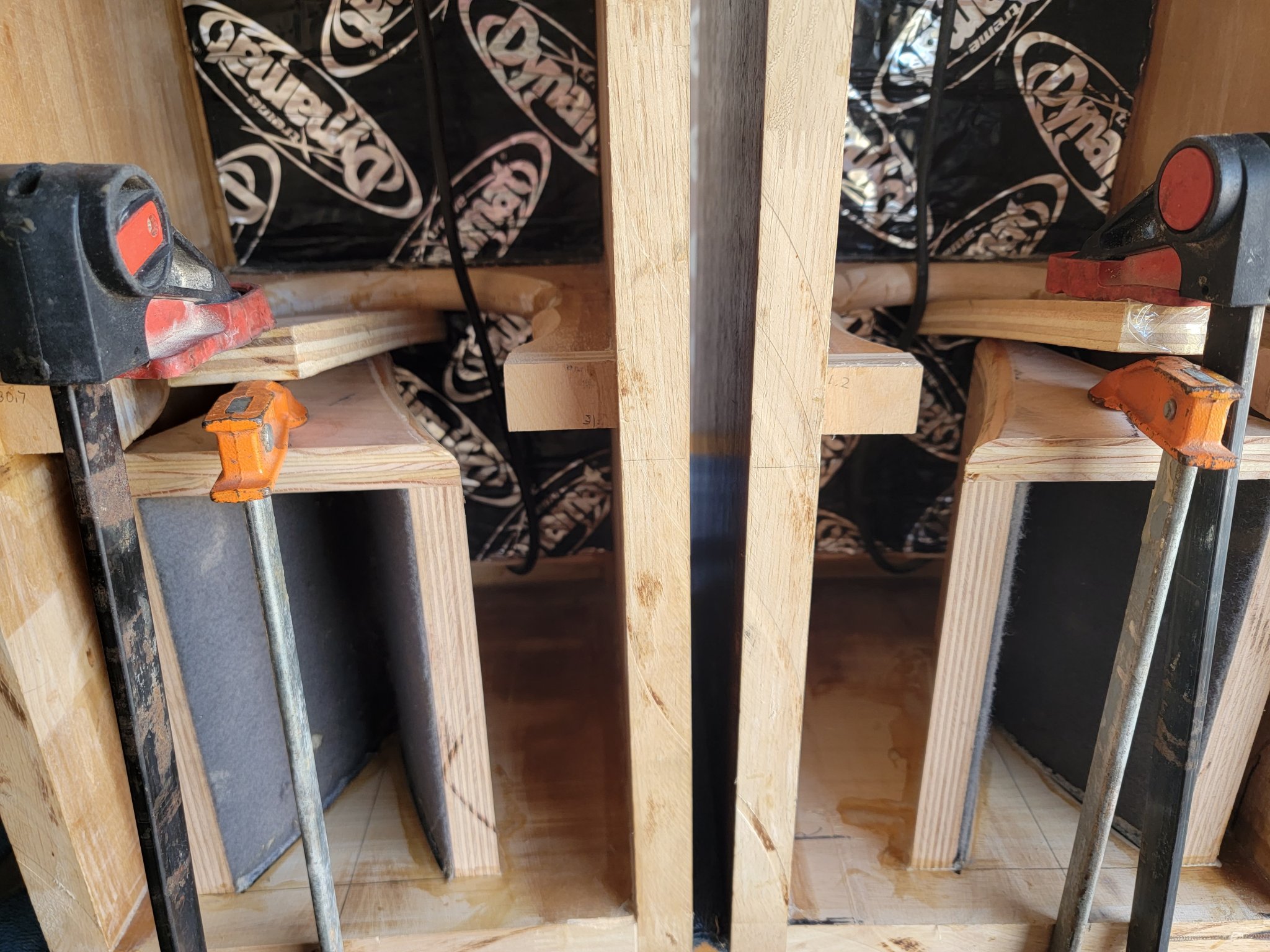

Wound up a little too short maybe.
Small/low volume details are very life-like.
84 cm high, but 94 cm might have been better.
Cross-over is good 5 degrees above axis vertically.
5-15 (maybe 20) degrees horizontally.
The red line in cross-over modelling is 0 degrees on axis vertically and horizontally.
Mundorf drivers/graphs were used to imagine how it would sound off-axis:
https://www.madisound.com/pdf/AMT29CM1.1.pdf
Built for (electronic) music, but mostly TV.
Woofer doesn't move much even at moderate to "loud" volume, but sometimes not a lot of bass.
But also bass is almost never "boomy".
Just add subwoofer if you need more bass 😉
Would be good for jazz and tube amps I would think.
Cat hasn't ruined the AMT drivers yet, so that's good.

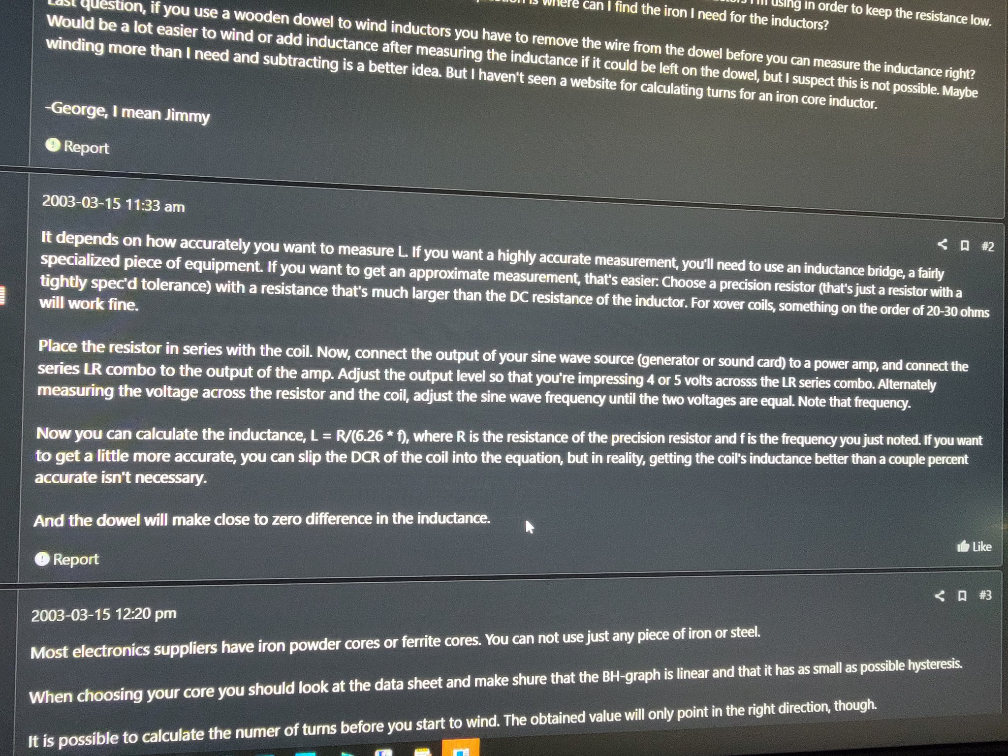

The inductor calculator procedure in the attached pic seems to be very accurate.
Measure a few somewhat expensive inductors and they were spot on, down to about 5/100th's mH or so.

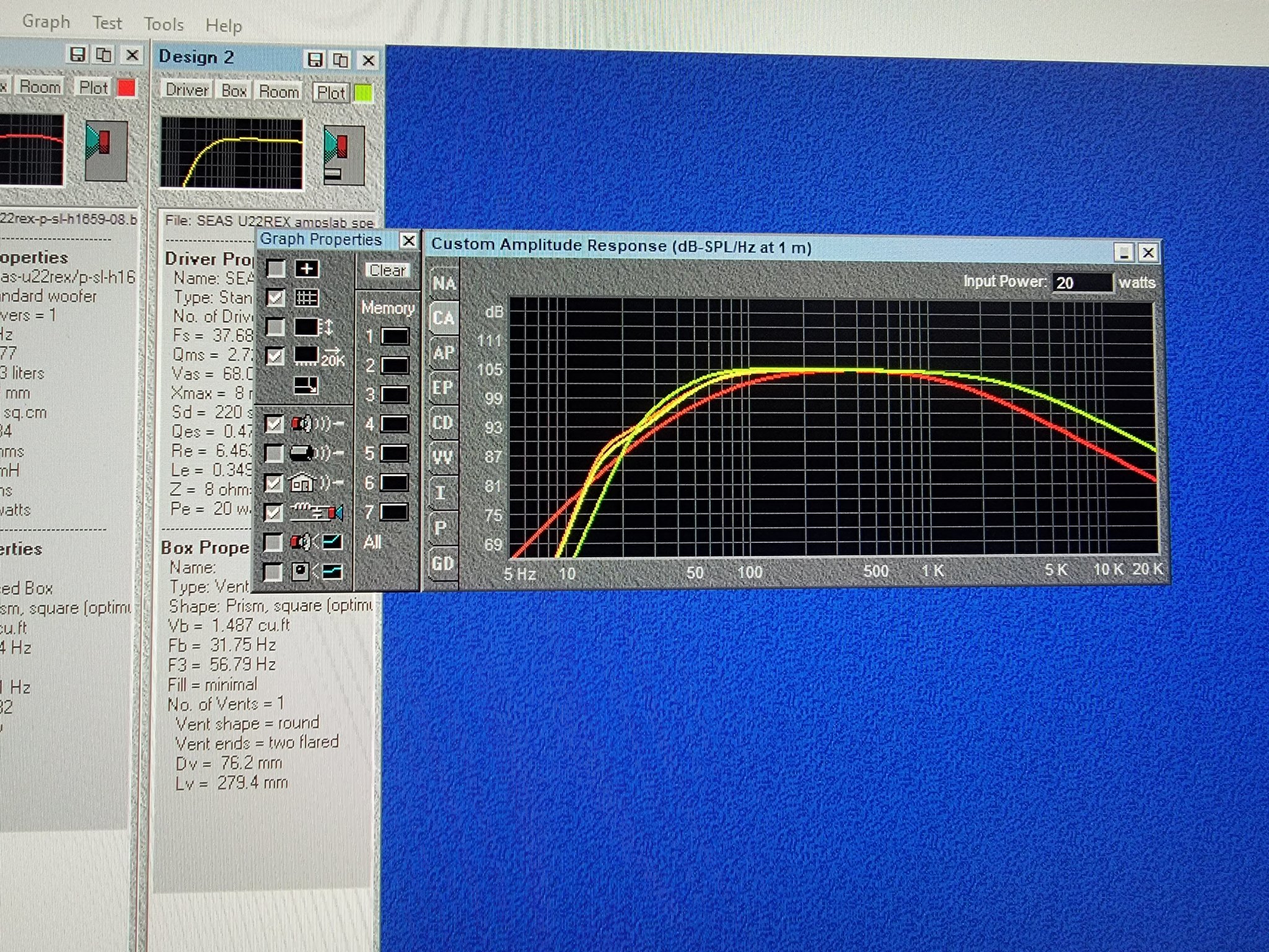

In box modelling (bassbox pro) yellow and orange lines are SEAS 22REX 42 vs 48 liters respectively.
Red line is SEAS 22REX sealed.
Green line is . . . I don't know.
