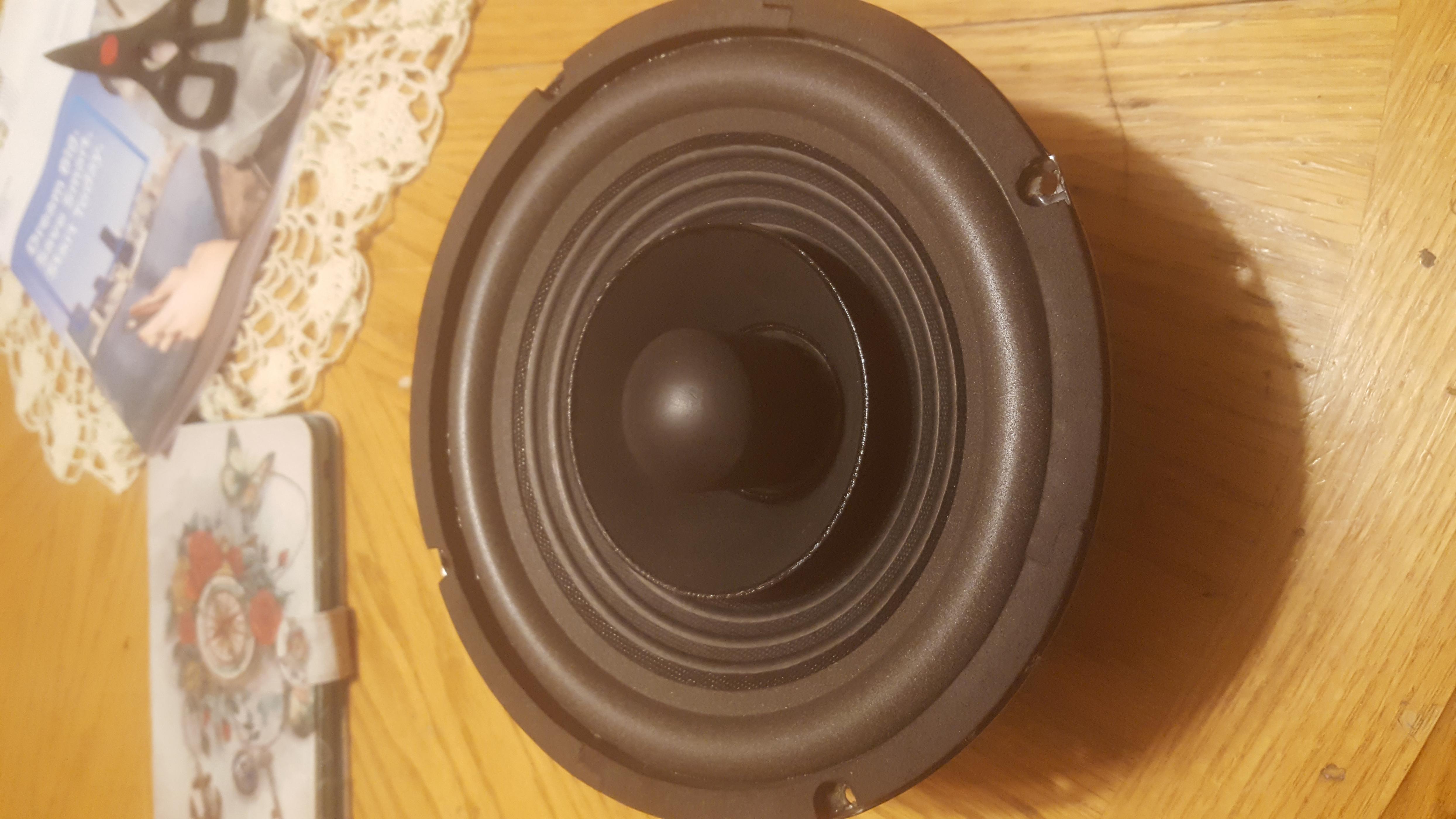

As far as my cone treatment do you foresee any issues? As stated above the rear of cone treated, front of cone treated only on outer rib to surround and area directly behind the whizzer ( I do intend on reattatching them). I also only treated the outer bell/lip front & rear on the whizzer cone.
I just wanted a two- tone look for aesthetic reasons. Front or rear treatment is there an audible difference?The jury is still out on if I will attempt your pattern.....not because I have doubts on your method (acrylic paint?) but simply because of my 53 yr old unsteady hands. Lol

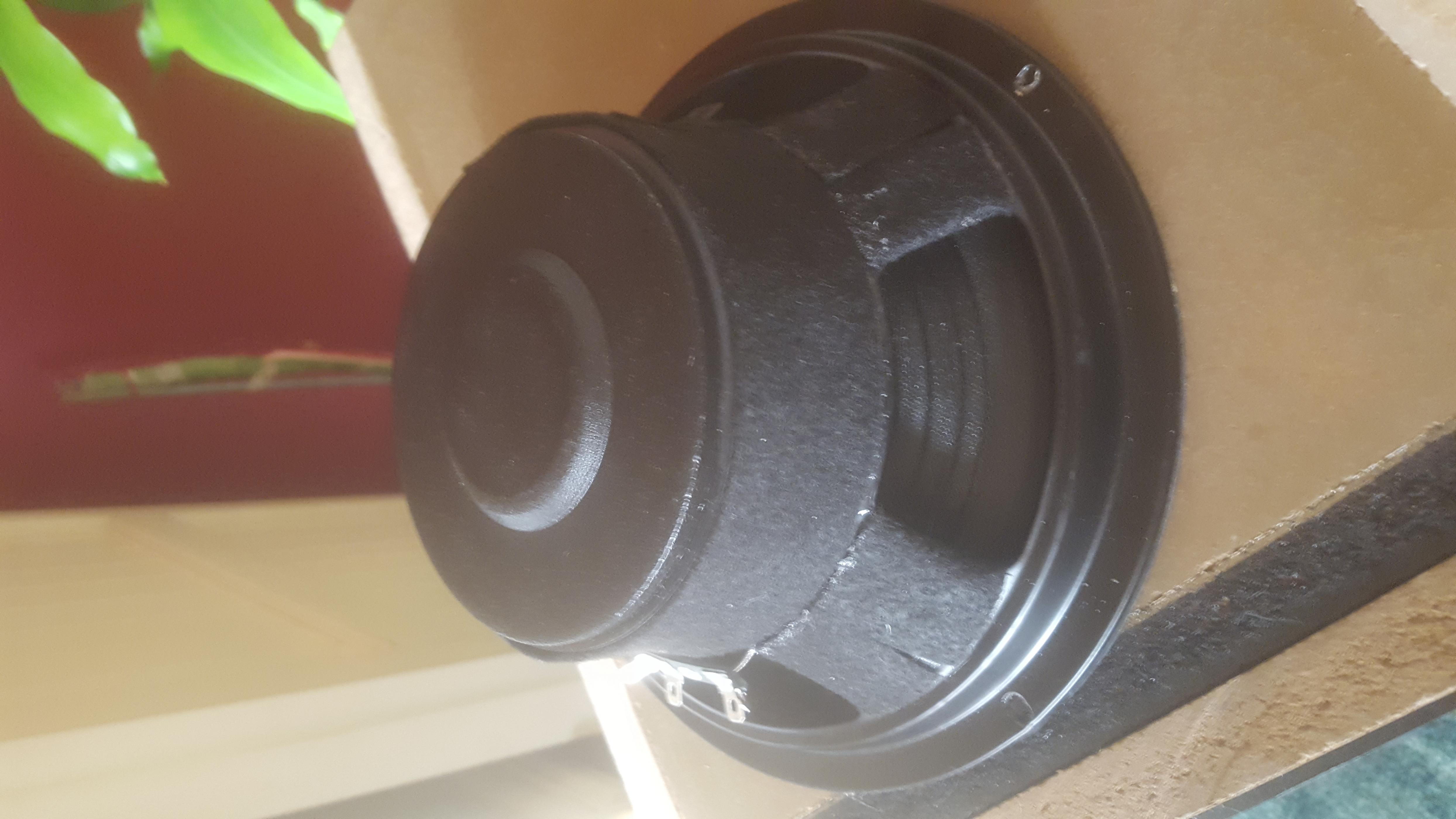

As to the drivers I did complete my goals. Treatments include: duct seal on inner legs of frame and front plate/magnet structure then wrapped with felt. 1 coat of Hodgepodge cone/whizzer with second coat on outercone near the surround and on the whizzer's outward perimeter. Removed dust cap, added pvc " phase plug".

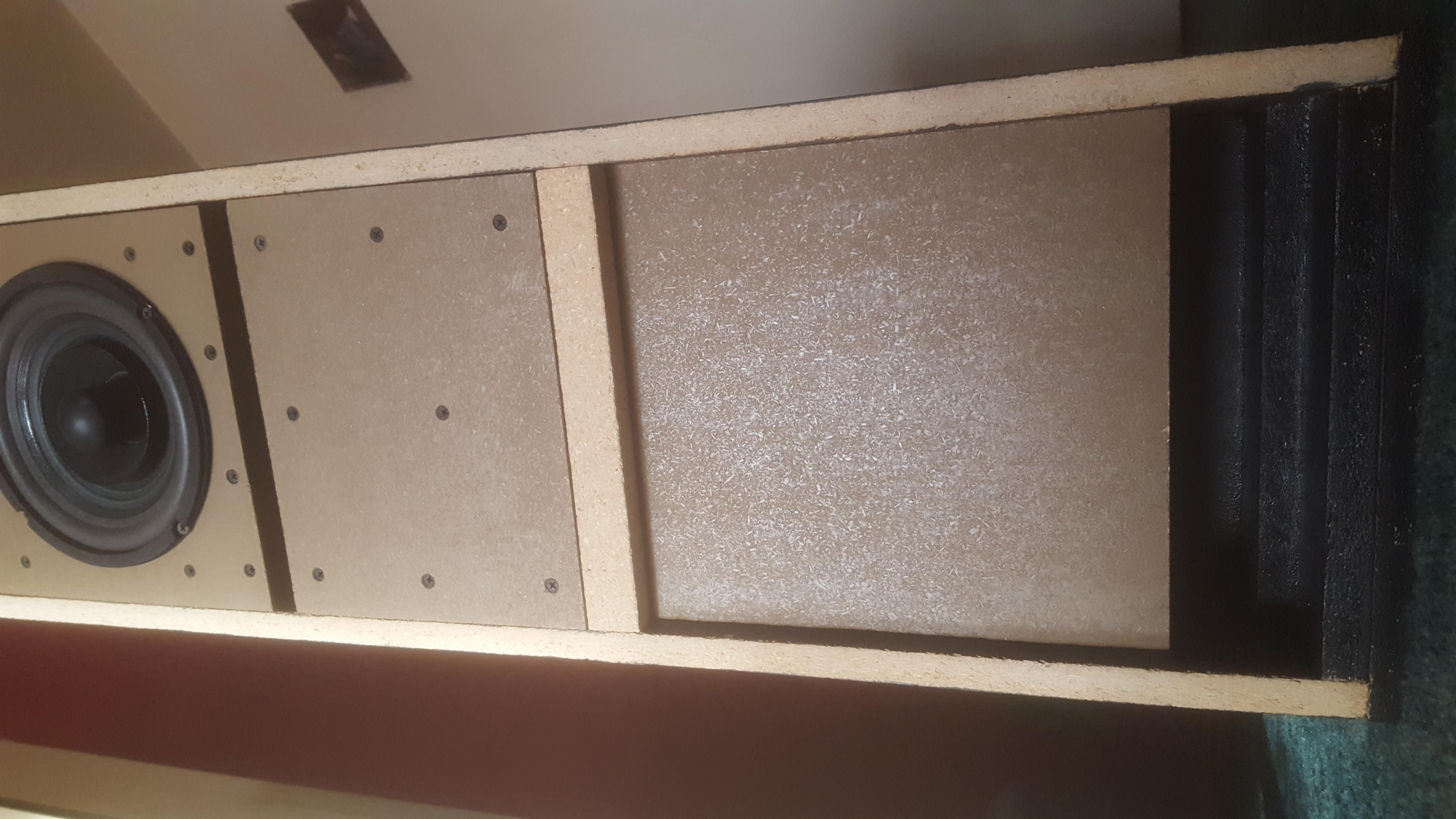

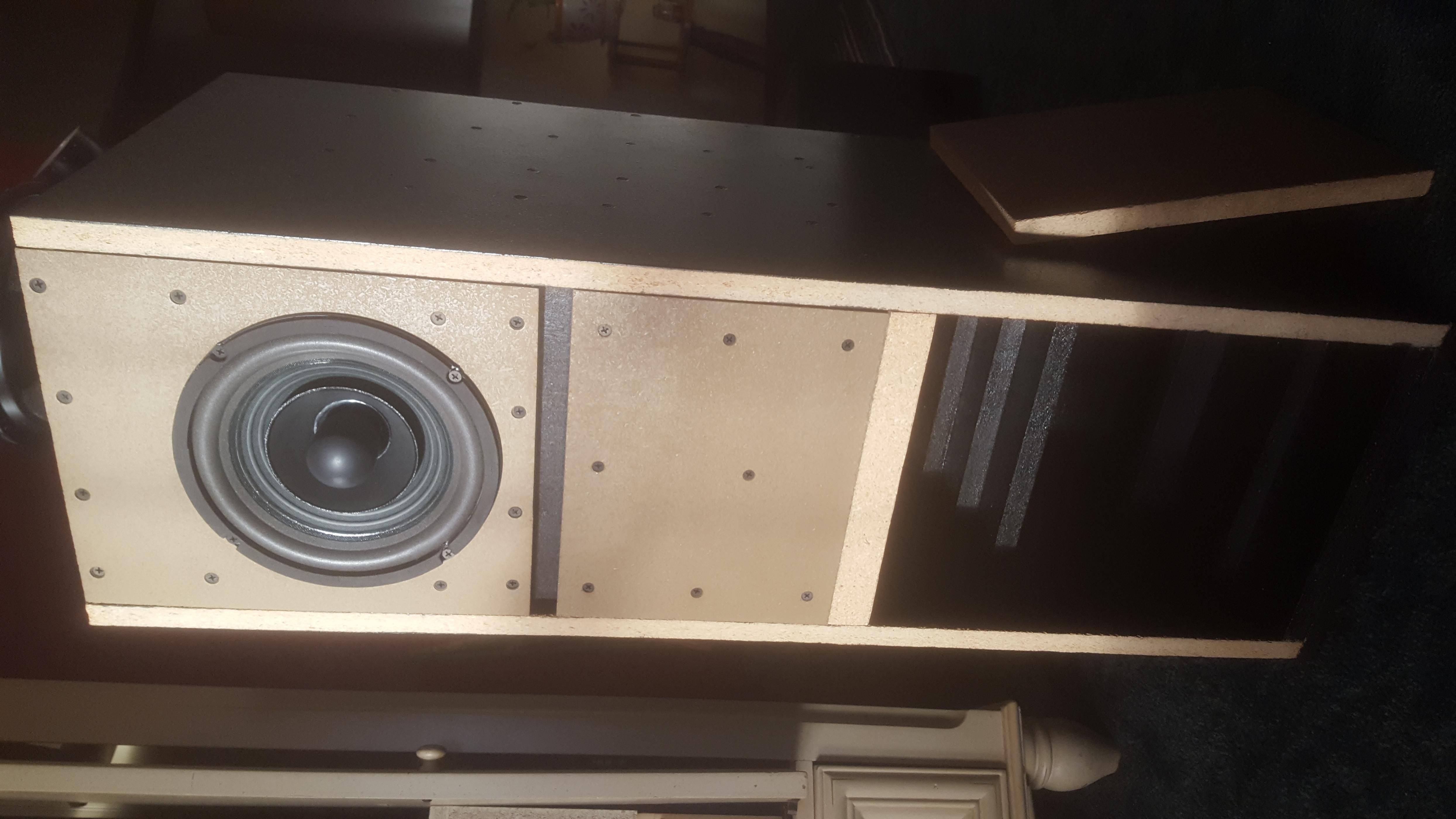

As to the cabs? Lol. Yeah, yeah was given another 3/4 sheet of partical board ( same 3/4" ). What do you do with "extra" material? Why do something silly with it of course.

Overall the drivers response is smoother, more open, and not as bright/brittle/harsh to my ears. Less fatiguing. They don't seem to have lost any high frequencies either, although not empirical ( no test equip ).

The cabs are obviously not suited for these drivers ( I just they looked " cool". Lol. A hollow ringing from the mouth.

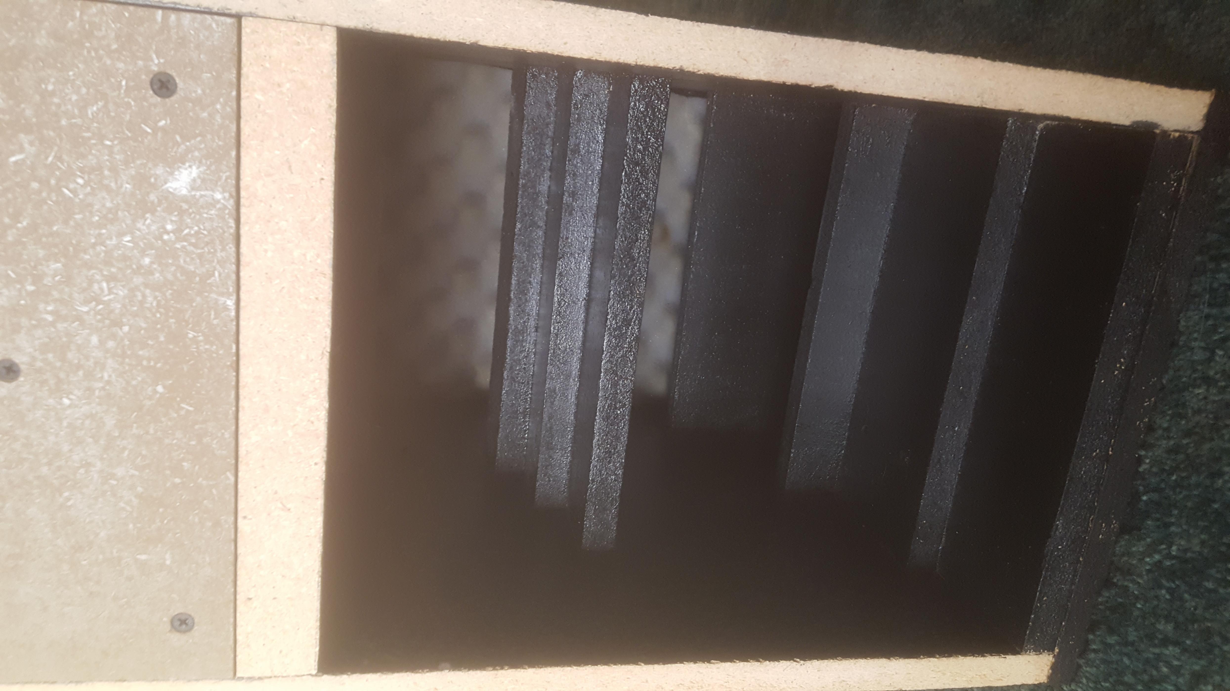

I do plan on building proper cabs as per suggestions fairly soon ( prob sealed ), I'm sure the overall sound will improve. I just liked the look and had a morbid curiosity on building those blh....... even with all 90° cuts, what a p.i.t.a. Never again. Lol. I will keep the cabs,( too much work to just toss out) and perhaps find some better suited drivers with a lower qts down the line.
