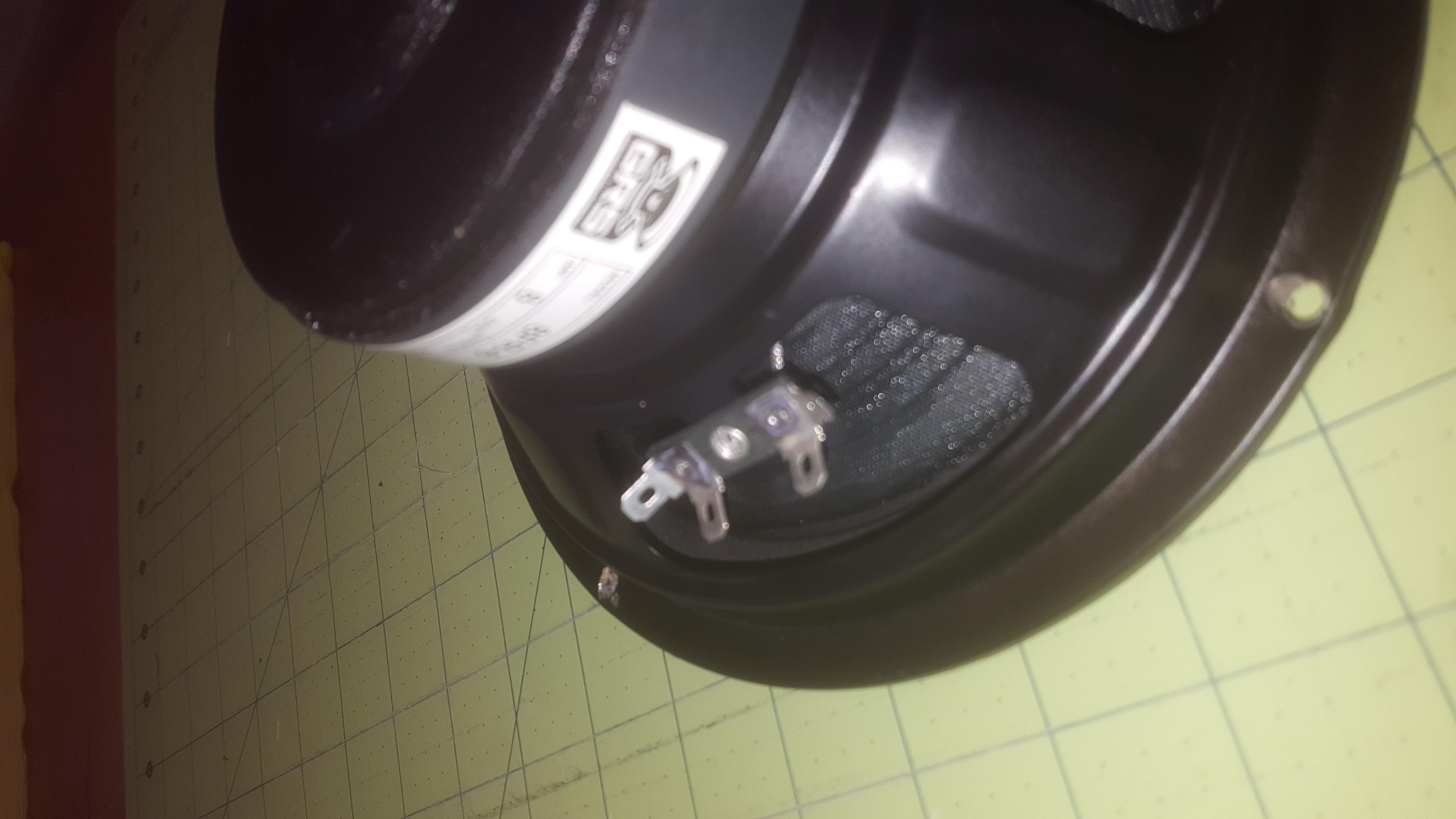

I have 2 pair of these drivers, plan to leave one pair stock and modify the other to compare how much can be done to improve their sound. Will be using them as a stand alone speaker system in 2ch up to moderate music levels, no sub ( but avail ), no tweeter ( although I do have a pair of Optimus Linaeum ET-6 tweeters @ my disposal).Mind you I have no test equipment, and a no to low budget to work with. I have the drivers plus 2 full sheets of 3/4" particle board, screws, glue, polyfill etc. to work with.
With that being said, how would one go about the simplest approach to achieve the best results possible? As to the drivers themselves ; Remove dust cap and replace with a phase plug, keep or remove whizzer cone, dampen basket, perhaps dampen the cone ( dope, felt ) etc.

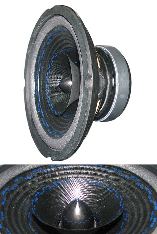

I went to town on at least 1 set of BOFO, the same mods could be used on the GRS.’'

I have not played with a lot of shapes for phase plugs. IIRC the BOFU used the Visaton B200 plugs. Cone was puzzlecoated, then EnABLed. Whizzers got a GM massage. Baskets duct-sealed. Maybe, cotton felt on the inside of the basket legs.
I did them a long time ago, EnABL2 might (likely) move the ring placement.
dave
From a 2000? write up of a RS 40-1354 vented tower system [aka MLTL nowadays]:
"Radio Shack 40-1354 modded by trimming off the gasket flush with the metal frame lip, 3/4" thick polyfil stuffed between cone/whizzer and held in place with a rubber band, epoxied magnet assembly to the frame, added a foil star to the center of the dustcap (much good natured wise-cracking over this), damped the frame with gutter/drain/roof foil backed repair tape, used resilient caulk to install 3/4" polyfil squares to the inside of the frame legs, and added thinned rubber cement on bell lip of the whizzer after softening them with my fingers."

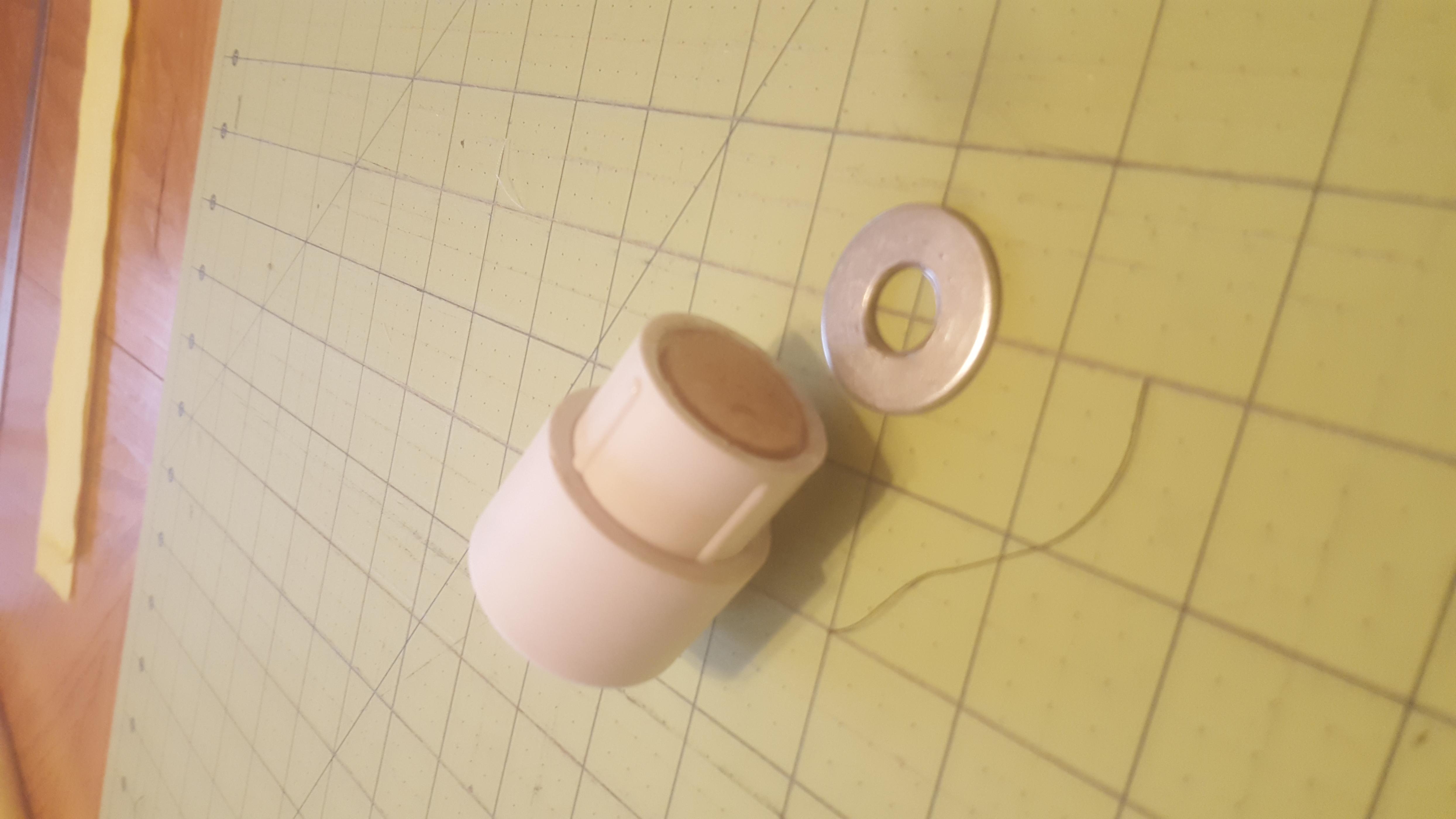

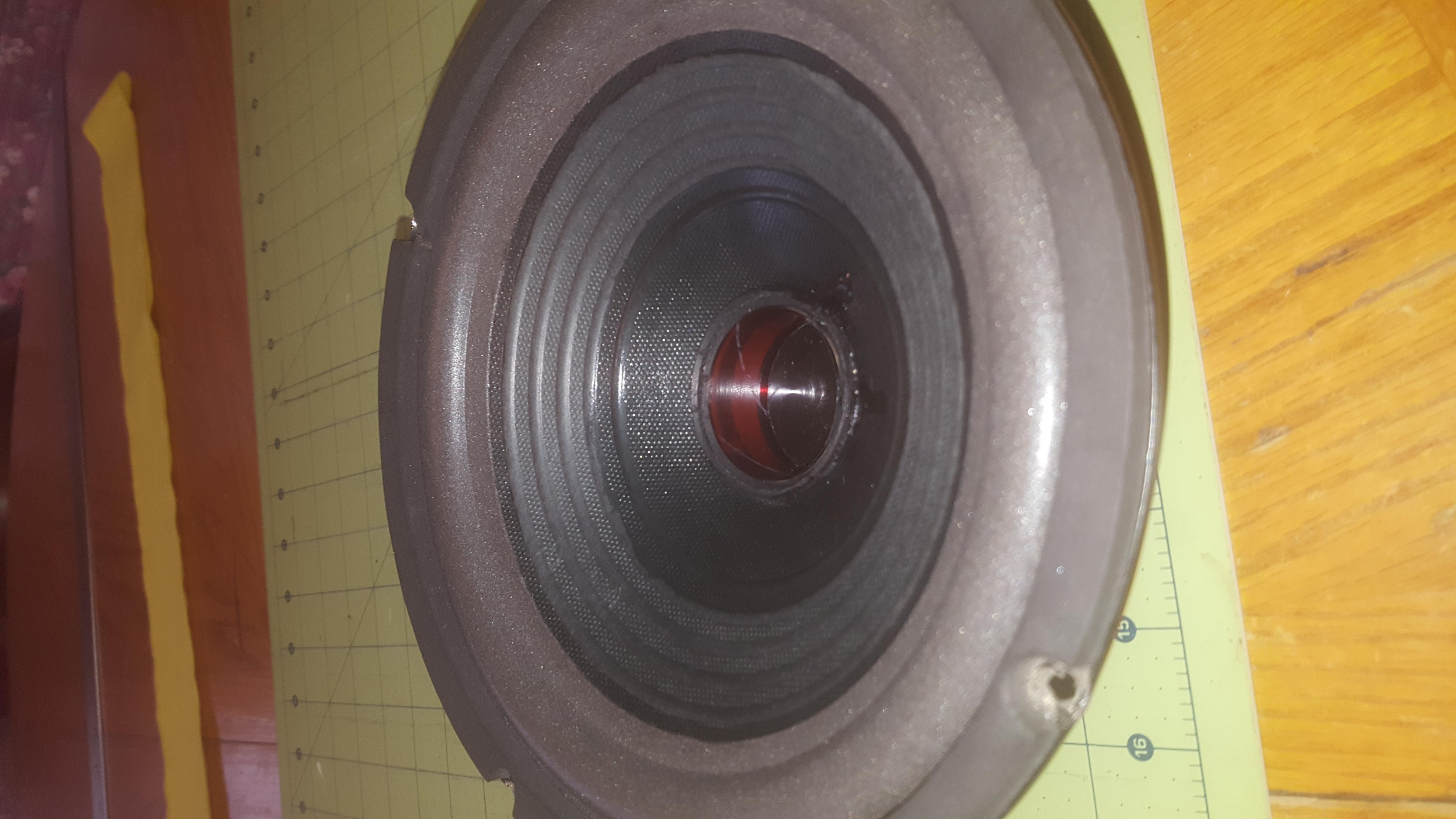

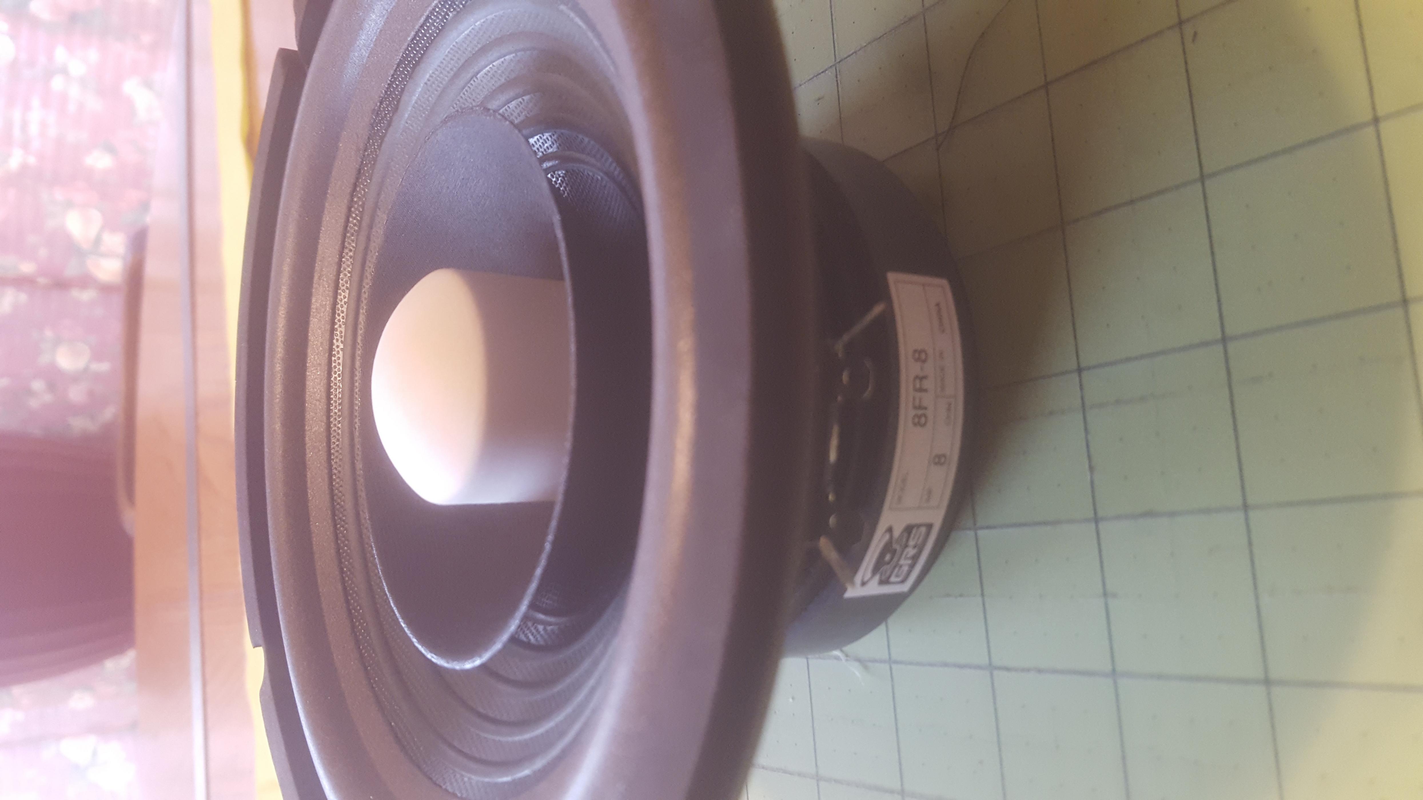

I could not get to starting the cabs this weekend so I decided to start working on the drivers. In my haste to start SOMETHING on these I inadvertently cut a whizzer off. So I decided to repeat my mistake on the other. Lol. Then I attacked the dustcaps.
So not having a clue as to Modpodge/water mix I tested on a sheet of poster board. I ended up with a 4:1 solution that did not distort my test sample.
Working on the phaseplugs. I already cut 1/2" of its length and inserted wooden dowel inside. I need to increase dia so as to leave a smaller concentric gap to the voice coil. Attatch washer and paint. PVC pieces parts (that's all I have to work with)
