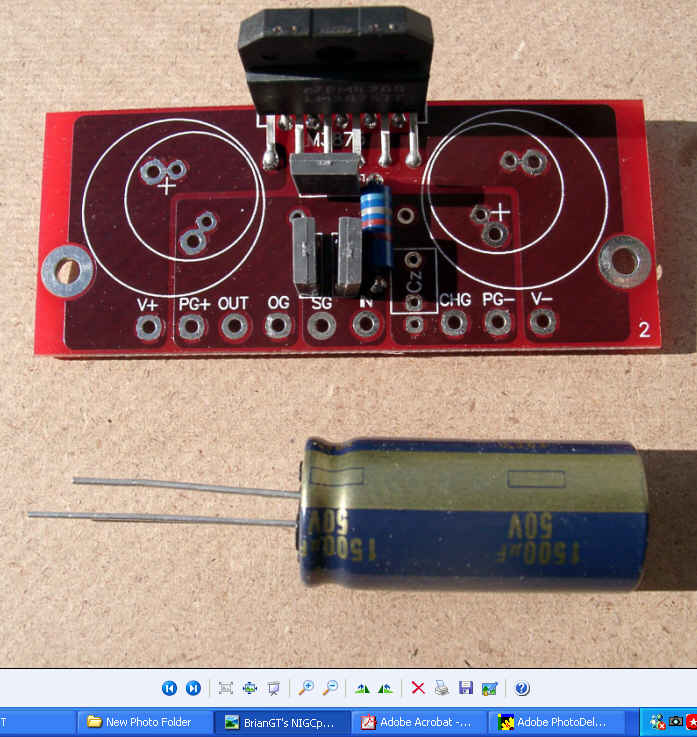

Please clarify this for me
Below is photo of my BrianGT PCB. I'm about ready to install Blackgate caps but when set in place the caps don't match the manual photo. I'm thinking the manual photo is from the first board design and the caps are mounted slightly differently than new pcbs. Could someone knowledgeable answer.
The caps are not marked + or -, although there is a gold strip with a retangular box which May represent a negative sign. It so happens this gold strip is also on shortest connector wire side.

The stripe is minus, long wire is plus. You will also notice a couple minus characters on the stripe 🙂
Thanks for your response.
I was thinking the long wire was plus and wasn't sure about the gold strip. I am using a magnifier glass and don't see any + or - text. I'll finish up the board in a few more minutes.

Phil,
That big square on the side IS the minus sign on the cap. I doubt there is text. It's looking good- did you put the NFB resistor on the opposite side?
