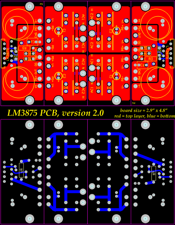

Here is a picture of the version 2.0 board for the LM3875. Here is a list of differences:
- extra rectifier board, so only one pcb set needed for monoblocks
- placement for the feedback resistor on the pcb (can still be soldered directly to the chip
- zobel network added, optional, but recommended if stability issues arise
- slightly changed routing and planes
- ground planes on rectifier board
I am working on a new order page now, to start taking orders. I am looking to order the new pcbs next week with a 1 week turn-around time.

bigparsnip said:
I see you put both chips on the outside of the board this time too, so people can bild them both onto heatsinks without needing to snap the board up into the four loses sections.
This is certainly an option, but I prefer the monoblock configuration, with the boards piggybacked together. The mounting holes and power connections align between the 2 boards.
Brian
Brian
Brian,
Beautiful work! I've been using your original design as a starting point to learn a little about designing PCBs and for me the learning curve is steep. I added a Zobel to your original design but I think this V2 just looks so much "cleaner" than what I've been able to do. :bawling:
The problem for me now is that I have to decide between ordering a V2 LM3875 kit or one of your 48xx kits! (Maybe I can talk the "boss" into both.)
Sherman said:
Brian,
Good luck with your "boss". The LM3875 kits should hopefully start shipping out again in 2 weeks after I start taking orders. I am ordering the pcbs with 1 week turn-around, while the LM4780 will take longer, since I still need to finalize the design.
