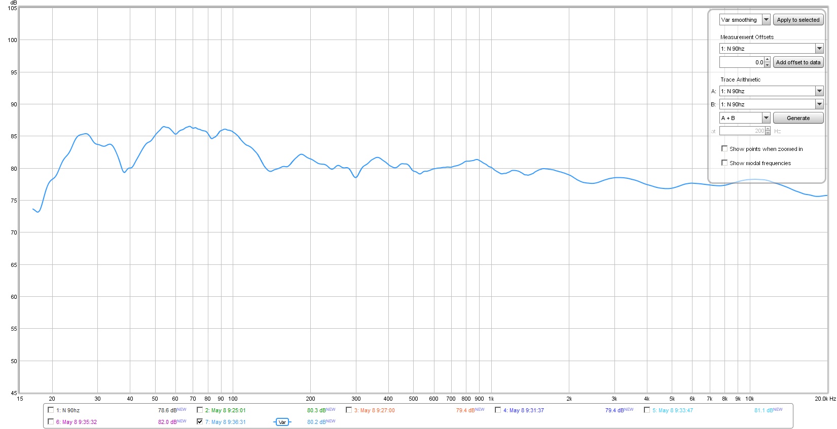

Having played all morning on the issue, what i have discovered is that the only way to reduce the 40hz GD is to remove those frequencies from the FR. Any which way I try to add them, whether from mains or subs, adds the unwanted delay. Seemingly, its a room characteristic. Perhaps a room mode.

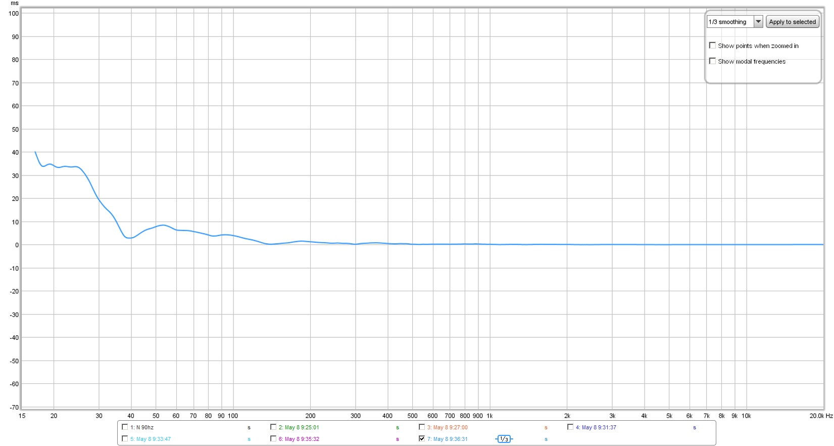

Your plot of the mains only shows group delay at 40 Hz. Your subs follow in phase judging by the FR plot. As soon as you made the subs play earlier, the sum at 40 Hz was off.
Doing the same with a miniDSP isn't going to get you different summing at 40 Hz if you ask me? The delay at 40 Hz, will be partly from the ported mains / partly the room. But the subs do seem to be in phase with the mains right now.

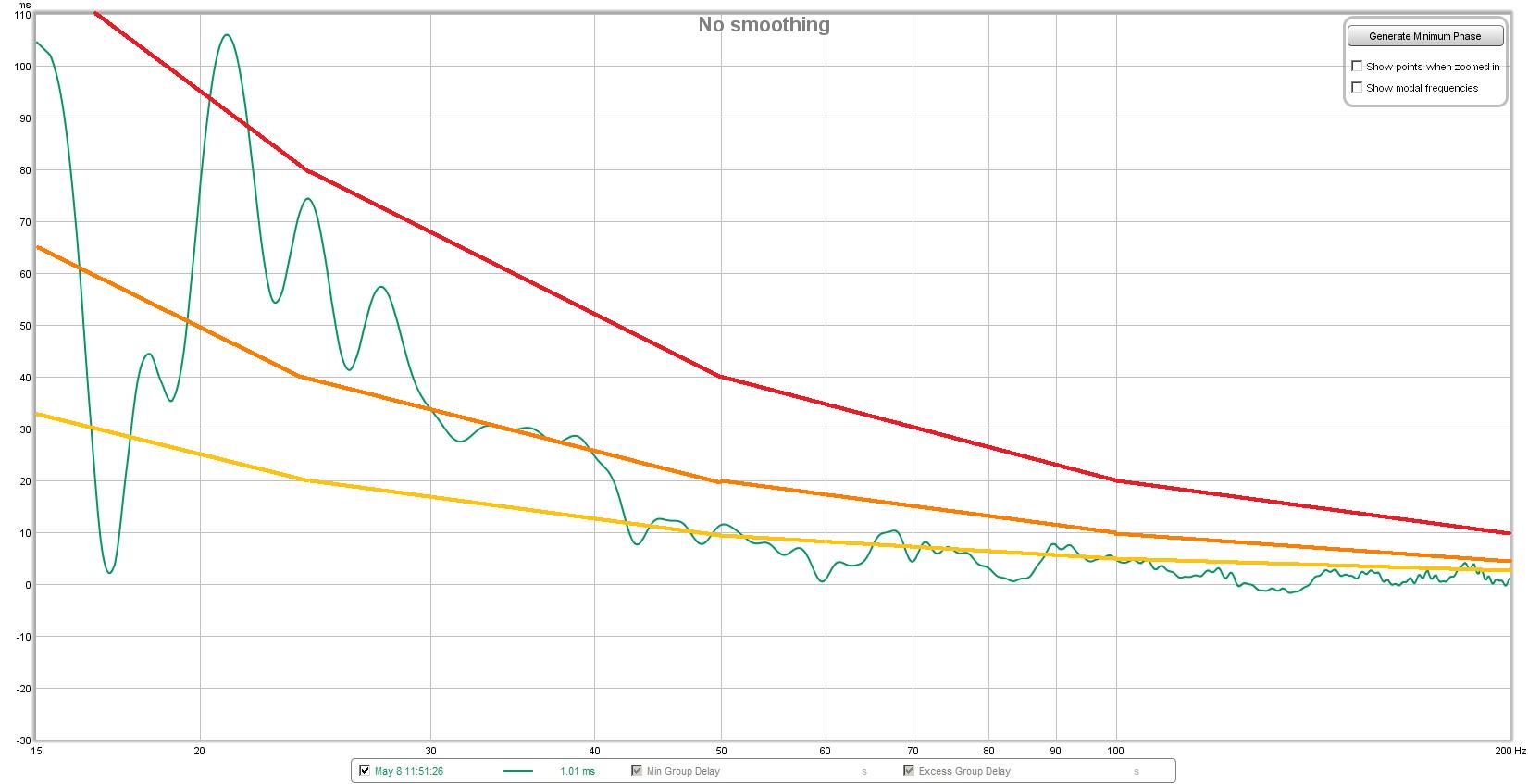

In one scenario, I may XO the mains higher than 40hz to minimize the GD of the mains at 40hz. And then blend in the subs.
In a second scenario, where the DSP controls only the subs, your right, that wont address the GD of the mains. But I could XO the subs even lower and/or with milder slopes, to minimize the GD the subs are adding.

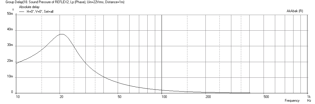

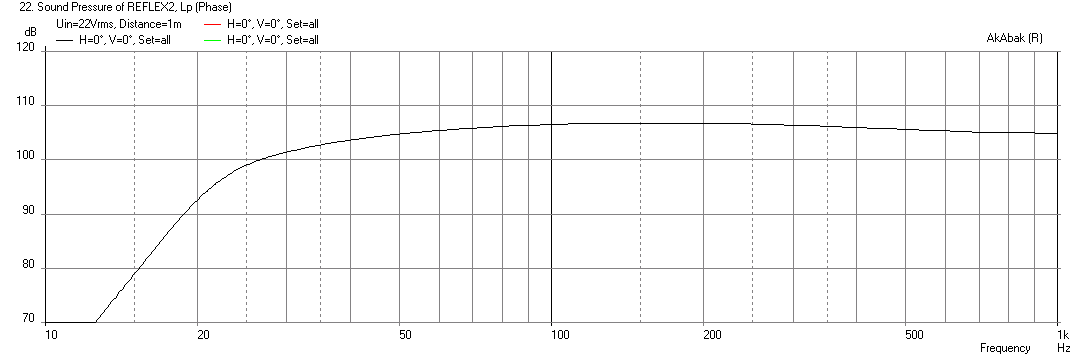

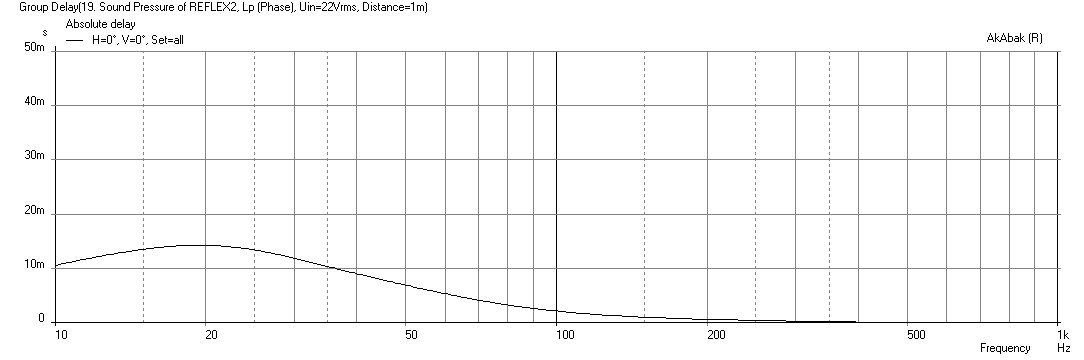

Predictions of GD

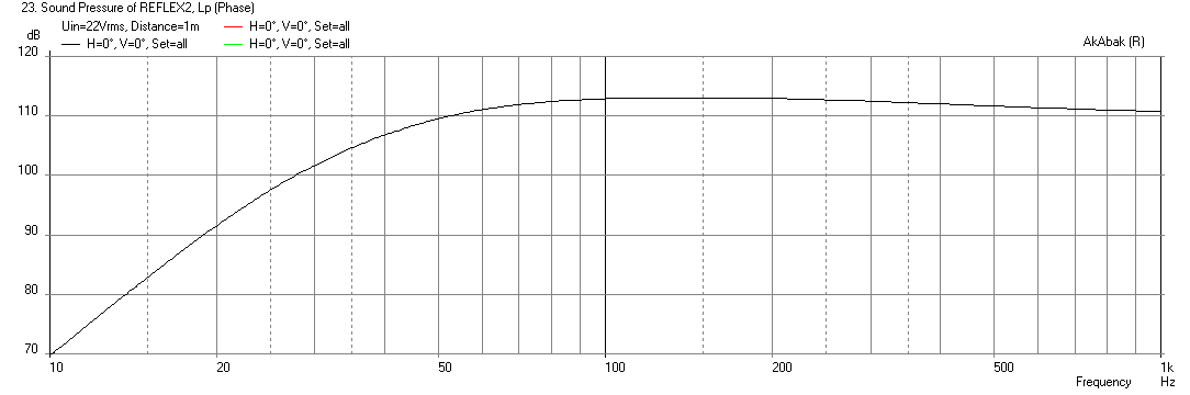

Here are some quick sims of the idealized system of a bass reflex and two sealed boxes using the T/S parameters (Acoustic Concepts AC10R) you provided along with the box alignments. I assumed a slightly overdamped system to extract the best transient response. Also assumed use of a 2nd order Butterworth high pass at 30Hz for the bass reflex and at 22Hz for the sealed boxes in order to keep the xmax under 7mm at 24 volts.
This is assuming no reflections or boundary effects of the room - in 4pi anechoic space.
Here is the frequency response with bass reflex (BR) only:

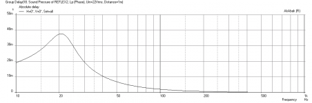

This is the GD for the BR only (10.5ms at 40Hz and 19.3ms at 30Hz):

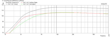

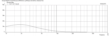

Here is the frequency response of the two sealed subs:
This is the GD for the two sealed subs (9.09ms at 40Hz and 11.9ms at 30Hz):

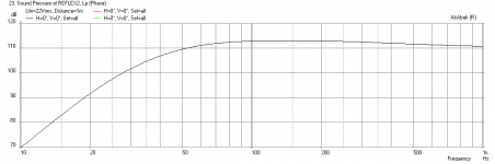

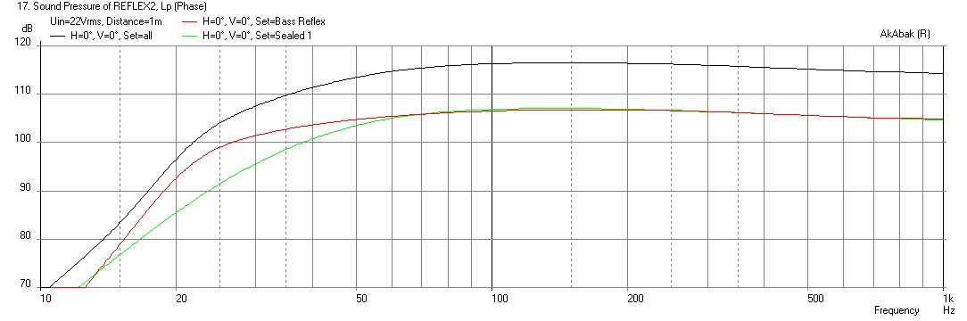

Here is the combined frequency response for all three (only one sealed is show, overall is black):

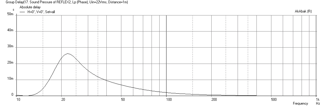

Here is the overall GD for the whole system assuming all three subs are located at same location in space (a physical impossibility but used to show best case) the best you can get is 9.7ms at 40Hz and 15.8ms at 30Hz. It seems that combining the BR with the two sealed boxes is a good call as it brings the GD down to 15.8ms from 19.3ms if you only used the BR by itself:
If you tweak the high pass filters or remove them, you could get less GD but then max SPL will go down. I don't think 16ms GD at 30Hz is bad and that can be your goal to achieve by arrangement of locations of the subs and the filters you use, time delays etc.

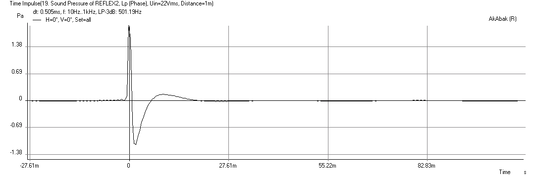

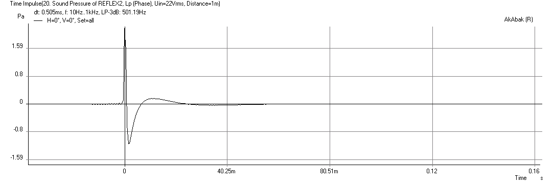

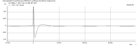

I also looked at the impulse responses for both the BR and sealed cases and they look fine - with no inherent box induced delays that may require time alignment for internal propagation delay like would exist with a bass horn.
BR only IR:
Sealed only IR:
BR only IR:
Sealed only IR:
