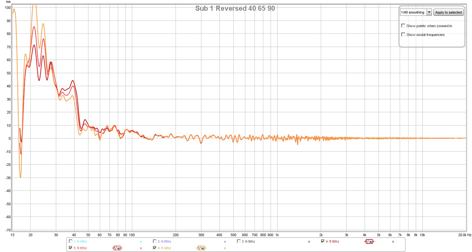

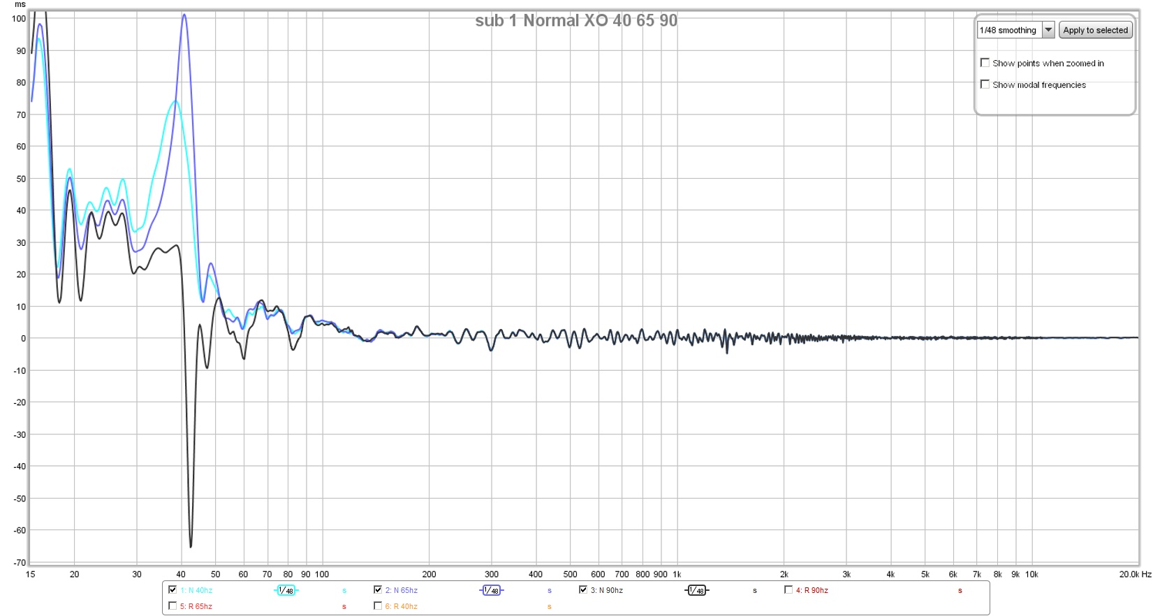

Jim1961 results in room look very good to me at the listening spot. But I think the arrival of the first wave determines the sense of timing. Look at a gated plot and see what the GD line looks like gated at ~50 ms. No way I could get a clean group delay at the listening position like the one posted by Jim due to room disturbance. Yet the timing from my arrays feels very accurate.
I bet drums sound very convincing with the plot shown, at the right SPL levels and with a good FR plot to go with that GD plot.
I agree that the 80Hz to 100Hz range for the 2nd harmonic of the 50Hz kick drum is how most speakers play the punch (because they don't have bass extension). The OP's system is quite good there alread (as can be expected from a high end TG design). But since he is chasing better timing, it seems that the GD of the fundamental in 40Hz to 50Hz range is where there may be some room for improvement. When you get that fundamental pulse to be time aligned and have low GD it sounds a lot better.

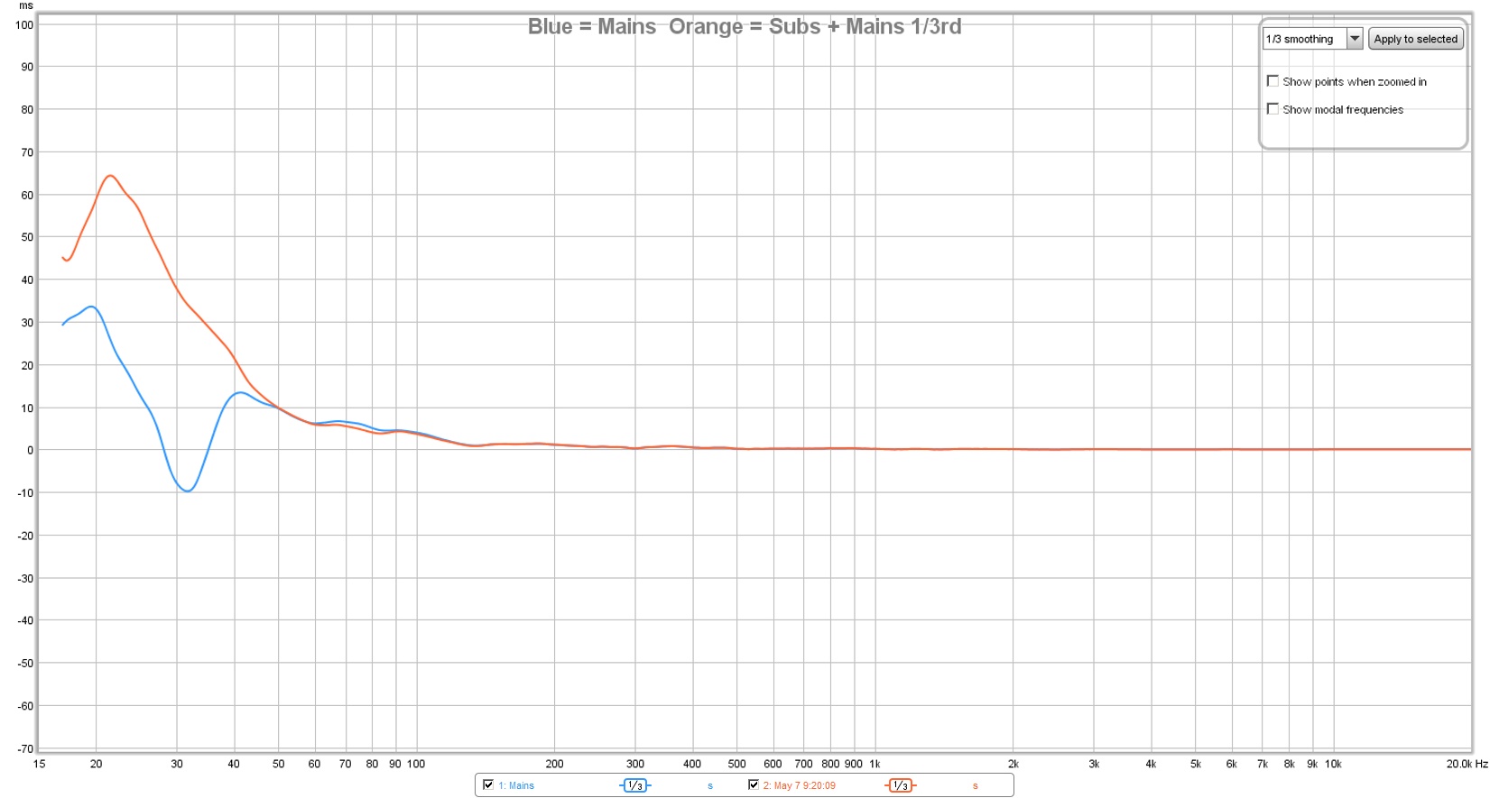

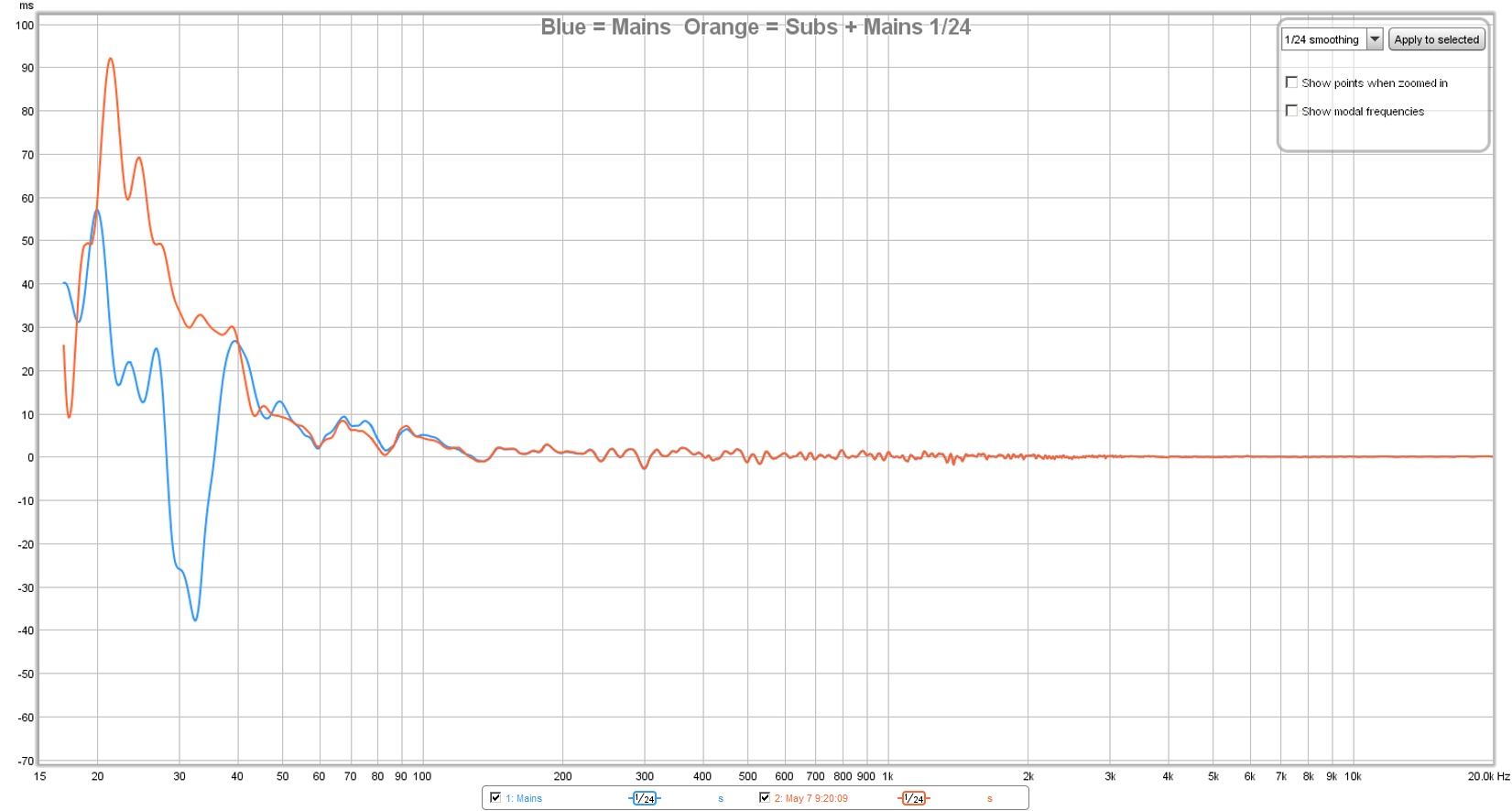

You do realise this was a measurement at the listening position right?
Very different from one half a meter away from a speaker. Seeing as how 3 subs are involved I'd say only time alignment of the subs to the mains could improve that.
But the room will still mess with a group delay measured at the listening position. If you look at a gated measurement, you'd take away some of that effect.
But how big are the chances all subs and mains are currently at exact the same distance from the listening spot? Regardless of their configuration?
Time alignment could improve things, but it isn't as easy to time align subs as it is a tweeter to a mid.
Maybe we should see a graph of only the mains to see what that is doing, as they are ported as well.
I agree that it is a mess with how many speakers are involved which was why the OP wanted to see if there is any low hanging fruit that can be used to reduce the large 20ms GD at 40Hz. Given that there are multi sources and some are ported and some are not, and it is at LP, I would have to say that the data actually looks pretty good. It looks like the OP has done quite a bit of room treatment already otherwise it would truly look much much worse.
