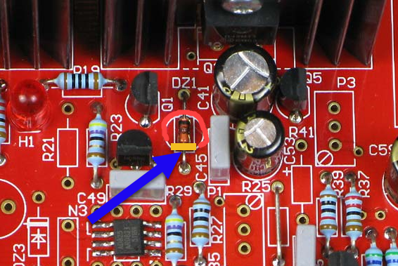

You can test the LED using diode test on your DVM. Make sure the regulator is unpowered. Compare the schematic symbol. See the picture. With diode test you should have a weak light from the LED. The cathode shall be facing down.

The LED's are in the wrong direction. Have you checked closely how they should be mounted? See post 167. Consult also the schematic.

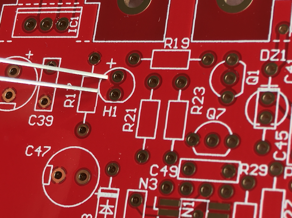

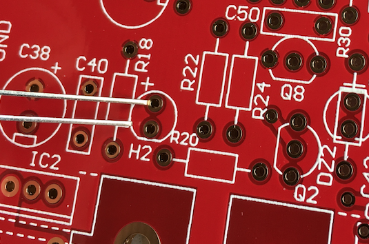

H1+2 and DZ1+2 should show 1.6V, right?
The cathode (straight surface / short pin) at H1 points inwards. The one from DZ1 to the outside, right?
H2 and DZ2 just the oposite, right?
I may have installed the DZx LEDs upside down again. But I still get 1,6V for Hx and 7V for DZx.... ;-(
sorry for being so complicated...
It's very good to be sure when you mount a part, not almost sure. Long pin is "plus" or "anode". Compare the pcb layout and the schematics in order to be really sure. Since the pcb only has two layers you can see exactly how it's designed.
The flat surface of the cathode marking shall be in one direction for all LED's.
Notice that you have already succeeded to get this working and by this managed to mount the H1 and H2 correctly. This 5 V version has the DzX changed to LED's so this is the difference. Take one more look into post 167 and look at the picture.

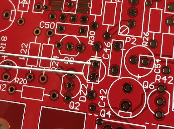

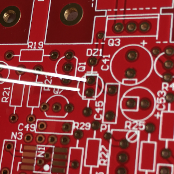

Am I right that the long legs are always on top of the pictures?
If yes it is more than possible that I have them in the wrong direction...
above H1+2 is shown a "+". for me this is the Anode long leg. That I have.
below the text DZ1+2 is horizontal line. For me that is the cathode / short leg. Wrong?
