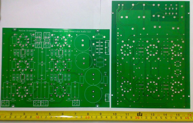

Hello leadbelly,
I have downloaded the file package from Pete Millett's site and also downloaded Eagle CAD 5.4.0 but the file extentions on the Millett files do not seem to be what Eagle is looking for. Can you offer any suggestions so I can open the board files and study the board layout.
Thanks, leadfinger
Thanks, leadfinger
leadfinger said:Can you offer any suggestions so I can open the board files and study the board layout.
No, sorry, I can't, I am very PCB-software-illiterate. Anybody else?
the Millett files do not seem to be what Eagle is looking for. Can you offer any suggestions ...... No, sorry, I can't, I am very PCB-software-illiterate. Anybody else?
I use Eagle for all of my boards. The archive on Milletts page does not contain any Eagle files. The only files present are the Gerber files needed to fab the board. They can be viewed with a Gerber viewer like Viewmate. There is no schematic, board files, or placement diagram.
I've updated the .ZIP file to include the Eagle SCH and BRD files. Very strange, they were present in the web image on my hard drive, but not on the server. Seems that FrontPage doesn't always recognize certain files being updated, so I have to manually delete them from the server and re-publish. I had the same issue with some PDF files.
I also added a primative BOM - basically just what Eagle kicks out. That's all I have. This is a pretty old project...
Pete

initial observations
I could not wait for the PCB so I put together 2 channels of low pass. Some initial observations:
1. The x-over inverts phase
2. The gain is -15db
3. I was shooting for 600Hz LP. With closely matched parts the -3db point is 700Hz. This means the x-over point (-6db)is way off.

Re: initial observations
What tube did you use? I'm guessing that the crossover point would shift with different plate resistances.
audio_builder said:I was shooting for 600Hz LP. With closely matched parts the -3db point is 700Hz. This means the x-over point (-6db)is way off.
1. It's a VCVS based implementation, VCVS don't invert phase, (in band that is) however they do have some delay.
2. Something wrong here, as gain in band should be relatively close to unity figuring each stage has a gain of >0.9 inside the passband. I would expect something like -1dB to -1.5dB in band.
3. Gains of much less than expected will affect the transfer function of the filter and the X-O point will not be in the expected place nor of the expected magnitude.
I have built very similar X-O in the past and once you compensate for the fact that less than unity gain is available in the filter blocks you can get very reasonable approximations of any moderate Q transfer functions that can be realized at near unity gain.
What supply voltages are you using, and what is the load impedance you are driving? What are the values of the caps and resistors used in your filter, and are the resulting filter network impedances relatively high compared to the source impedance of the stages driving them?

Just a question, On the schematic it shows 1w resistors, on the BOM its a little less clear
"R2 11K 1W R5W_MILLS R5W_MILLS RESISTOR, 5W WIREWOUND, MILLS"
I have the 1w's, just want to make sure......
